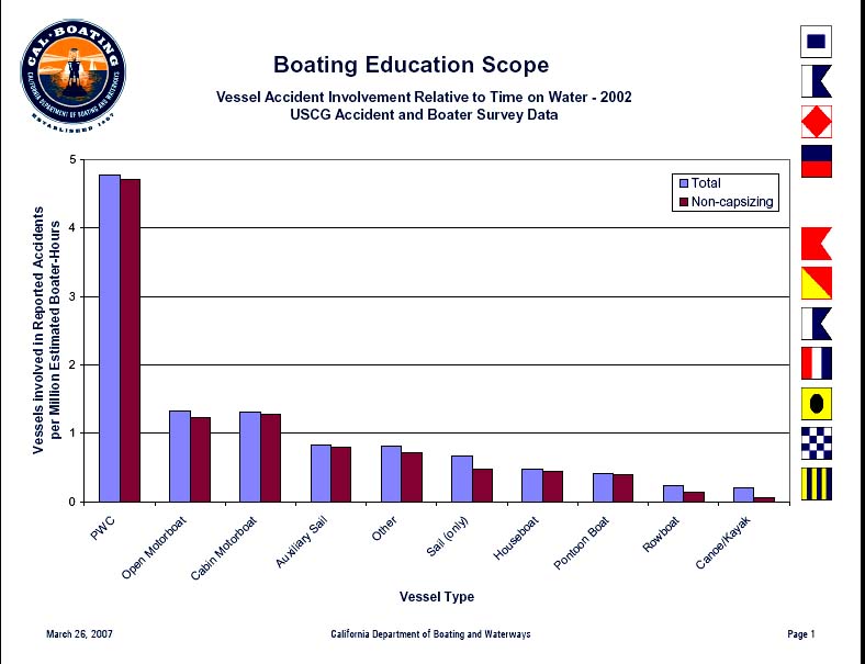

    Jet skis are involved in many more accidents per hour than other boats - think of how they're used -- no surprise. Tens of thousands of fatalities is an exaggeration though.
    Example US stats:
  10. jimburden

    I apologize for the over statement.
    The avaialble figures are not complete anywhere I looked after I made the foolish statement. In Nebraska alone this was the main cause of boating accidents and there were fatalities. My wife worked for the Nebraska Game and Parks commission for 23 years and we heard about the problem frequently. Exposure to the elements from taking off without cold weather wet or survival suits use to be a big problem according to a national magazine article I read a decade or more ago. For reasons not known to me the statistics under state deaths. I am still interested in fully enclosed all weather boats of all kinds and am curious how safety in boats would be improved with unsinkable self righting floatation. Cabin enclosures that can be opened for activities but closed for foul weather and going distances at high speed. Imagine motor cycles without helmets, cars without seat belts, open cockpit aircraft, no roll cages on race cars. Should not fast boats have some precasions? I know this is for another forum or thread.
