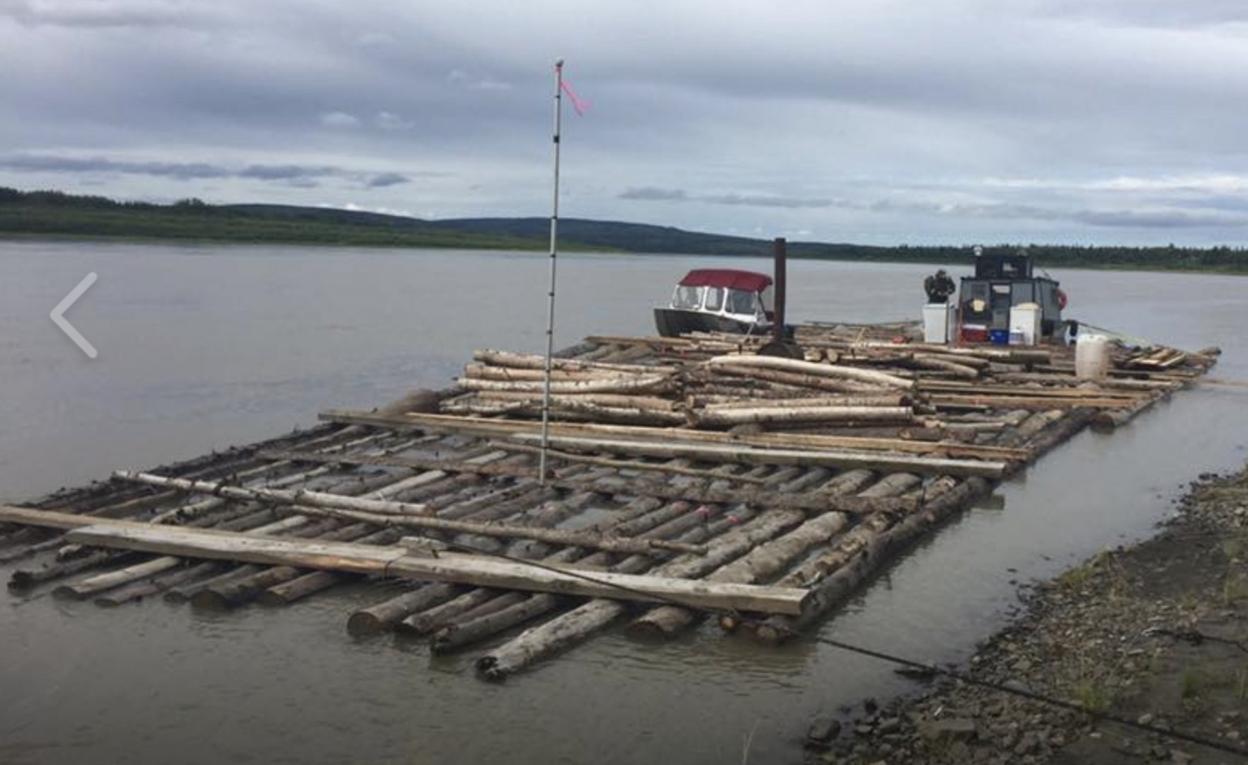

    This is the kind of setup Ive seen here a couple of times. I would want to cover the deck so its flat so its easy to walk on. So rather than just a few cross members I'd make them solid front to back. I could pay locals to provide rough cut slabs from the lumber mill. Cheaper than 2x12s from Lowes. Its pushed by one of the larger boats with larger engines.
    Yes I could get the locals to help but I wouldn't ask them to do it for free. I'm the city manager so I could hire the work team and have them build it using city funds. Or I can build it with my money and rent it to the city or tribe or residents. Pros and Cons to both options. Some are, if its mine I can park it in front of my house and put my lawn chairs on it and use it whenever I want. A perk being I can have additional income renting it out. I'd be willing to spend $5000 to have that. There are a dozen more pros and cons.
    Someone mentioned protecting it. Are they talking about Thompsons Water Seal or what?

    If you can haul lumber from Lowes, you can haul steel to the location too. I assume you have a generator, so a welder can be used anywhere. The SOR will define you needs. You are starting with constraints instead, which limits your possibilities. Building a barge with Lowes lumber and plastic barrels is a recipe for disaster. They work fine as floating docks or swim platforms, but will not withstand rough service. A steel barge is simply a box, which any mid-level welder build.

    But don't get burned out either. I have no doubt you can get there for 5000 bux, if you do a ton of work yourself.
    Gather a heap of good logs.
    Get a design worked out, that capitalizes the free wood advantage. We can help, grumping is a free part of the service.
    Arrange for the sawmill. Get a mountain of cut lumber.
    Your 5000 is for the sawmill, and glue, screws, and the like.
    And build it yourself evenings and weekends.

    I am thinking 3 mm / 1/8" plate for the rectangular box shaped hull (you could add some rake on the bow and stern) and some bulkheads, maybe 4 mm / 3/16" for the deck (a bit heavier re the weight of the vehicle), and a load of 4" x 2" x 1/8" angle bar for framing?
