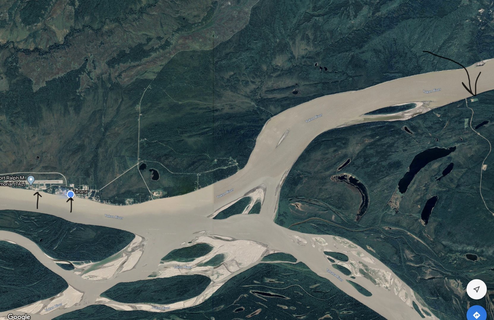

    I live in Tanana. The road is 6 miles upstream. There are houses along the bank but on the other side of the road. Not stringing extension cords across the street so no to shore power.
  13. BlueBell
    Joined: May 2017
    Posts: 3,413
    Likes: 1,299, Points: 113
    Location: Victoria BC Canada
    You've got no shore power.
    I guess then you have solar drills or gas drills, or no drills?
    I was thinking how you could fasten the logs together...
    Chainsaw flats on the log ends to join them with a single through hole...
    Having a hard time finding where you live on Google Earth.
    Are you by the airport or six miles upstream, no downstream...

    Google Maps Tanana AK.
    My house is blue dot. The Barge Landing where I would park it in the winter is to the left (west) and the end of the road / parking lot is to the east 6 miles.
    Ive got generators and the city has its own power grid but no power down at the barge landing.
