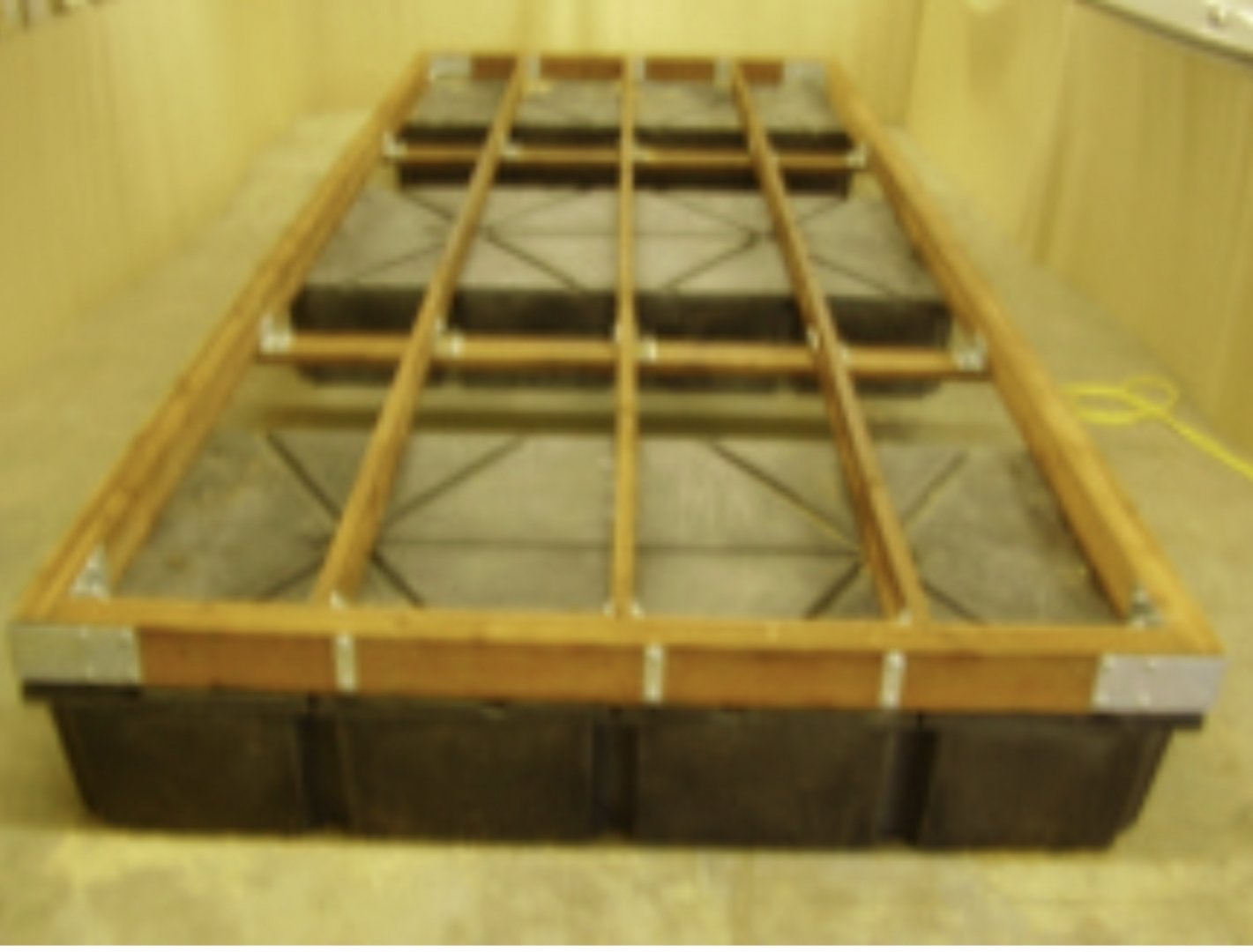

    I love the idea of building something more elaborate, and probably will some day, but at this point I need something that I can build in a day or so. Attached is the pic from http://www.scottcomarine.com/kits/instructions.pdf and this seems to fit the bill. I was shocked to find that Home Depot in Fairbanks AK sells everything required, including the floats. I love this because when not in use I have a dock in front of my house. They even sell floats with wheels integrated into the design so all you have to do is pull it onto shore. So my final task is design, dimensions and float sizes to carry a 8x18 vehicle. I mentioned big waves but for a load like that I'd wait until calm "seas". So how wide, long and how big of timbers and decking?

    14' wide, and 24' long. Decking is light, except where tires roll. Then a built up assembly. They were 2" thick on bailey bridges when I was building those, but the bailey transoms were fairly closely spaced. I'd say 2" true thickness, wide enough you can easily stay on them, then convenient plywood elsewhere. Make sure the manufacturer lists that as an acceptable application. I'm still concerned about the flotation around the edges supporting heavy point loads in the middle. Don't want it to break in half and dump your truck.

    I need help with how wide, how long and how deep should the 4'x8' floats be (12" 16" 24"). How many floats? If the concern is stability loading, offloading and while on the water, should I go with 12" floats under the entire structure or deeper ones in catamaran style or all the way around? Which design is easier to push the 6 miles up the Yukon against 5 to 8 mph current? It will pretty much always be unloaded going upstream, loaded floating back to the village. How much resistance will there be with the square floats? Would it be worth the considerable cost and time to build a false hull just to make it slip through the water more easily or could I just do a curved bow upfront to break the water?

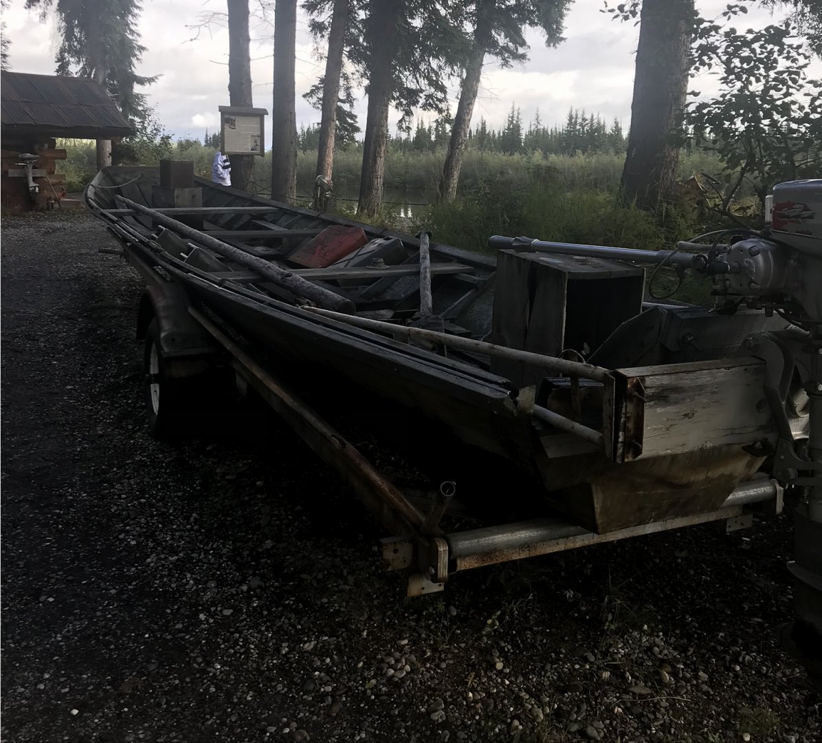

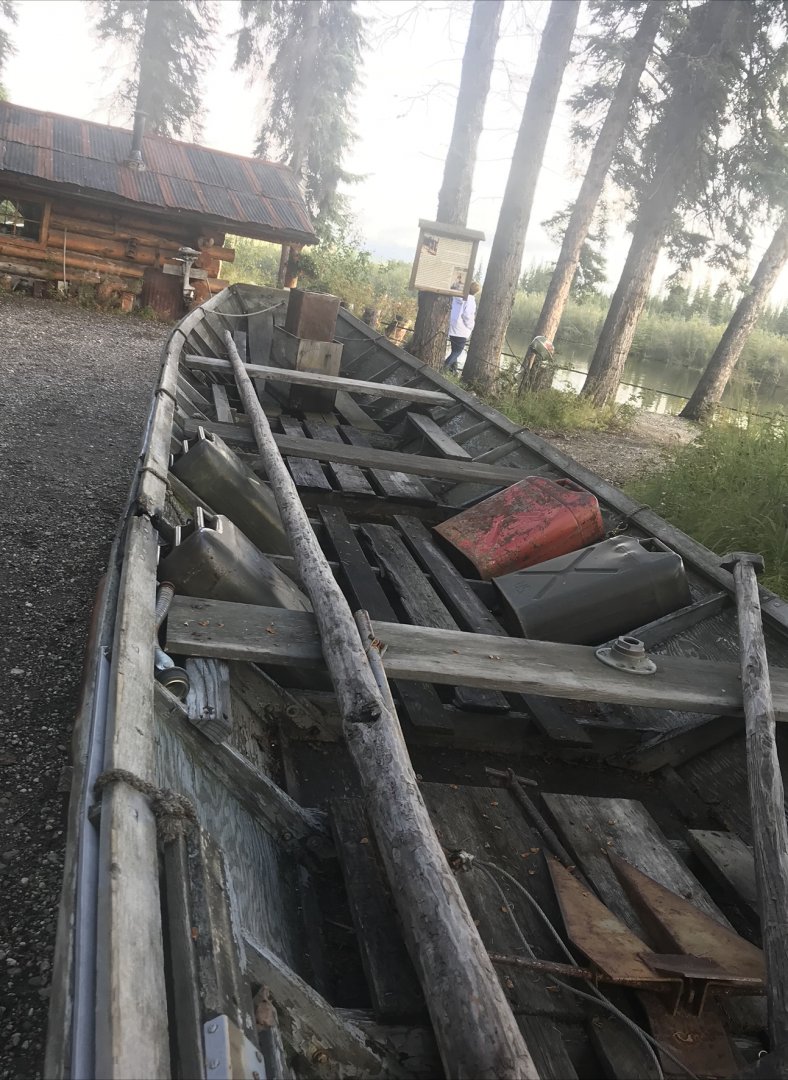

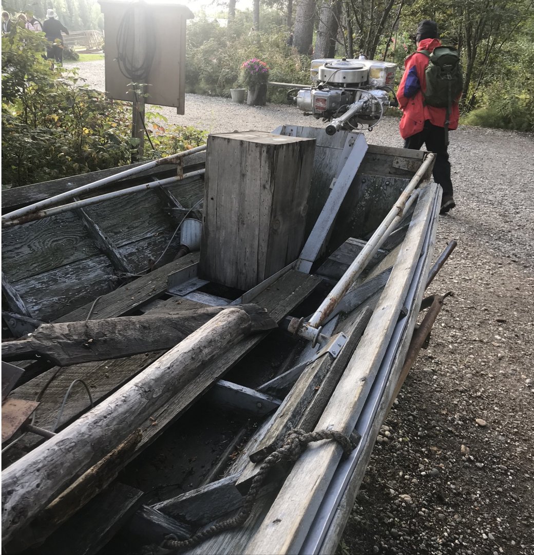

    These plywood boats are in two museums in Fairbanks and there's a great example here in the village. I'd love to build one and these could carry heavy loads, but not vehicles. I keep hearing about fiberglass and epoxy but these don't have that.

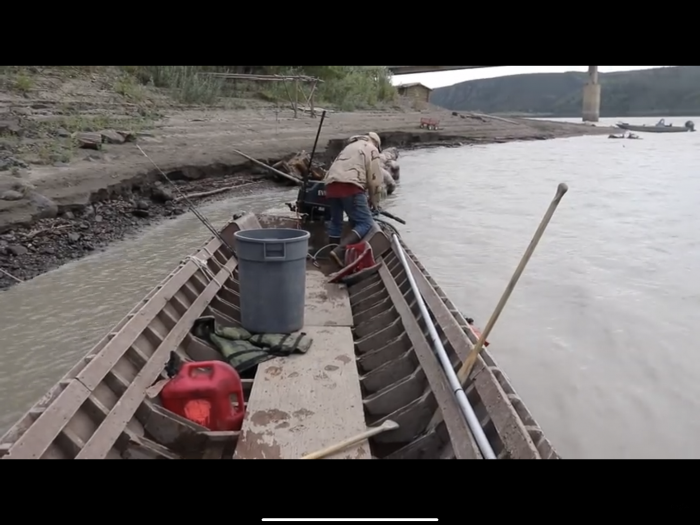

    Here's more.
