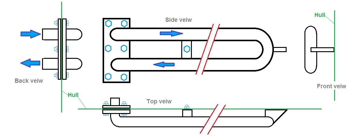

    Hi all, long time Lurker and researcher, I would like some advice on a Keel cooling set up. I am not interested in debating the pro’s and cons of Keel cooling/Dry exhaust for a number of reasons, I am going that way.
    I own a 20 year old John Pugh 40 ft Steel Ketch, she is 6 mm steel plate below the waterline and 4 mm above, hard chined, ¾ keel with a skeg hung rudder. 12 tonne with a 6 ft draft. She presently has a 1964 Fordson Major marinised engine, the present keel cooling is box channel (see photo) welded to the keel giving a surface area of 0.95 sqr mtrs of cooling. The Fordson is being replaced with a Nanni (Kubota 50 hp) again set up for keel cooling and the factory recommends (@ maximum 2800 rpm) 1.84 sqr mtrs of surface for cooling at > 18 deg C water temp. We plan on spending most of our time in the tropics so water temp could be as high as 28 deg C.
    So the plan is to do a 12 month refit on the dry. I plan to remove the old engine and engine bed and refit the Nanni, remove the box cooling and replace it with 32 mm ID black water pipe 3.2mm wall thickness fully welded and pressure tested (see drawing) either bolted or welded to the hull each side will have 2 x 3.5 mtr run giving a surface cooling area of 1.9 sqr mtrs. It will hold 16 ltrs of coolant total, Yes I know there will be a greater wetted surface but we are talking about a 7 knot live aboard cruiser I don’t think the drag will make a large difference. I have also replaced the 20 inch fixed bladed Prop with a 20inch 3 bladed Flex-o-Fold. The keel cooler will be mounted just below where the Hull meets the Keel along the Keel about 1 mtr (3 ft) below the water line.
    If I make it out of 75mm x 25mm box welded along the 75mm side to the hull in the same configuration it will give the same cooling surface area but hold 38 ltrs of coolant.
    So the advice needed is:
    1. Can any one see any major floors with this set up?
    2. I am also thinking of getting the new keel cooler Galvanised (hot dipped), is that a benefit, as it will need to be painted with anti foul any way?
    3. I am also thinking of fitting down the centre of each tube, a 2 mm flat steel twisted along its length to swirl the coolant to get maximum contact with the cooling surface?
    Any feedback appreciated.
    Cheers
    Cal

    looks ok.
    im not a fan of keel cooling for main engine.
    keel cooled refrigeration in very desirable. put it on your job list
    remember main engine battery charging in hot water harbors....bigger is better

    Concur Michael. Might thou better to check up the cooling area before going further..

    The system as proposed would not be that difficult to test for heat transfer before installation.
    The internal tube mixing devices are called turbulators, and they do work. Your test could include before and after use of the turbulators.

    The galvanizing would turn the cooler in to a large area anode and would be consumed relatively fast leaving unprotected steel? It is also unpleasant to weld.

    Teddy the 32mm pipe has an OD of 42.2mm which is a circumference of 132.6mm and 2 x 3.5 mtr lengths each side of the hull gives a total cooling area of 1.94 sqr mtrs? Unless I have missed something?
    Kevin I thought about the angled flat plate and I would only have around 4.6 mtrs of hull/keel intersection to play with (due to engine position fuel tank etc) and at 200mm I would need 4.8 mtr of area, I also have to consider changing the coolant every 2 years and how I drain the system? I think my 5 large anodes would create just as much drag as a 42.2mm diameter pipe? Thoughts?
    Thanks Mark for your work boat system and I will be using a polypropylene glycol mix.
    Nick your right Doh! So I won't be galvanising anything :) just sandblasting and an epoxy paint finish,

    Cal, that keel cooling setup as drawn is going to be an antifouling nightmare trying to clean behind it. I really wouldn't do it, and I speak as the poor ******* who used to have to dive on my father in law's hull and try to scrape his clean.
    I'd go for welded channel myself & increase the surface area as required.

    The drawing shown is not very efficient (parallel is better), will be a maintenance nightmare, and create unnecessary drag.

    I've designed several keel cooling systems I've put several on the inside. Simply welding a tank with baffles integral within one side of the keel. Some between frames. The classic was simply channel or angle welded to the inside.
    You will get a fair amount of drag from that setup, a sailboat wants as little drag as possible and external heat exchangers are a bit brutal in that regard.
