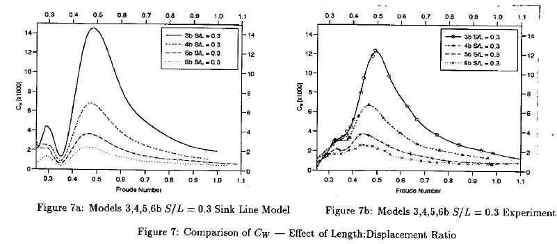

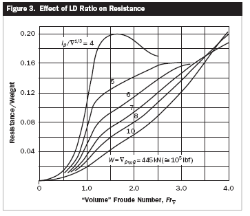

    1. Hull shape optimization for reduced resistance in displacement mode;
    For a sailboat, the main issue is the heeled hull drag versus the righting moment it provides : here the hull shape is of first importance, all other parameters being equal. And there is less published information on this issue, it lacks a compilation of the cumulative tests data and best advices on this. For example like the one of Jacques Fauroux, I quote : »When the boat heels, the centers of the area sections must form a spine that does not invert."
    For a sailing dinghy, the main issue is different : it is to deal with both the displacement and the planing modes, because the wind force and/or the wind angle and/or the weight and the hiking posture of the crew. Here again, the hull shape is of first importance. The main guideline in my opinion is : the more the planing mode is developing, the less the curvature (in the longitudinal view) of the hull shape remaining in contact with the water.
    2. Application of the fluid compression and particle deflection theory for hull design.
    CFD simulations are great, top naval architects use them but I think more to confirm and fine tune their design options than to discover new ones
    3. CAD techniques for creating parametric hull designs and linking them with CFD simulations.
    Parametric approach for hull designs, when it is discoupling of the geometrical input data and the adimensional parameters typical of a hull shape, can be powerful to go fast and safe in a new project.

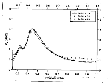

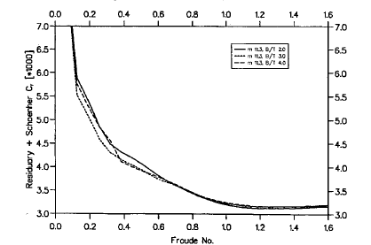

    Residual resistance in Displacement mode (Fn < 0.40) is a corner of a small corner.
    In this case, Total Drag (A16) is 845 Newtons
    Residual resistance (A23) is 81 Newtons ca. 10% Total Drag
    By completely destroying the design, we could perhaps, with a lot of luck, reduce it 10%, which would be 1% of the total. A narrow, dead-end street. And the Drive force (A15) would fall
