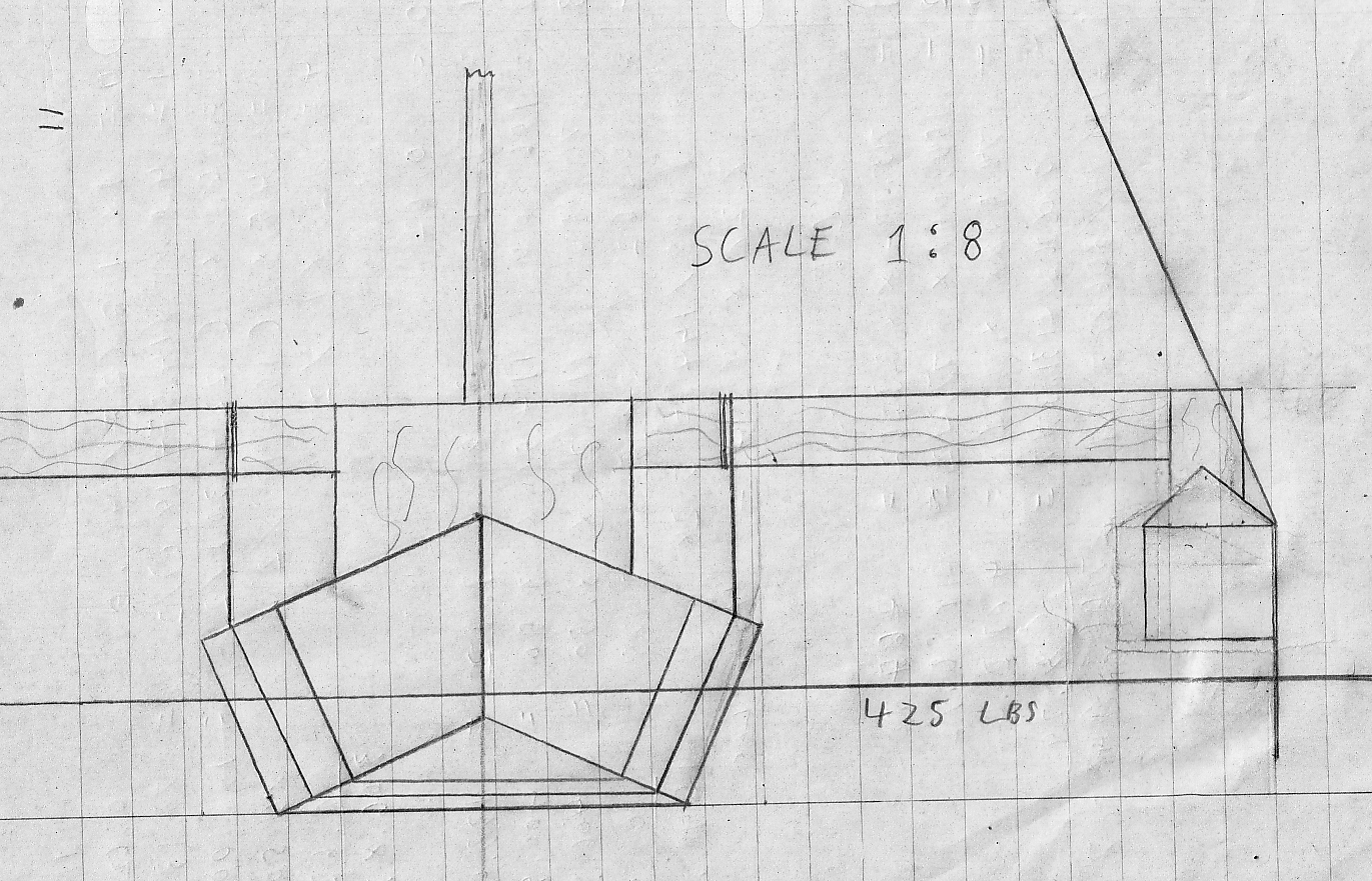

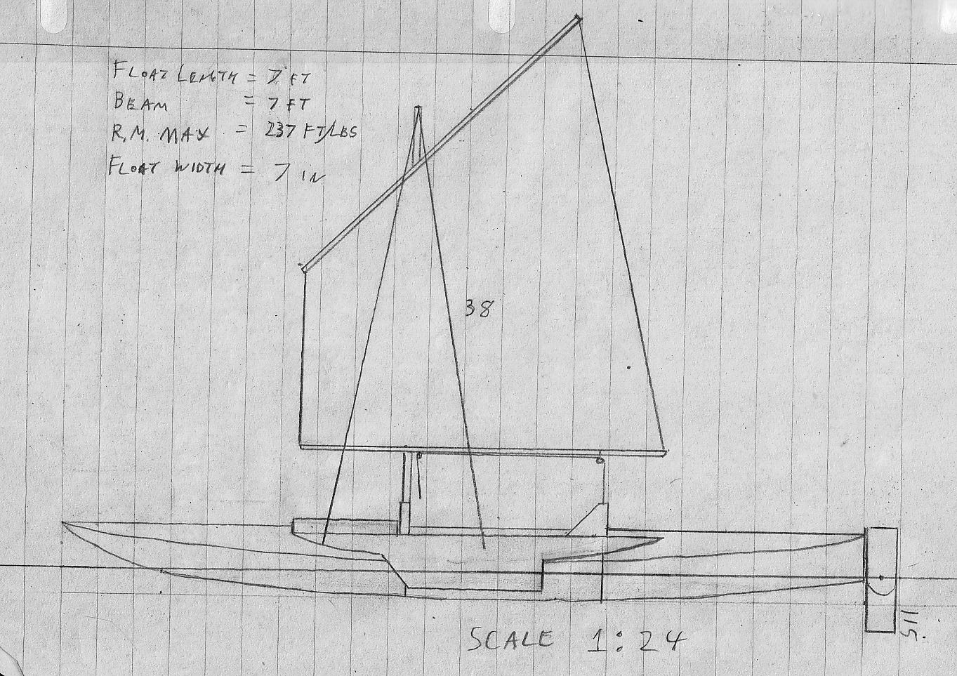

    This seems to be a perennial problem in boat design.
    A few years ago, I came up with my own solution (see illustrations below).
    I realized that a double outrigger is nothing more than a small catamaran which pulls it's floating ballast (the vaka or main hull) through the water.
    The system I sketched is a complete catamaran minus the rudder. It straps onto the main hull, and the rudder is added to the stern of the main hull. The long, shallow keels, although less efficient than deeper boards, do not extend below the main hull. Another advantage they have is that they have an effective angle of attack which is very similar to that of the sides of the floats they are attached to. So when the leeward float starts to immerse, its side adds lateral plane.
    This rig would never point like a Laser(r), but I believe it will have adequate windward perfomance.
    The floats can be made of slabs of foam glued a plywood side/keel piece. triyak.png Triyak2.png

    good points, I'm now re-thinking the use of center board connected through the mast because I realize what I really want to do is use this in shallow and weedy waters, and it would be 2/3 paddler 1/3 sailor. So shallow keels on the outriggers sounds reasonable. Might go with 6" dia pool noodles, up-turned at ends, with PVC pipe core, and 1/8" plywood keel embedded into the pipe and through the noodle.
