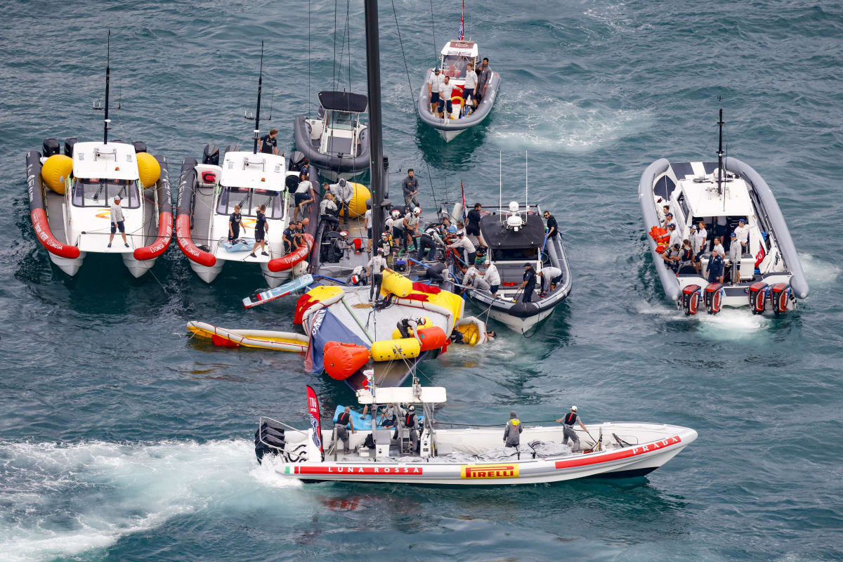

    For those who missed it, here is American Magic's capsize:
    There were a number of things going on:
    1. Significant increase in wind just before they tacked
    2. After the tack they went straight into a bearaway, a very tough manoeuvre at the best of times in a foiler
    3. A mainsail batten got hooked on a backstay (that should have been loosened after the tack) during the bearaway so the main didn't ease as it should
    Forces during the capsize caused a large hole forward of the port foil into the required sealed buoyancy area, almost causing the boat to sink (I'll put credits on the images if I can find them).
    AM will not compete further in the round robins and hopes to have the boat ready for the finals starting on 29 January.
    INEOS and Luna Rossa will sail against against each other on Saturday and Sunday (two races total) to decide who goes directly into the final. If INEOS wins either race, they go directly to the final. If LR wins both, they go into the final. The other boat sails a semi final against AM to determine the second finalist (first to 4 wins).
    The final starts on 13 Feb, first to 7 wins wins the Prada Cup and becomes the challenger.

    Likely not connected, but you never know: a couple of the AC videos use footage which shows a relatively large piece of debris in the water shortly after the capsize:

    Might that have been the bit that was retrieved by a rescue boat? Its been posted online that the hull now has no hole in it,presumably the other repairs and replacements are proceeding equally rapidly.

    The capsize was certainly caused by a strong gust while they were bearing away after the tack and were not able to release the main-sheet, yes. But when the heeling angle increases fast during the capsize, the boat rotates around an axis from the leeward-foil to the rudder-foil, which results in the high nose-up attitude, because this axis is at some 30° to 40° to the hull's centre-line. I estimate that the bow is some 10 m above the water before it starts falling down. When you drop the boat from that height you can get very high slamming loads, and as I understand from Terry Hutchinson's press-conference, they built the boat to stand hitting the water in an up-right position, not during a capsize.
    A hydrofoil-configuration based on a multihull, like e.g. William Sunnuck's Vampire, with the rudder-foils more straight behind the main-foils would behave better during this kind of capsize. Narrow catamaran hulls are also easier to build strong enough for slamming loads at a low weight than the wide AC-75 hull.
