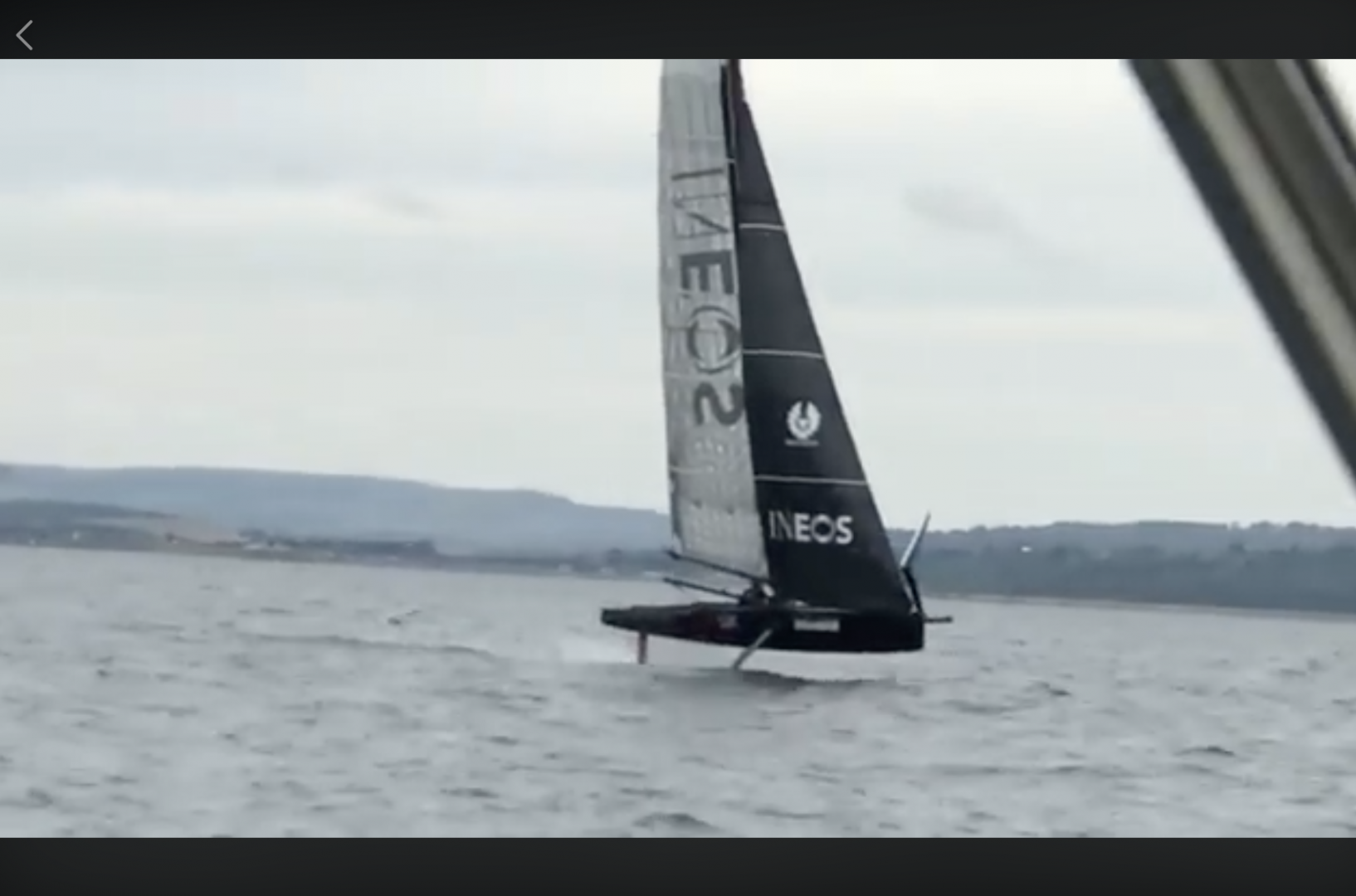

    Good work by the INEOS team! Obviously, they made the configuration fly. But by some reason they need floats on the sides. Probably the stability from foil-weight and the main hull is not enough below some speed. They also have deck-spreaders, making the overall-beam more like a trimaran. It is getting closer the unballasted foiler, I suggested as an example in my post 285 before the AC-75 class-rule was published.
    The experimental work, that INEOS is doing now, should have been done before the class-rule was decided! And the AC-organizers should also have taken (or let someone take) the logical next steps in the experimental work, i.e. trying a model of the configuration intended for the AC-75 without any extra floats or similar, before deciding such a strict class-rule as the present AC-75 rule.

    The floats are necessary in the test model because they can't get enough ballast in the foils due to scaling. There were changes in the latest rules indicating that even the full sized boats will struggle to get enough ballast in the foils and that the arms are going to be heavier than first thought. Nothing that can't be overcome, but issues that mean this design may not scale well when applied to smaller boats.
    The fact that INEOS has the boat foiling already is proof that confidence in the design was not misplaced. I admit to being as sceptical as anyone initially, and still think it's not a sensible design if "trickle down" is expected, but the fact that the INEOS boat is foiling already and looks close to pulling off foiling gybes is proof that the designers got it very close to spot on.
    I expect that the main purpose of the test boat is to benchmark computer models with real world data and work out how best to sail them, likely they're entirely computer controlled with minimal human input (there appears to be only 2 crew on the boat). The AC75s will have "follow the ball" style graphics to indicate optimum settings for sail trim and anything else human controlled.

    That's true and all the more reason NZAC should have a fin keel like the Quant 23 and Gonet monofoiler. Would still foil and be very fast..... and the foils wouldn't have to be left in the full down position-in fact the full down position would never be needed and could result in much simpler mechanics.

    It's definitely feasible especially since INEOS got the 28' version going so well. But the whole concept would be improved with a fin keel/bulb or canting keel.

    Or why not keep the floats that INEOS used in their initial tests? I agree with Doug, that replacing the ballasted 120° stroke-angle foils with unballasted ones, that also require less stroke-angle, will make life much easier. The boats will still be expensive enough and challenging enough to sail anyway.
    About scaling: don't expect it will be easier to balance the rig weight with the foils, when you scale up from 28" to 75". Both rig-weight and foil-weight will scale with L^3, while e.g. cross-sections in spars scale with L^2, so the stresses in the material scale with L. Hence, Young's modulus as well as tensile-strength shall scale with L, or if you already are using the best materials in the 28" size, you have to make the rig relatively heavier on the 75" version. (the cube-square law).

    The floats seem to only be required when the INEOS boat isn't being actively sailed. It doesn't accurately model the full sized AC75 in many respects, including articulation of the foils which don't seem to go into the fully down position.
    The hull and rig don't appear to be scaled AC75 versions either, likely they're just "close enough" for the exercise (and perhaps at the right price as well). There is talk that the NYYC is using an MC38 as their surrogate hull, which should launch soon. It's probably a significant cost saving over building an accurate (roughly half size) model.
