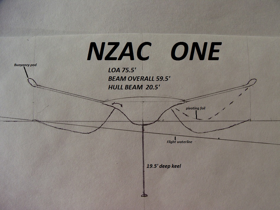

    NZAC* is going to ,apparently, have a lot of one design elements not including the foils but maybe including the struts that support them, not including the hull but parts of the rig not including sails. So it seems to me any real innovation will be left ,primarily to the foils ,sails and hull design-which only has value when not foiling. With foiling beginning somewhere between a windspeed of 6 and 9 knots and a "legal" top end windspeed around 25knots the hull may not be in the water much. The main "edge" possible from a great hull design will be a shape that allows quick acceleration I would guess.
    * a possible New Zealand Americas Cup boat
    Seems like a very skinny hull(at the waterline) like NZAC One(except maybe with chines and a rectangular /square section) may be the way to go depending on how quickly the foil struts can move?
    A lesson from the Moth is that a high L/B skinny rectangular hull section beat a semi-circular low wetted surface hull. In other words the reduction in wavemaking drag with the skinny rectangular section was less drag than a semi-circular section even with a bit more wetted surface.

    NZAC One has a deep keel with a bulb providing stability before foiling. AC75 would have very poor stability with a very skinny hull. I don't think it is possible to reach foiling speed without some form stability.

    NZAC One was there just to illustrate the narrow waterline-nothing else. The degree of form stability will have to be determined as time goes by but I would bet that a very narrow hull would be considered. The boat doesn't need form stability from the hull once its moving so I wouldn't be surprised if they push it toward the minimum. The lee foil will add stability when the boat starts moving -even relatively slowly. The ability to get on foils first may depend on the choice made for waterline beam.
    Also, I may have missed whether or not racks on the hull for the crew will be legal or not?

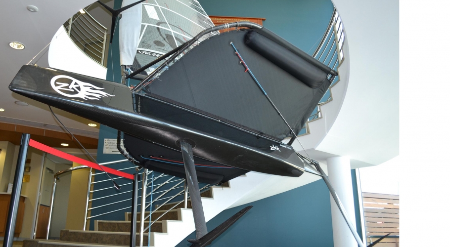

    My comments were based on an article that I think was written by Ian Ward and a comarison of midship hull sections of the same area one semi-circular* and one square or rectangular. The L/B ratio of the semi-circular version was something like 9.7/1 and the square/ rectangular version was something like 11/1. I also have a drawing that illustrates this but can't find it or the article. There are infinite variations but the point was that a square or rectangular section was narrower for the same displacement as was a semicircular shape and that narrower was faster despite around 11.5% more wetted surface.
    At any rate, I think at least some of the hulls will be skinnier than any renders so far except NZAC One.
    * not rounded chines
    Andrew McDougall photo of Mach II:

    So all you can say is that in a comparison between two unknown hulls using some unknown methodology, a skinnier square hull was faster in unknown conditions than a wider, round section hull. Without knowing exactly what was being compared and how, it's a very long bow to draw to extrapolate from a 3.35 m boat weighing 35 kg to a 23 m boat weighing around 7,000 kg.
    For Moths, if you go by results in regattas (which is what actually matters), there is no perceptible difference between square and round hulls. A far greater influence is the rig, foils and sailor.
    The Mach 2 image shows that the forward third (at least) is round, similar to the forward sections of all modern skiffs, so the distinction between "round" and "square" sections is pretty meaningless. I expect the AC75s will have round forward sections, flattening toward the rear with possibly a hard chine above the waterline (because it looks modern, but isn't) so they might look a lot more like Wild Oat XI than Hugo Boss.
