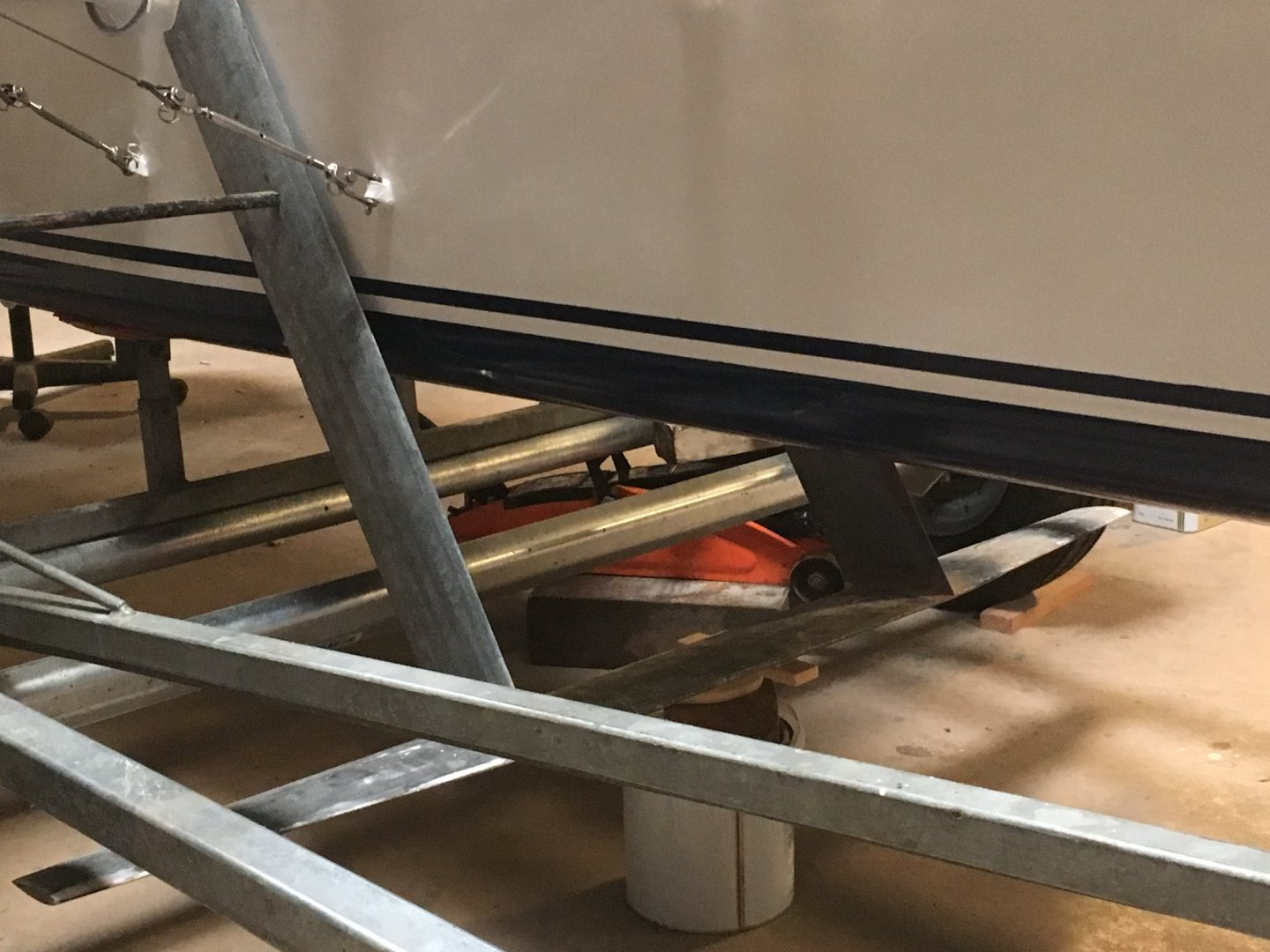

More modifications on the original design, I’ve gone down to one tiller extension from 2 like on a skiff and moved the sheeting point forward on the boom. I’ve pretty much finished my front lifting foil and just need to fit a vernier adjuster to it and some tip winglets to reduce tip losses. I’m quite excited about the lifting foil as it means I can dial in lift from the rudder foil and balance it all on the front foil which is adjustable from -2 to +8 degrees AOI.
From the last test sail I should be able to drive the boat much harder off wind and across the wind, accelerating instead of balking as a gust hits. What is also great about this test platform idea is the full flight surface piercing foil mounts in the same way as the foil I’ve just built, so I can change over foils in minutes.

I can use a general setting on the main foil using vernier holes and fast pins and vary the altitude on the rudder by adopting a bow down or up attitude, but don’t get too carried away with the front foil it’s there for positive lift not for full foiling. I’m testing stuff Doug and having fun, I can understand a great deal by using this method. The next foil I’m going to make is full flight surface piercing but I probably won’t get a chance to try it myself because I want to sell her. I have some big work commitments that mean I can’t afford the time and energy to keep playing. So if anyone wants her she’s up for sale.
