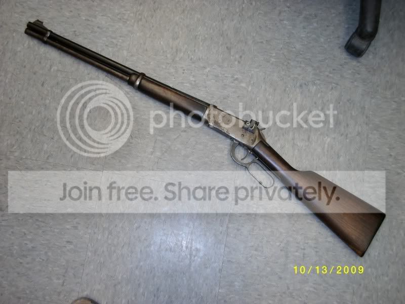

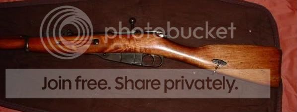

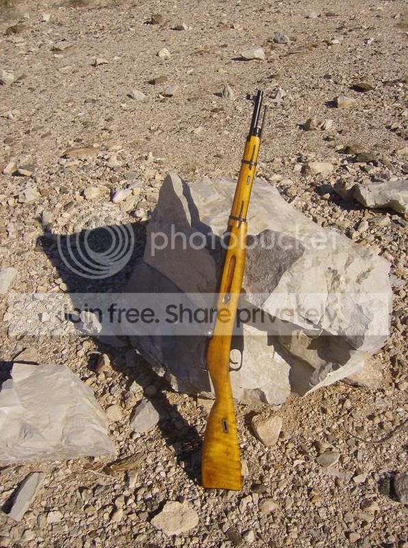

    I enjoy planing wood sometimes: feeling the blade bite in and start cutting, watching the shavings curl, smelling the fresh wood.... I've never really been able to get into sanding, though. It's just a necessary evil to me.
    Except on my rifle stocks. I sand and steel wool and rub those for hours between coats of shellac, tung oil or a mix of linseed oil, beeswax and turpentine, until they feel smooth and soft as a baby's bottom--rather than cold, slick and hard, like a glossy polyurethane varnish. A nice piece of walnut or arctic birch can feel almost cushiony under your fingers with an oil finish, and look like it's semitransparent and you're staring right into the center of it.
    This one isn't quite as gorgeous. But considering it spent several years lost and half-buried outside before it was found again and I bought it, and keeping in mind the wood was sun-bleached, fuzzy and cracked, I'm not complaining about the end results. Especially since it shoots better than most new ones...
    Sorry; I plead guilty to charges of thread highjacking....:D
