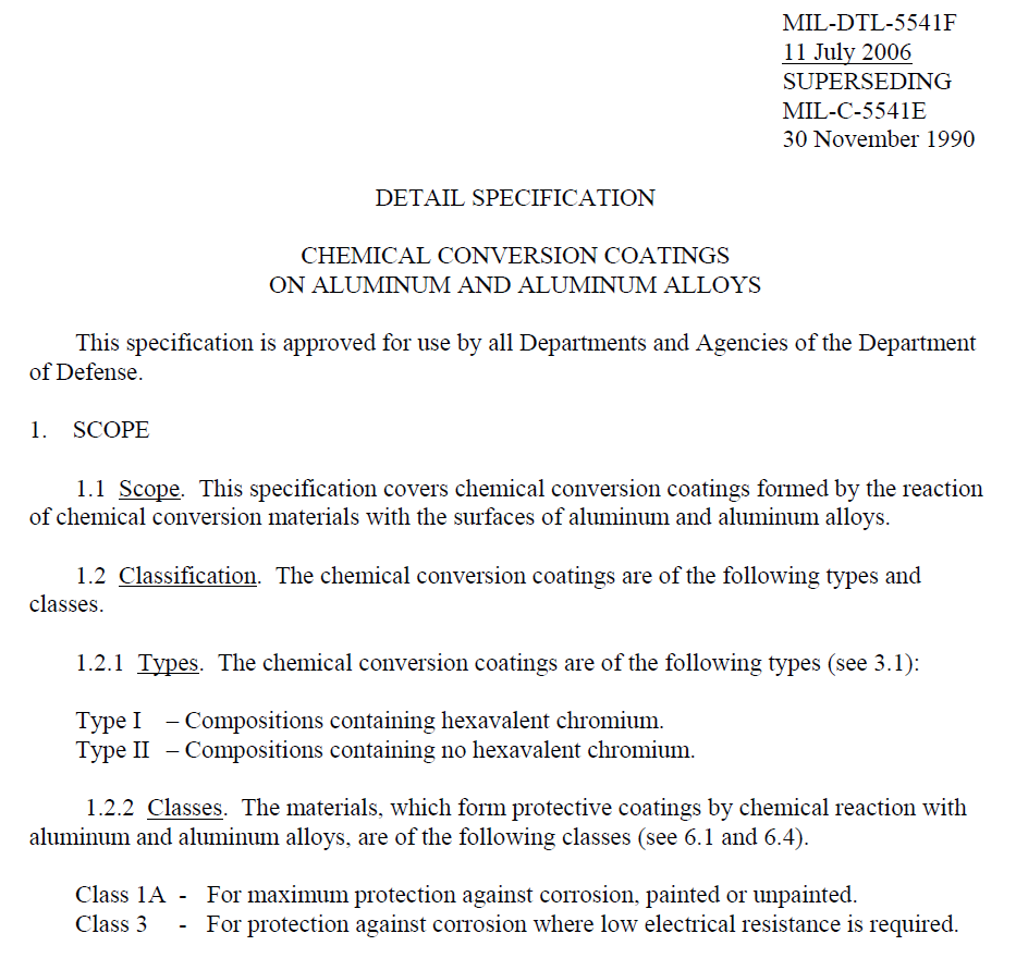

    Another thing to point out. the OP said it was stainless steel, but that may well not be the case. It very well could be chromium on top of aluminum. They may have used hexavalent chromium coating on a high strength aluminum - I don't know if that combination was used in landing gear and I don't know how that resists marine growth, but hexavalent chromium is not friendly to biological organisms... Just a thought...

    Considering the age it would be hexavalent chromium in the solution to plate any parts. The only difference with trivalent chromium is the color consistency of the finish. Chroming aluminum, even if possible, would not be part of a landing gear. Seems like you are using polysyllabic words to try to make an impression. In fact chromed finishes are very environmentally friendly since they don't easily corrode or dissolve.

    I can quote some parts I guess, but i'm not sure how much is permitted by copyright laws. Here's what is says about class 1 chromium coatings:
    8.4.3 Class 1 Chromium Plating
    8.4.3.1 The function of the under layer of nickel for Class 1 plating is to provide a pore free continuous underplate for
    the chromium outer layer. Generally, the thicker the nickel layer, the better the corrosion resistance. The system
    of an outer layer of chromium over the combined plated nickel and copper are generally used in a combined
    total thickness of 0.0001 to 0.002 inches (2.5 to 51 m) depending upon service conditions and the basis metal.
    Here's what it says about class 2 coatings:
    8.4.4 Class 2 Chromium Plating
    8.4.4.1 Class 2 plating, also known as “engineering chromium”, “industrial chromium”, or “hard chromium” is typically
    used for wear resistance, abrasion resistance, improved frictional properties (lower), and such incidental
    corrosion barrier protection of parts as the specified thickness of the plating may afford. Class 2 plating is
    usually applied directly to the basis metal and is finished by grinding to the specified dimensions. It lacks the
    brightness of Class 1 plating. Additional corrosion resistance can be obtained by use of an undercoat of
    electrodeposited nickel in thickness of 0.001 to 0.002 inch (25 to 51 m) on ferrous parts, the minimum
    thickness to be determined by service conditions. Heavy deposits of the Class 2 plating have been used for
    buildup of worn or undersized parts, or for salvage purposes, and to provide protection against corrosive
    chemical environments. Final grinding of the chromium plating can increase the incidence of cracking in the
    deposit. For greater corrosion resistance, based upon equal thickness, unground deposits should be selected
    rather than ground deposits. See 8.4.4.4. A reduction in fatigue life of chromium plated parts can be expected
    and is attributed to the physical and adhesion characteristics of the chromium plate and its state of stress.
    Plating bath temperature and embrittlement relief (baking) temperature have been found to affect the fatigue
    performance of Class 2 plating.
    So there are substantive differences in chromium coatings, and I'm only citing one specific chromium coating specification. there are numerous, and I don't know what they would have been using at the time this particular landing gear was made.
