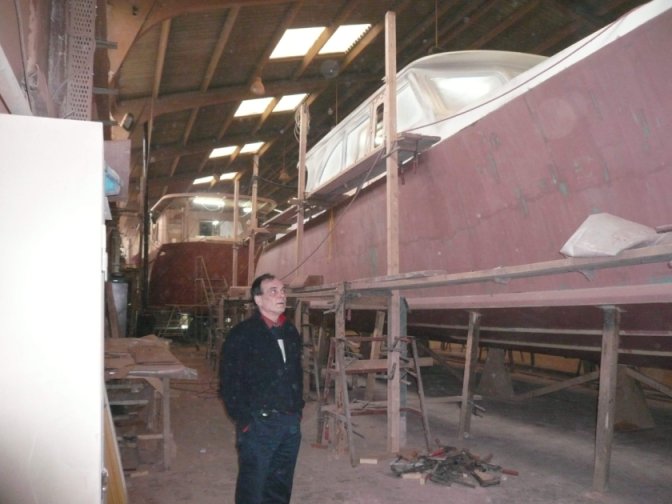

  4. apex1
    apex1 Guest
    We have no moulds, we make every single boat the same way a skilled homebuilder would do. Some temporarely framing is all.* Mostly destroyed after finishing. All boats I do in wood Ep, are one off and fully custom built.
    Nearly 63% of the already sawn and cut timber we buy, ends up in the paper mill! Precious and rare Mahogany and Teak....
    The reasons for cold moulding you already noticed. I can get a better fibre orientation and we have no laps/scarfs. On top of that we use the better quality veneers. It is by far the most expensive way of building boats, included carbon Epoxy composite.
    By no means I would recommend it as the method of choice for a homebuild hard chine boat. It is just my way of producing quality, which nearly no one else can provide today. And the market proves me right.
    *when you look at this picture, and imagine that the posts would be wooden and attached to the frames inside, you have a idea how we start the "mould" setup. Every frame has two posts going down to the floor. The keel and these posts hold the structure at starting the planking. Once the "shell" has sufficient stability, we replace the posts by moveable metal posts as in the picture, and plank the bottom. At the transom and at least the collision bulkhead the posts stay in place and are cut after the strips are applied and before the veneer goes on. They become part of the boat there.
    Regards
    Richard
    ähh, our newer plants look a bit more tidy......
    :cool:
