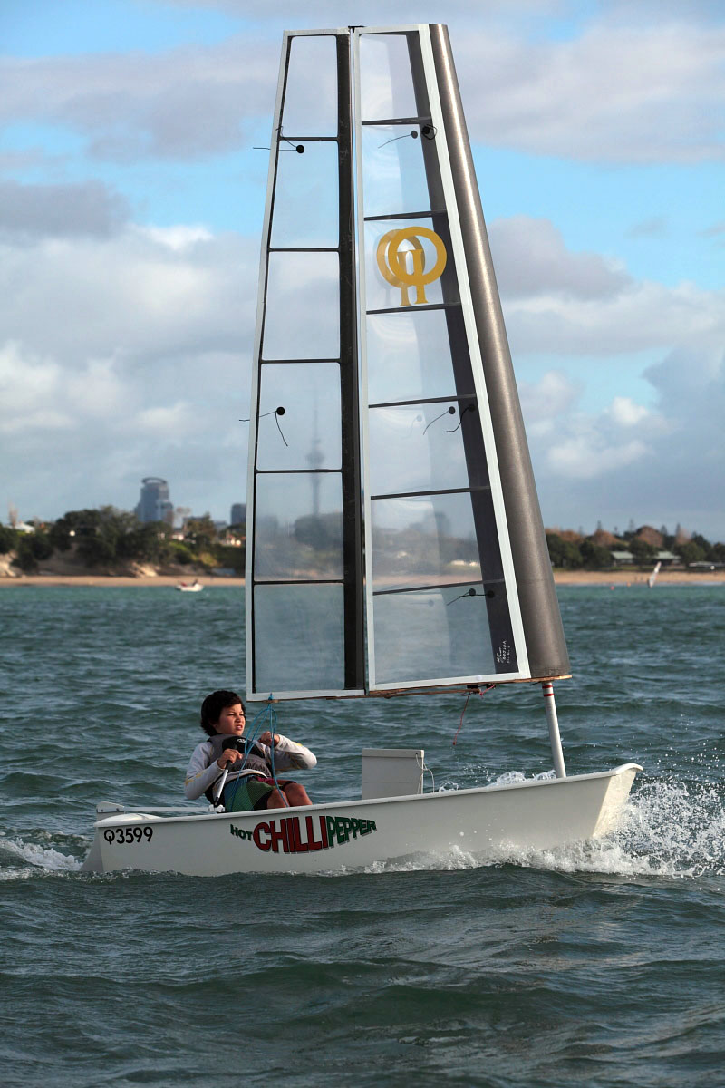

    Your rotating rib approach for the wing is ingenious.

    Note that masts/spars on my “new” boat are standing as laterally located bi-plane.
    The Schooner and Ketch have masts located longitudinally.
    Also, two wings on mono-hull:
    – one on the starboard
    – one on the port side
    This should be clear, I hope!
    I would like to get along with people who done it before in order to get some experience.
    And note that the NEW is how the wing is adjusted with 99% precision at any time.
    Sure that the wings are not new, however, bi-plane is well known from aviation but still maybe not on mono-hulls?
