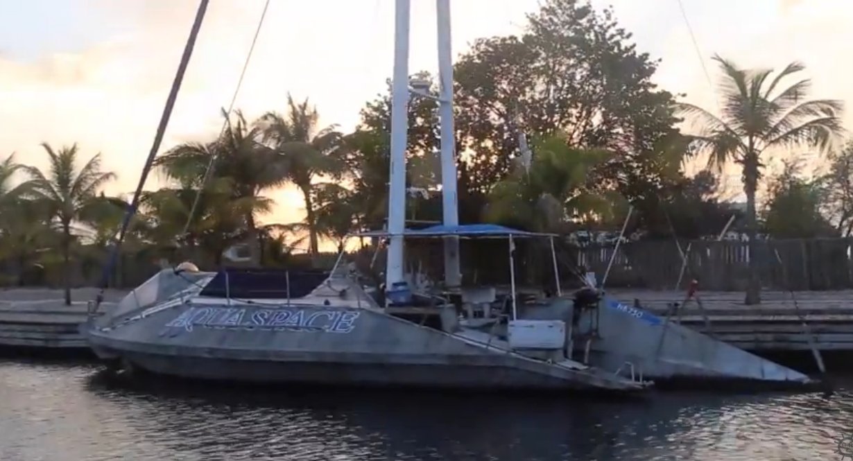

  6. Gus7119
    Joined: Dec 2015
    Posts: 110
    Likes: 1, Points: 0, Legacy Rep: 18
    Location: Sydney
    Gus7119 Senior Member
    Spaceship
    "Its a space ship!" Yep I saw that last night on its release also. Strange looking boat.
