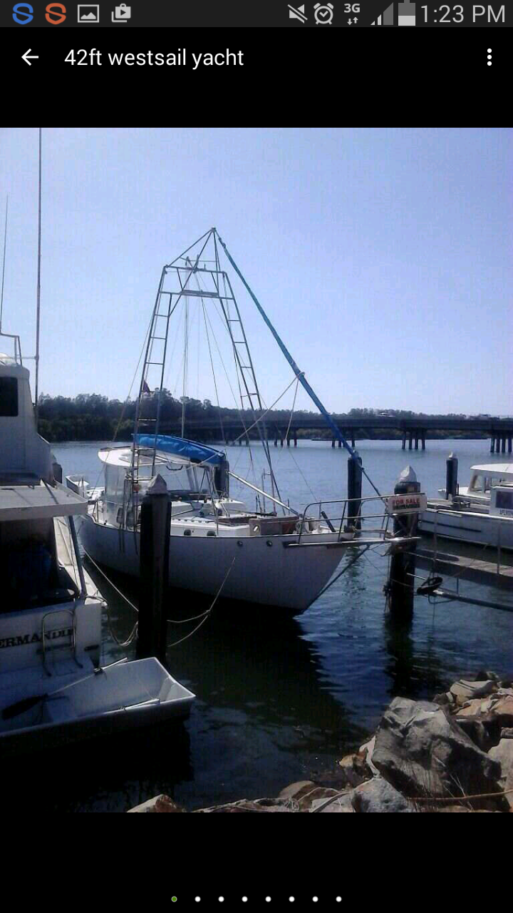

    A Frame Diffrent Setup
    A boat for sale on gumtree australia with a diffrent slant on the A rig enjoy.

    Aframe different rig setup from 1973
    For sale Australian gumtree

    That second photo (the one you posted twice is too dim to really make out the mast shape.
    And I don't see that either of these configurations is going to be viable examples for you to consider for your new design?

    Brian its the same boat the black and white is an largment I made of a photo of the boat on a pin board

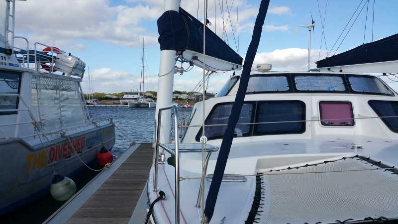

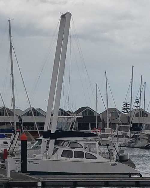

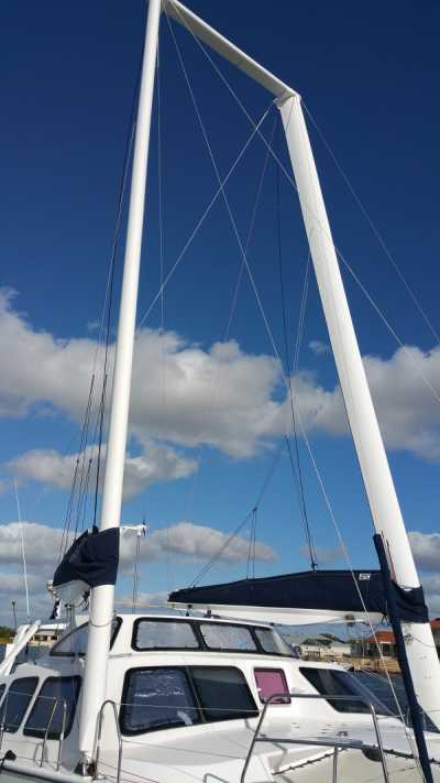

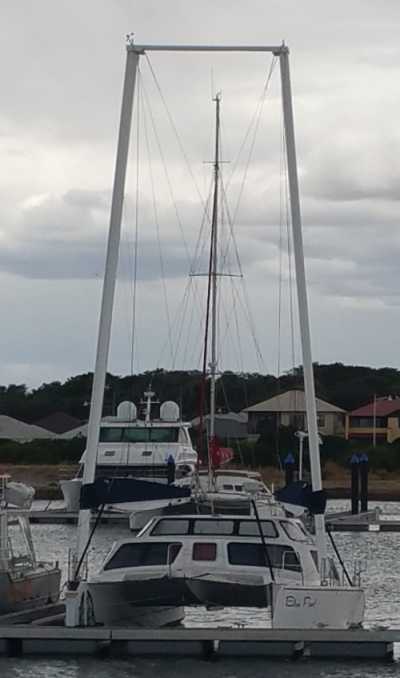

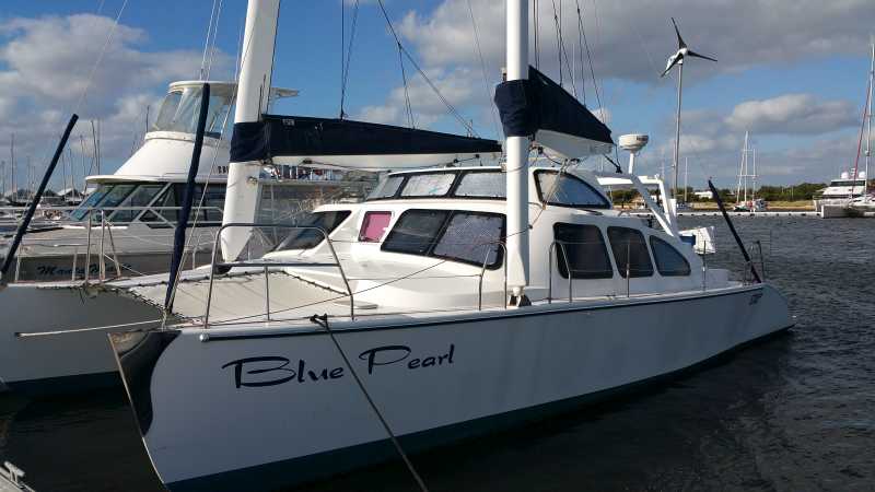

    A frame Kelsall cat
    Look what I found today in Port Geographe marina, South of Perth.
    I managed to find the contact of the owner, but he has not responded yet.
    I will endeavour to chat with him about his experiences and refer to you all.
    The rig has two rotating wingsections and two mains.
    The booms can rotate the masts and the amount of rotation is controlled so as to have a better foil shape between masts and sails.
    I cannot see reefs, etc, but will ask.
    I suspect one can sail this boat on bare masts only in stronger winds.
    Anyway, I will not speculate any more and will get back with a report if I manage to talk to the owner.

    Cool Cat Aframe
    Look how high shes sitting in the water. So much for all that extra weight. She looks like she was built for a single mast with the indent in the coach house fore windows being the design used for placement of mast.
    Looks like a dual sail as you explained. Another diffrent take on the Aframe. I love it. And that frame looks really high I wounder what its length is.
    Great work well spotted. Thanks so much.

    I met with the owner and had a look in and out of the boat.
    It is a Kelsall 33 extended to 36'.
    Yes, the coach roof is Marconi rig designed, but the owner went for the Kelsall designed A frame after he built the roof.
    Each rotating wingmasts weigh 40kg, the brace on top weighs 8kg, the rigging is Spectra and weighs 2kg. Total weight 90kg.
    The masts are 1.5m shorter than the single mast and he could have made them lighter if he'd used only carbon rather then glass with carbon reinforcement.
    So what he's ended up with is a lower centre of effort and really easy handling of the two smaller sails. No genoa.
    He did agree that she one sail blankets the other on a beam reach and that is the only drawback, shared by all bi-plane rigs.
    He hasn't sailed the boat much as he is busy with work (aren't most people in that predicament....), but we are going for a sail in the next couple of seeks and i will be able to tell you how she sail. He hasn't ever taken her out in more than 25~28kn, so never tried sailing with masts only (BTW, each mast is a 4.5 sqm sail).
