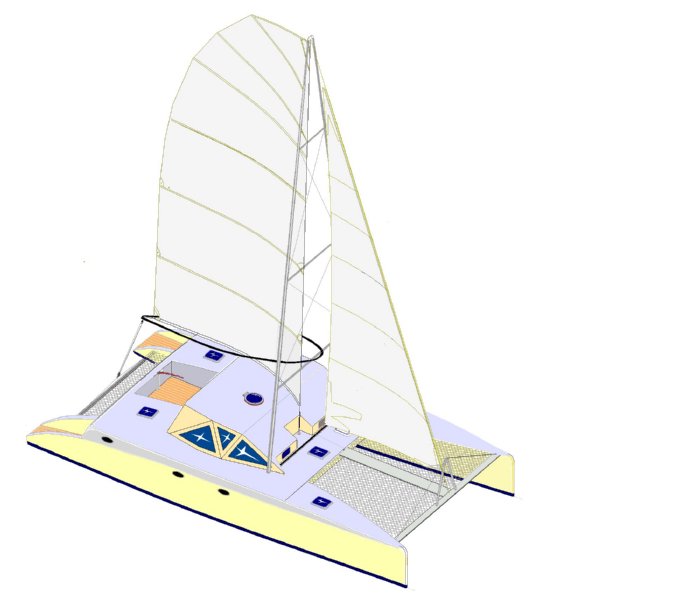

    Am looking for anyone with any experience or knowledge of these mast thet look much easier on the boat with less strain and allow for a ferling main and double ferling jjbs. Really interested as would live to put one on the cat I am building if they are good as they shuold be but know nothing about them.

    The simple reality of the A frame rig is there's more drag associated with it, in spite of some advantages, so it's not as close winded, it is heavier, so stability is affected, more costly, etc., etc., etc.
    You can have roller furling on all the headsails regardless of the mast arrangement. The same is true of the main as well.
    In the end, the few advantages aren't enough to justify the costs, stability and weight penalties you have to absorb.

    Even if the masts are carbon, there's still excessive weight aloft, compaired to a single carbon stick arrangement. Weight distribution is pretty irrelevant, it's stayed, so loads go to the hull shell and keel, where they need to be. Do the math and you'll come to the same conclusions everyone else has, which is why they haven't taken the worlds race courses by storm.

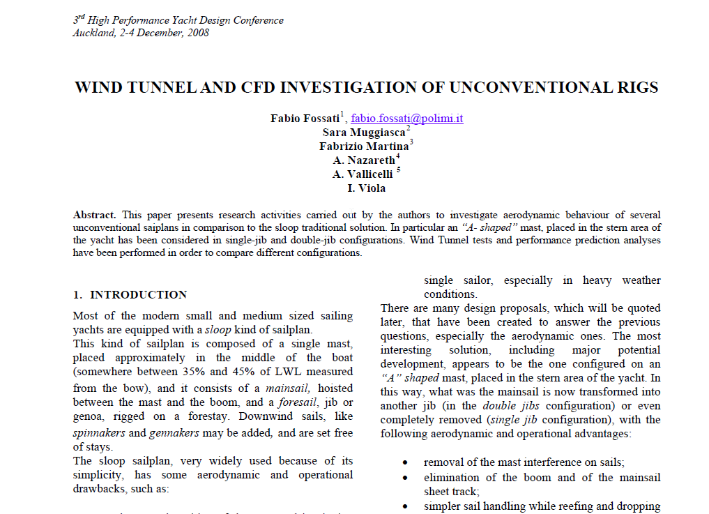

    Ok Im not going to win anyone over who has a one track mind. I have nothing against the standard rig but most comments on this subject come from people with no experience in using one of these rigs nor ever seen one sail nor worked on one. I have done much reading and for a cruising boat they seem like a good alternative heres one user that actually had a boat with a a frame rig or wishbone what ever you want to call it this is one of the reads that got me thinking more about it as it just wasnt maths and so antidotal evidence so read this think about it and then discuss with logic. As the forums Ive read on this site most people just say because a sloop rig is the best. No its not used in racing as its not for racing so just because of that doesnt count it out.
    As said love traditional rigs real life users swear by these rigs in the right setup so I want to have a real life discussion not just no one does it no racers do it I dont do it so it sucks.
    Anyway have a read of this sounds interesting. O one last thing removing the load from the center of the beam cant be a bad thing is this a fair comment. Enjoy;
    Originally Posted by High Tacker View Post
    UTILIZING RIG GEOMETRY AND CATAMARAN BEAM TO GAIN STABILITY
    Since we're discussing capsizing, rig strength safety factors, etc., it seems appropriate to note that most rigging schemes seem to be still hung up on the conventional fore and aft vertical arrangement, i.e., the conventional monohull rig, whereas, on a catamaran, not only does it make no sense to put a huge mast and its compression load in the center of the boat (requiring a heavy wingdeck structure such that you might as well go ahead and build a trimaran), it also makes no sense to put a huge tension load on the center of a beam between the bows. After all, a catamaran is two boats in one, so why not treat it as such, and in the process take advantage of the width of the boat and utilize a geometry that allows angles for lift and/or anti-capsizing loads.
    See www.damsl.com and on the welcome page look to your left at table of contents and click on "A-frame Rig".
    I think of Catbird Suite as two boats connected by a wingdeck, each boat having a masthead cutter rig, and the two rigs are leaning together, their masts meeting at the top, over the center of the wingdeck. Or perhaps more aptly, she is two proas leaning together. The head of each sail, genoa, staysail, and main, is connected to the masthead. The tacks of the genoas are attached to the bows of the two hulls. The tacks of the staysail and the main can be attached on the centerline of the boat, i.e., the centerline of the wingdeck, or on either side deck.
    For sheeting, there are tracks and various other sheeting points scattered around the decks, and the clew of each sail has two blocks for sheets so that, for each sail, there are four ends of rope that can be moved around to sheeting points and winches so that, when the clew of a sail is inboard, ideal sail shape can be maintained on all points of sail without booms or poles. That is possible when the tacks of the sails are on the windward side deck. With the tacks on the leeward side, then poles are needed.
    On a passage-making tack, especially if there is substantial wind, it's good to use the windward genoa and the staysail and main with tacks on the windward side deck. All the gear is then inboard and one can go from close hauled right through all the points of sail and maintain ideal sail shape without booms or poles. With the heads of the sails attached to the masthead over the center of the catamaran and the tacks attached to the windward side, the sails are effectively "heeled" and thus spill some wind.
    AND a substantial portion of the force on the sails is pushing the windward hull down, i.e., is an anti-capsizing force.
    In moderate to light winds, the sails can be deployed on the leeward side, and then a substantial portion of the force on the sails is upward, is lifting the leeward hull. Picture a windsurfer leaning into the wind so that his sail is tilted, not "heeled", rather the reverse, canted into the wind.

    Very much appreciate the discussion about A-framed rigs on catamaran here. I am currently myself planing a 37' catamaran featuring a A-rig. I think the pros and cons can easily be listed but it is the weighting of each of these facts that is subjective and may lead each individual to different conclusions.
    I however wanted to add two points for discussion:
    • It is out of question that rolling sails are a big innovation and offer great usability. For the mainsail two principal solutions exist: vertical rolling (e.g. into the mast) or horicontal rolling (into the boom). Rolling booms do not offer as many advantages as vertical rolling solutions: They require a battenless sail and the sail needs to be hoisted. Vertical rolling-sails come in two flavors: with in-mast furls and behind-the-mast furls. Behind-the-mast requires a gap which lowers the aerodynamical efficiency of the sail so much that the sail area has to be increased. This is why vertical in-mast furls currently are the canonical solutions for short handed cruising boats. In my(!) opinion there are however 2 problems related to in-mast furls:
      1. Safety: The sail may jam in the slit. This will most likely create a dangerous and hard to resolve situation
      2. Comfort: Having the sail passing the mast-slit prevents downwind reefing of the main.
      Both issues are mitigated by the A-frame mast. As far as I know only free-standing masts, beghind-the-mast furls, rotary masts and A-frame rigs enable true downwind reefing (to me relying on perfect batcars does not count). On a A-framed rig one can release the halyard in case of troubles with the furl.
    • I think that the masts of an A-frame can be built watertight and have a positive impact on the stability in the case of near-capsizes.
    My current matrix of pros/cons for a 37' low-end short-handed cruiser (simplified):
    Virtues of a Non-rotary-fractional-rigged-single-masted-sloop-with-in-mast-furl:
    • Aerodynamics up-wind: better
    • Triming possibilities: better
    • Top-weight/Pitching resitance: lower
    • Initial costs: lower
    • Resale value: higher
    • Maximize usage of commercial-of-the-shelf parts: yes
    • Structural properties of mast: better
    • Time-tested/Proven: yes
    Virtues of an A-framed-mast-headed-boomless-sloop-with-vertical-stay-sail-furling-main:
    • Ease-of-use on all point of sails: yes
    • Versatility: better
    • Load on hulls/bridgedeck/beam structures: smaller
    • Downwind main-sheeting angle: better
    • Upkeeping costs: lower
    • Ease of maintenance (e.g. taking down mast): better
    • Overall Safety (short-handed): better
    Best regards

  15. brian eiland
    Joined: Jun 2002
    Posts: 4,962
    brian eiland Senior Member
    SMG50 A-frame Rigged Catamaran
    Hi Gus,
    Here is a real life 50 catamaran that made use of an A-frame mast very successfully
    http://www.sail-the-difference.com/index.php?id=16
    http://www.sail-the-difference.com/index.php?id=44
    Shame they couldn't sustain the effort thru both the 'gaining acceptance phase' and the downturn in the boating market worldwide since early 2008
    Of course they were inspired by the Olaf Harken experiment Procyon that I wrote about here:
    http://www.boatdesign.net/forums/sailboats/procyon-project-bold-experiment-10771.html
