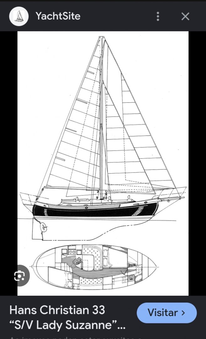

Hans Christian 33, which also has a magnificent interior
Hans Christian Yachts: Timeless, Classic, Ocean Voyagers https://hanschristianyachts.com/
Vancouver 32
Vancouver 32 archive details - Yachtsnet Ltd. online UK yacht brokers - yacht brokerage and boat sales https://www.yachtsnet.co.uk/archives/vancouver-32/vancouver-32.htm

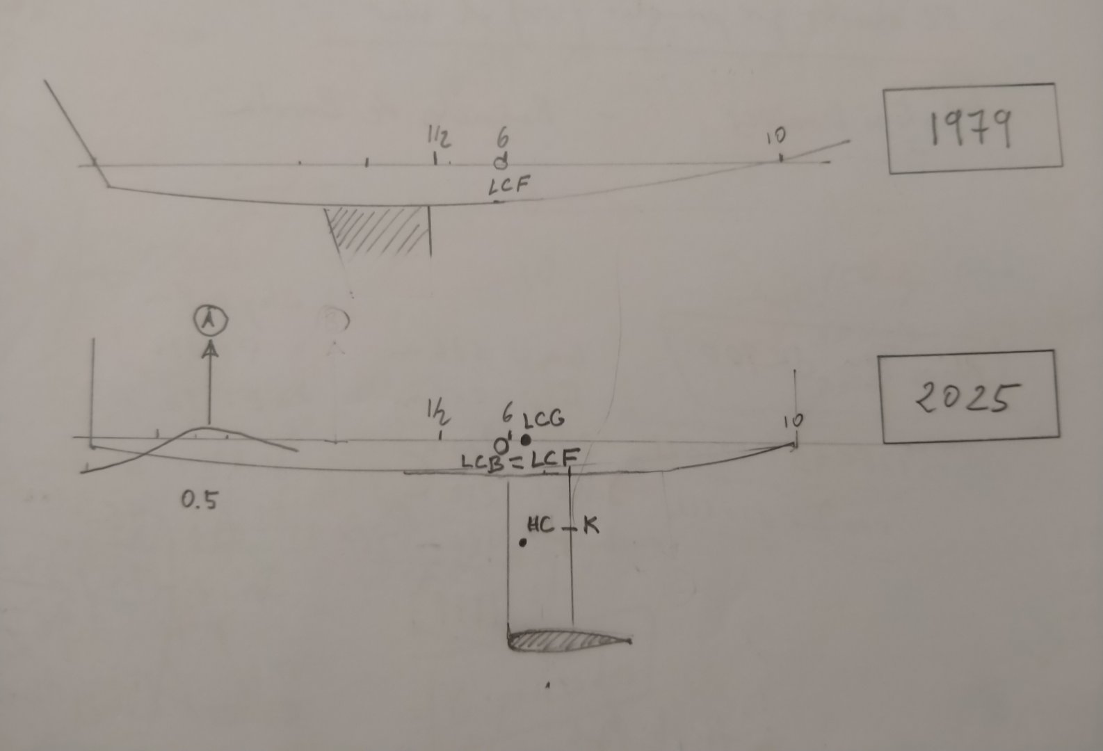

What's incredible from a classic point of view is
(A) the madness of placing the center of gravity forward of the Pitch axis of rotation so that the forces of the Earth and Sea easily attack the yacht, and
(B) placing the lateral pressure of the water forward of the Yaw axis—magnificent for winning a summer regatta in the 1970s and 80s, but terrible on the open sea
Hans Christian 33
Modern and Classic
Crazy Modern Yacht (1979) and Ultralight UltraClassic WindSurfBoard Plywood Epoxy (2025)

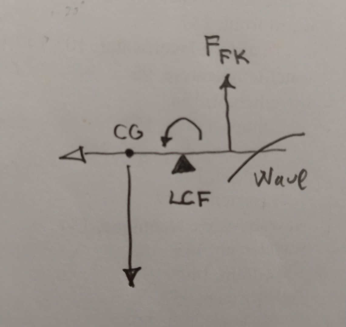

LCF: Center of Flotation Longitudinal position when a Big ocean wave arrives from the stern: Rotation Pitch Axis
HC_K: hydroDynamic center of the Keel
8 tons Hans Christian 33 yacht and 0.8 tons tiny sailboat
Pitch Axis of Rotation: Center of Flotation
Yaw Axis of Rotation: Center of Buoyancy (or/and Center of Gravity)

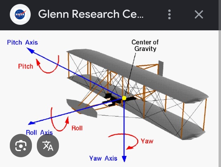

Stable Equilibrium of Aeronautical type: his yachts, therefore, should be drawn with their noses pointing to the left
Airplane Stability and Control https://books.google.es/books/about/Airplane_Stability_and_Control.html?id=j5SHkQEACAAJ&redir_esc=y
It is a common misconception and complete misunderstanding of the difference between an airplane and a boat. The first operates within a fluid, while the second at the interface of two fluids of very different density and viscosity. In short, sailing an airplane is a fool's errand.

A) Why the Keel must be Neutralized (HC_K = LCG, LCB)
Because the rudder must compensate for
1) the imbalance created by the sails
2) the imbalance created by the sailboat’s hull Roll/Heel
3) the imbalance created by the sailboat’s hull Yaw/Leeway
4) the imbalance created by the sailboat’s hull Pitch bow down, and
5) all of this in a very demanding operating environment for the rudder due to the orbital current of the wave
In other words, even by neutralizing the keel, we cannot ensure that the yacht will have a stable equilibrium on the yaw axis

LCF: Center of Flotation, Longitudinal position
Wave: ocean Wave
F_FK: Froude-Krylov Force

Obviously, at 20 knots, longitudinal imbalance in a high-performance racing yacht is irrelevant for two reasons: because the speed at which the wave meets the yacht approaches zero, and because at that enormous speed, the hull generates hydrodynamic lift.
But in a snail-yacht that carries its house on its back ... the problem emerges.
