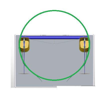

    I think that if the shape, angle and location of the foils coincides with a circle at the center-line of the boat, it will act like a tube of the same diameter. And a tube should have zero roll stability.
    The PDF you linked to earlier showed a different design of the Nacra 17 foils. Look how close the foils are to being arcs in a circle.

    This is not correct. A tube has no roll stability because it's CoG is at the roll centre, and therefore does not change as it rolls, and hence there is no righting moment or overturning moment. When a foiling boat rolls, both the CoG and the lift centre changes, providing roll stability.
    The roll stability when on foils is closely tied to the heave stability of each individual foil, so if a Z and an L have similar heave stability characteristics, they will produce similar roll stability on a catamaran. This is not necessarily the case, however, as the L reduces lift with leeway, whilst the Z increases lift with leeway and relies on surface piercing of the lifting portion to provide heave stability. This is why L foils are inherently easier to make stable, because the change is through angle of attack, not through reduced surface area. Both can be made to have similar heave stability by choosing particular geometries, but they are achieving this through different mechanisms.
    This is why ETNZ decoupled roll from side force in their AC50, using the top of the wing to control roll, but automatically adjusting the lower wing at the same time to keep the side force constant for a given speed, and hence the ride height constant. This would work with both L's or Z's.
    However, most of the comments about stability on foils is related to pitch stability, not roll. Roll instability can be compensated for by steering input, but pitch instability requires feedback between main foil heave, rudder foil pitch, and sail force, which is more difficult to balance.
