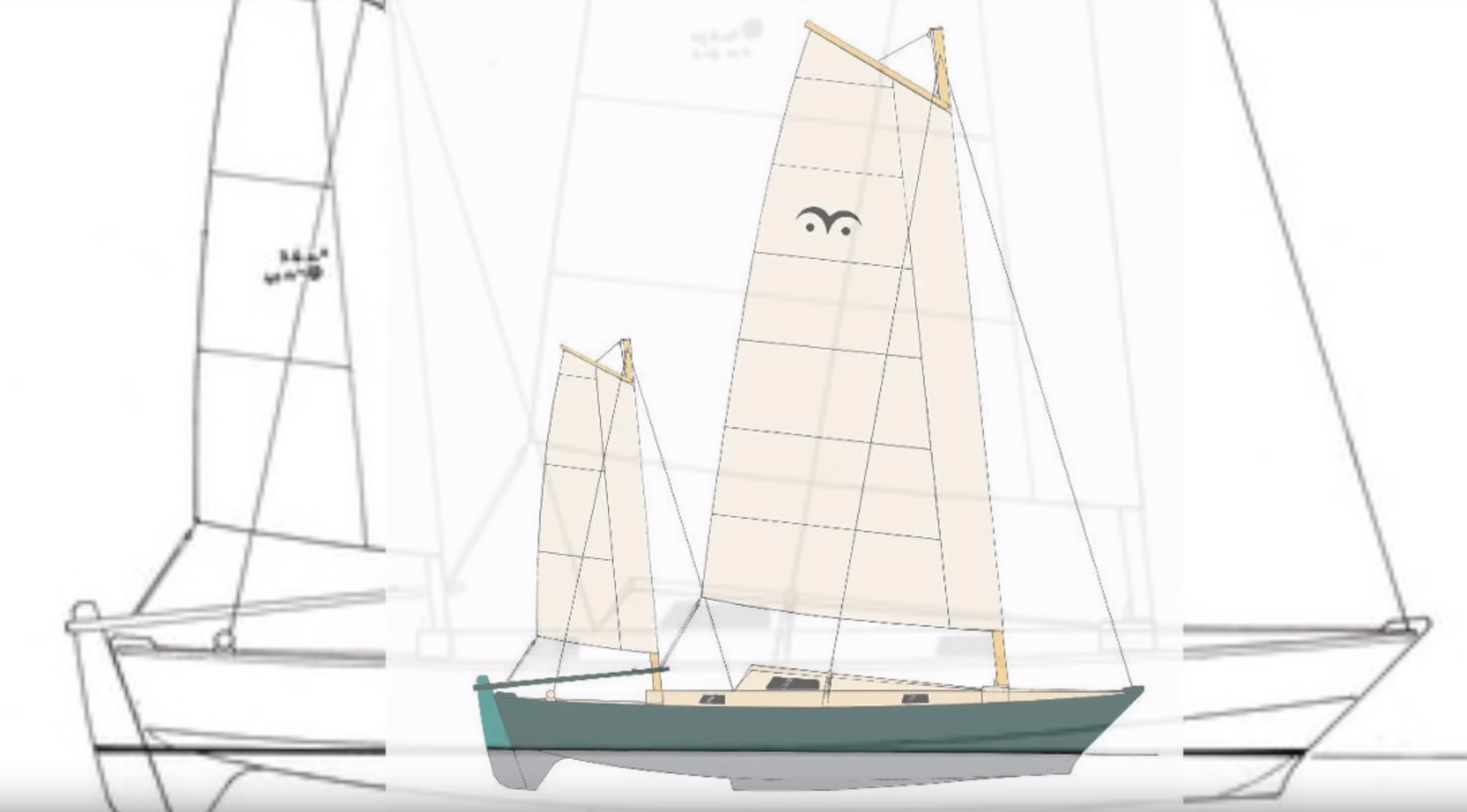

    It looks like Wharram has already designed a better Tiki, the Mana 24.
    It has a whole lot of better ideas, including more internal room, all CNC cut with tabbed building connectors, skeg keel, solid deck, better outboard pod

    I have had a chance to look at someone else's T21 plans. At first glance I Thought Wharram had done a better job but as I looked harder I started to see all the same problems. It is true the hull sides are easy to make but then it descents into chaos. Many little parts to make, and yes each is simple but there are lots of them. A good example is the mast since you mention the rig. Trust me there are easier ways to make a mast. Wharram himself mentions on the drawing that he tried to avoid the proper use of a plane. and the Gaff! The beams have already been mentioned above. Take a good careful look at the Woods approach and the Wharram approach. Mr Woods achieves a stiffer and more durable beam with far less effort material and skill.
    James Wharram has reputedly sold more plans than any other multihull designer. He has also been at it longer than just about anyone so that helps the total. I am in no position to argue that completion rates are higher, I don't know. What I do know is a vast number of Wharrams have rotted away, that many were built not to plan and many of those were properly awful boats (you can't blame the designer for that I guess, although wharrams seem to attract more of that than other designers). Even those built to plan are disappointing boats with terrible resale.
    My GUESS is people PERCIEVE Wharrams as easier to build and so have a go. I am confident however if you did a proper time and motion study building a Wharram and another good similar cat design you would find there is pretty much nothing in it.
    It is true you can save a lot of money on a home built rig compared to a factory built new one, but second hand masts and sails are cheap. Here for cats under 30' I can buy second hand spars for less than the materials to make a mast out of timber.
    As I have said before the trick to a great boat design isn't in the hull lines. Anyone can draw a hull that works. The real trick is in the details both for build-ability and use.
    Someone previously said the nesting in the 21 was good. I heartily disagree. There is a significant amount of ply wasted AND things like the aft decks are 2 pieces joined. There were no nesting programs in 1984, in common use anyway, but you can do the same thing with paper templates. I would of course take a slightly different approach and use a few more sheets of ply to make a higher boat. Slightly more cost but a MUCH more comfortable result, and virtually no extra labor. I believe the T21 isn't that low because he wanted to minimize ply sheets. It follows his long held practice or building cats with really low freeboard. He has a fascination with windage and no concern about the bridgedeck being awash.
    Anyway I'm drawn into Wharram bashing again and I didn't really want to do that. They are what they are and if people want to embrace that great. I just thought that with some consideration the Tiki 21 could be improved.

    Except it is only available as an outrageously expensive kit, not plans. Have a look at the prices!
