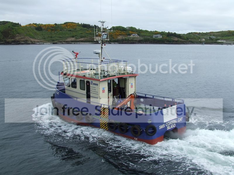

    Here's some more photos ive already posted in the thread of a tunnel cat design built for wind farm servicing in Ireland....but in alloy.a very similar design to your suggestions.
  7. bajansailor
    Joined: Oct 2007
    Posts: 3,621
    Likes: 1,580, Points: 113, Legacy Rep: 37
    Location: Barbados
    bajansailor Marine Surveyor
    The SMS Coastal Cat looks very neat - but even built in ally she is very 'tubby', rather like a tug - and she would have to be even more tubby if she was built of steel, AOTHBE.
