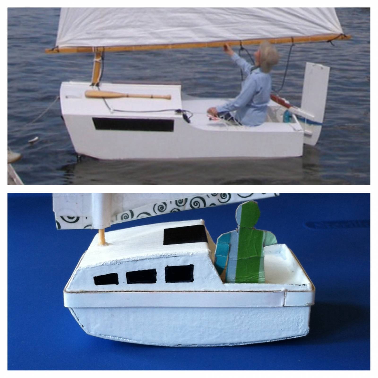

    You had better make the hull bigger with all the extra weight you are going to add.
    What is the cabin for? Unless you are a midget you are not going to get in a 4' cabin.
    If it is to take camping supplies you need to make the hull bigger still.
    Will this have seated headroom inside?
    Sorry, I just don't get it.
  3. Scowt
    Joined: May 2014
    Posts: 11
    Location: NY
    Scowt Junior Member
    True the cabin is 4ft. Another 4ft for legs is under the benches on either side- not much detail on that, I know. The cabin is 39 inches. Just tall enough to sit in. I'm sticking with 8 ft because the hull conforms to pdracer specs. It's a small boat, but a proven sailor from all the pdracer videos I've seen. It's only 4.5 sheets- 3.5 of them are only 1/4". 1 (bottom) is 3/8. Total weight is around 100lbs.
  4. Scowt
    Joined: May 2014
    Posts: 11
    Location: NY
    Scowt Junior Member
    My main wonder is how much difference adding a cabin will make in the performance. Without the cabin , pdr's cruise around 4 knots. Don't worry I would never think of hittin the ocean, but lakes seem ideal and I can put it in my pickup for hauling around. Seems perfect for weekend trips and such.

    I don't get it, I really don't get it.

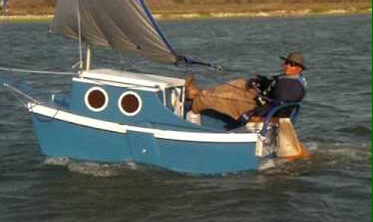

    there is precedent... Ocean explorer
    It has two quarter berths although the hatch opens on one. 1 adult and 1 child have slept in it. There is a 12 foot version too. Many PDs have had cabins put on them.
    At least one of those (the red one I think) has done the Texas 200

    Whew, I appreciate the back up. I'm stuck on the micro concept, I guess. The ocean explorer influenced my cabin idea greatly, but I want to be able to sit up in it

  11. upchurchmr
    Joined: Feb 2011
    Posts: 3,287
    Location: Ft. Worth, Tx, USA
    upchurchmr Senior Member
    Apparently guys have fun in a PDR.
    RHP and I agree.
    I would never want to sail a sand box
    I believe these are an exercise in masochism
    "look how tough I am to sail this"
    It would be cheaper for you to buy a used plastic boat and actually sail and build your skills - in comfort, faster, safer, and the ability to make lots more distance - finding more new things to experience.
    Even look at all the Bolger boats - many of those will actually sail (some even while looking hideous - IMHO).
    Step back and look at that boat. You have probably added double the weight of the original boat. It will sink that much farther, making it sail that much worse. Then you load it for cruising. It would be easy to add that much weight again. Soon you have no freeboard, you cannot move around the boat without taking on water. It won't be anything but a raft.
    You won't be able to sell it when you get tired of not being able to sail.
    Now you take the cabin off and fill it with sand for some child - a real sand box at last.
    Never mind me, its your money, time, and life.
    Actually I have a better investment: Please no cabin!
