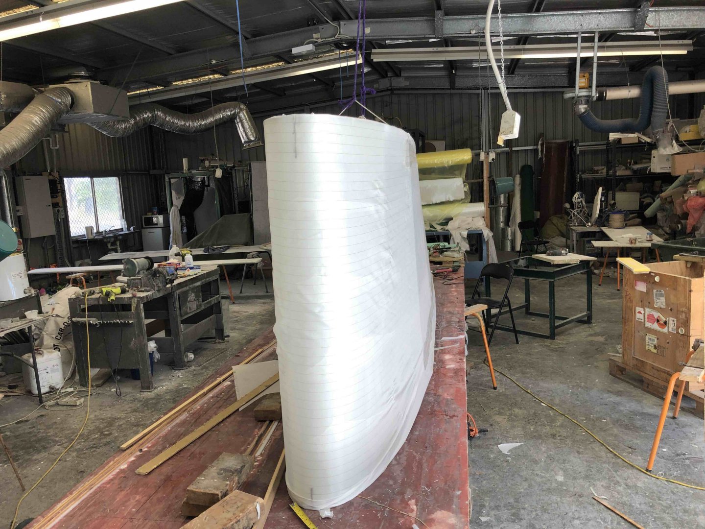

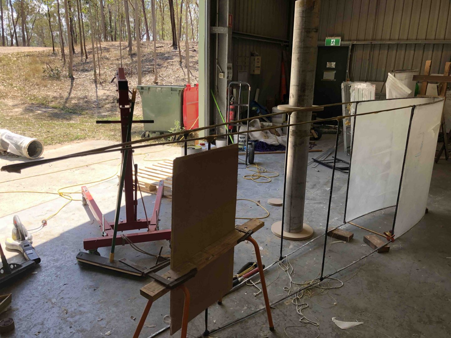

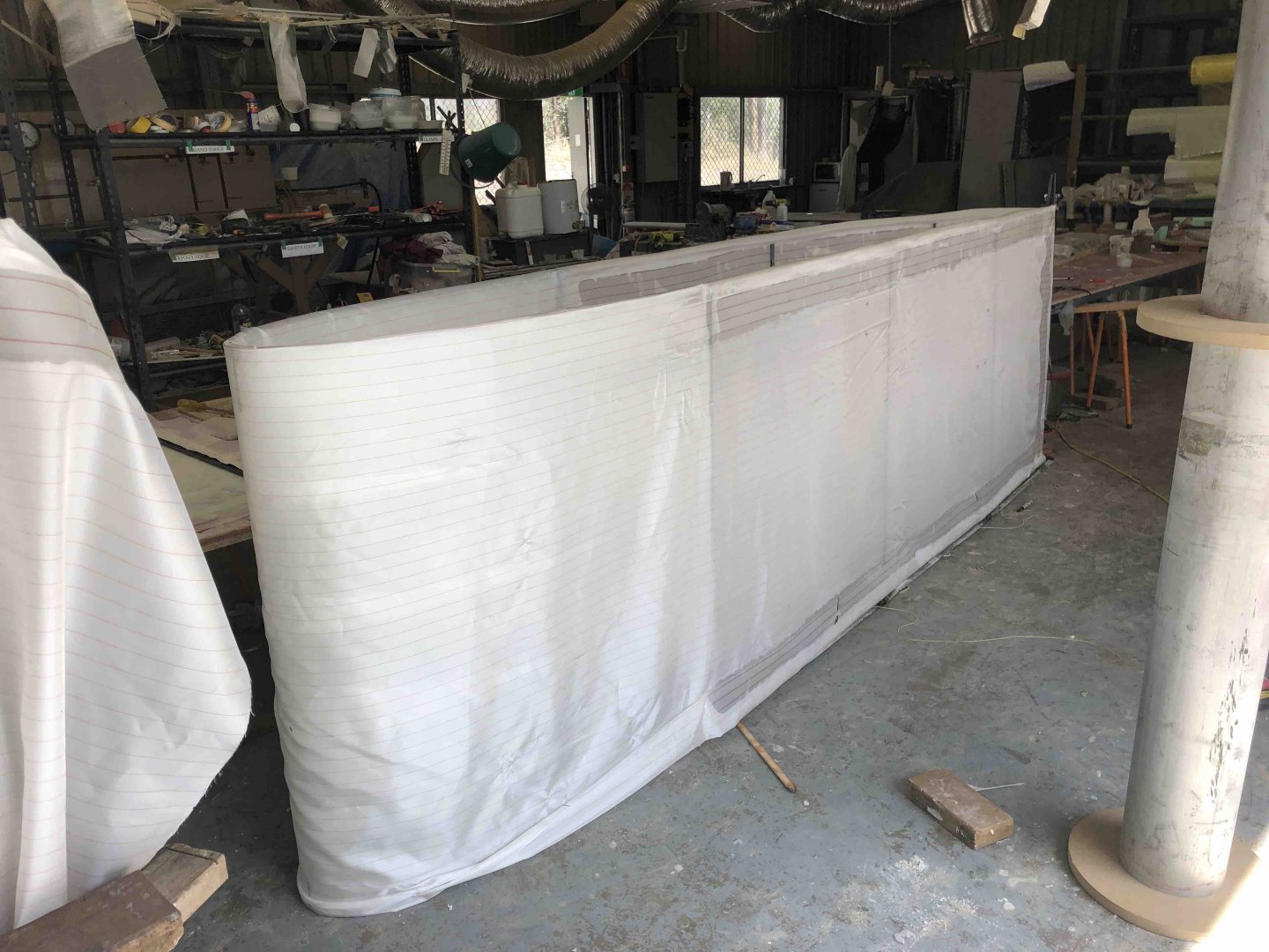

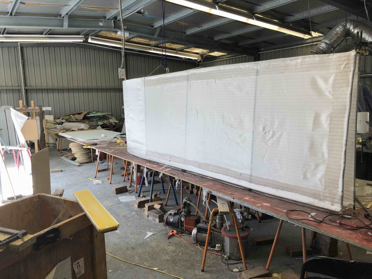

    A fun week playing with the wing. WIP pics attached. The final version will look different to this. The material (peel ply) is not tensioned height wise, the camber inducer will be less ornate (and automatic), the cloth will be sewn, not glued and it won't wrap around the leading edge.
    The wing structure is low cost carbon rods (~$AUS4/m, $1,600 per 50 sqm/540 sq' rig) which we can easily make bigger or smaller and mass produce anywhere. The latest wet out machine makes them easy.
    Each section weighs 4.5 kgs/10 lbs, 45 kgs total per rig: I think this is significantly lower than the equivalent sail, battens, track, cars, boom, traveller and fittings for a 50 sqm mainsail?
    There is plenty of development still required but it looks, to my ever optimistic eye, to be on the right track. Next step is to put it on a mast section and see what we can learn, then start on all the little, tricky jobs. Like raising/lowering it and the telescopic mast, sheeting it and getting it to stack neatly.
    The rest of the 18 month build story including pics, weights, costs, mistakes, lessons, etc is at Cargo Ferry Prototype – Harryproa http://harryproa.com/?p=3788.

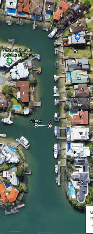

    I sailed my 7.5m/25' una rigged Elementarry upwind up the canal out the back of my house. See attached map showing a 20m/66' marker. The distance to sail is about 200m, the breeze is channelled pretty much straight down the canal. John Metza said the following on Multihull Mailing List: "I watched Rob shunt his 25'/7.5m proa upwind up the narrow (35m for most of it) boat filled channel behind his house so fast and easy I thought he must've had an electric motor hidden in the leeward hull. I would've had a very difficult time doing it in a beach cat without stalling, hitting somebody's boat and/or breaking out a canoe paddle. With the exception of a wind surfer, I had never seen a sailboat with a reverse gear before. He could head right for something, then throw it in reverse, back away and bolt off in a new direction under perfect control. I would not attempt it in a cat unless I had a crew and a jib to backwind. There is not enough room to gather speed to tack and if you screwed it up, you have no control so hitting a moored boat or the wall is inevitable. Screw it up on a well set up proa and you sail off in the other direction and try again."
    I have added taking video of close quarters single handed shunting to the prototype 'to do' list.
