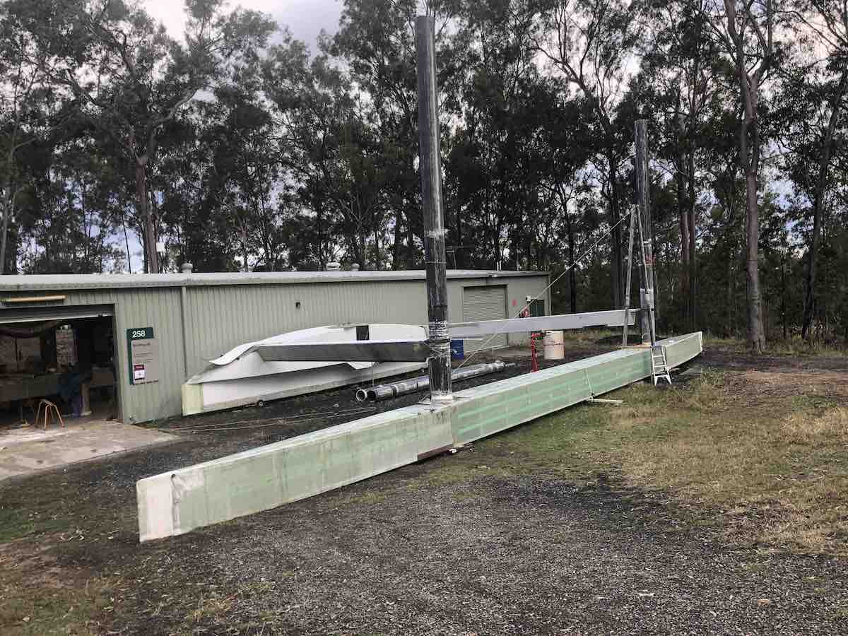

    The main components (except the wings for the masts) are built, now it is loose end time. Lots of little jobs finishing everything off. Best described by 95% finished, 95% to go.
    I decided to simplify things and save some money (the carbon pultrusions have almost doubled in price since we bought the first ones) and start off with a 2 section telescoping mast rather than 3.
    There is a pretty good chance that we will be getting Wisamo inflatable sails. A few more hoops to jump through, and the usual financial issues, but looking good. Should know in September. Meanwhile, we will keep playing with the wing rig because it is interesting.
    I've been asked to speak at a conference for traditional and modern boat builders, with emphasis on zero emissions and locally built, situation suitable vessels. Some interesting people have been invited, it should be an informative couple of days.
    A group of switched on Fijian business people and academics (Sustainable Sea Transport Initiative, web page up 'soon') have offered to do all the ground work for a trial route from Suva to the islands to the east and south. This is a huge load off me and should ensure there are no cultural, legal or procedural missteps. The routes consist of short hops between 7 villages, maximum leg length of about 100 kms/70 miles. These routes will show us what works and what doesn't and should reduce what was intended to be 3 years of demonstrating into 6 months. All going well, the next step is to set up a boat building facility in Fiji and start producing them, followed by a shipping company to start using them. SSTI are actively seeking funds for both ventures.
    It is astonishing how many grants are available and how many boxes the cargo proa ticks on those grants. They are also getting interest from other parts of the Pacific, in particular the Solomon Islands.
    SSTI reckon launching in Fiji is a better idea than launching here from a PR point of view. They have an assembly and launch site arranged on the shore of Laucala Bay (east of Suva) which they want to make into the Pacific green shipping hub, including sail training and boat building, are talking to the Minister about import duty and to shipping and trucking companies about reduced rates. The components will fit in 2 containers, cost about $9,000 from door to door. This is less than the cost to get the bits trucked from the build site to a boat ramp, rent while we assemble it, some more to launch it and a lot to get the safety gear required for the trip to Fiji. Plus a considerable payment and copious paperwork to the Aus authorities for registration.
    SSTI are supplying a couple of Navy6 electric outboards, at least 5 sq m of solar panels and 4 x Blue Lithium batteries. One motor will go on the tender, not sure about the other, yet. They will be enough for motoring in no wind and for maneuvering in tight spots. A big step up from the cheap second hand outboard I was intending to use.
    Dec 1 in Fiji is looking possible, maybe launch by the end of the year, but probably not. Trial routes begin in April.
    Fit out decisions are coming up which makes me realise how out of touch I am with developments. The minimum the boat will need is a chart plotter/gps, AIS, tracker, VHF and nav lights. These will either be second hand/cheap if I have to buy them, or top of the range in terms of durability if someone else does. Any suggestions welcome.

    Pretty good progress since the above.
    Strengthened the toybox with glass tow and put it, the cockpit and tender in place between the beams.
    Modified the wet out machine and made two carbon ribs for the warping wing and sheathed them to make a telescoping section. Slowly working through the problems, slightly faster than new ones appear.
    Got the kick up rudders sorted and in place, started on the 2nd ones.
    Did a hull lifting test using a rope around one mast. Lifted most of the other hull before the lifting line broke.
    Pics and details at Cargo Ferry Prototype – Harryproa http://harryproa.com/?p=3788
