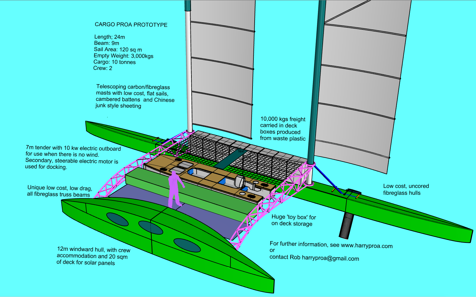

    Semantics again. Call it what you like. It is a boat I am building to demonstrate zero emission, situation suitable, low cost shipping to remote Pacific villagers.
    It is designed to be built by unskilled workers under supervision in remote places, not "series production".
    It is different to the Harryproa cruisers in enough ways that no one would confuse the 2. If it sells more of them, I will not complain, but that is not it's purpose. It's construction is Research and Development, paid for by me from plan sales.
    I am paying for the materials and doing most of the labour. The Uni's reasons for getting involved, according to the Composite Engineering Head of Dept:
    "It is an exciting project creating lots of opportunities because:
    • It is a project that is closely related to a number of UQ’s core values, viz. to create change, to positively influence society, to shape the future, to develop and inspire the next generation leaders, to advance ideas that benefit the world.
    • Rob Denney has a long history of successful, innovative boat building, and initiating and delivering creative projects.
    • It has the potential to provide extended marketing opportunities for UQ in the areas of sustainability and composite materials.
    • It allows our students to get hands on experience with the materials and techniques they are studying.
    These are the reasons why the UQ Composites research group has agreed to offer space in their Pinjarrah Hills shed to manufacture the vessel."
    The volunteers figure they are better off working constructively for change rather than waving placards outside Shell's offices. They are having a great experience, we have to limit how many can work at one time.
    The demonstration voyages will not be "subsidised" by anyone, except me. The cost to the shipper of shipping the freight on these demonstrations is zero.
    It is a net win for the villagers, who currently have poor to nonexistent service. To me, it is a financial loss, but a huge feel good gain.
    The plan is to demonstrate/cruise the boat for 3 years, then give it to a village. I don't end up owning anything. The reason I can do this is because business for the last several years has been so good.

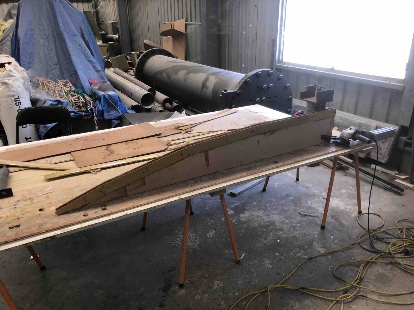

  15. rob denney
    Joined: Feb 2005
    Posts: 983
    Likes: 389, Points: 63, Legacy Rep: 436
    rob denney Senior Member

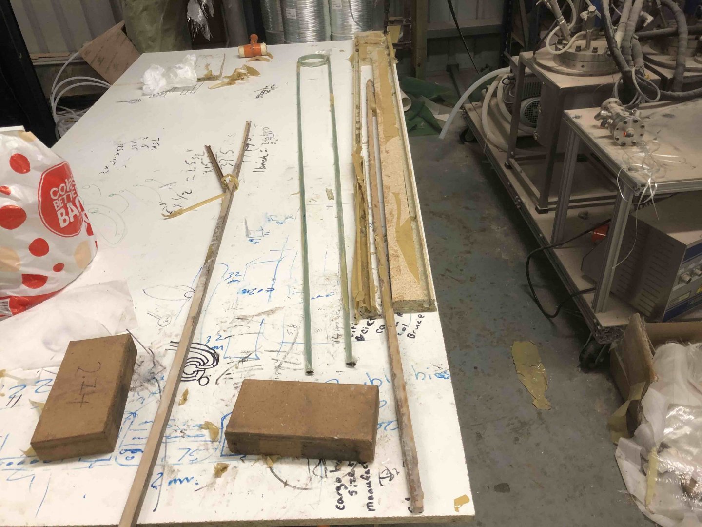

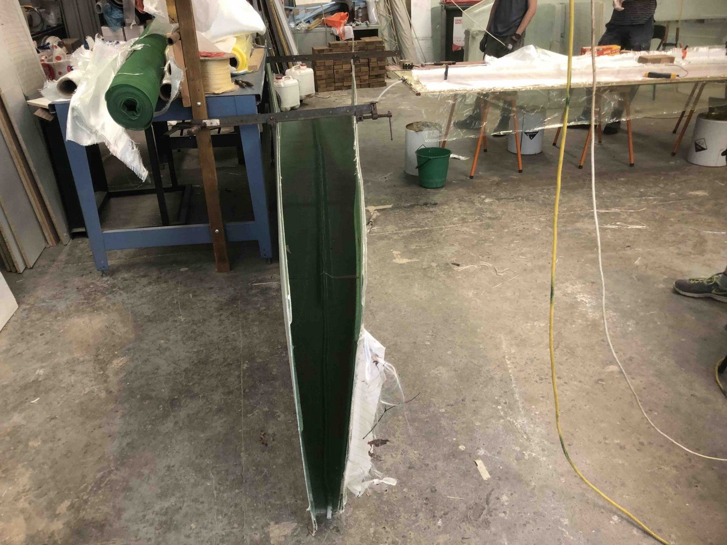

    My pleasure. They closed the site at noon today, so we only got 2.5 days work done this week. However, ir included one of the lee hull bow sections, which enabled us to see what the bows will look like. see attached. Each of these panels is 1/16th of the lee hull and uses 7.8 kgs of resin, including wetting out the peel ply and medium. Assuming 2:1 fibre:resin, the hull skin will weigh under 200 kgs/440 lbs. Plus 25 bulkheads at 3 kgs each, 2 mast steps, the pins and holes to hold the 3 sections together, some glue and paint and and it is looking pretty light.
    Pics upload crashes my computer so you will have to wait until I post them on Harryproa https://www.facebook.com/Harryproa/?ref=page_internal
    (edit) Some have uploaded. The first 2 are the model beam, designed to break at 150 kgs load.
    The solid glass option works best on narrow hulls. The Orbiter hull bottoms are 30mm foam with 1200 gsm glass each side. Infused weight about 6 kgs per sq m. This is the equivalent of about 4000 gsm glass. Whether this is enough or not depends on the furniture and bulkheads, but for most of the hull , it probably would be.
    Not usually while sailing. The length means bigger waves are required to get it to leave the water. The lee hull is pressed into the water so should not slam, and the windward hull on a cruiser should not get close to flying. There will be exceptions, but the hulls, beams and rigs are plenty strong enough to take the loads if it does slam. In most cases, it is a warning to ease off or change course. Motoring into big seas may cause some slamming, which would be fixable by altering course.
