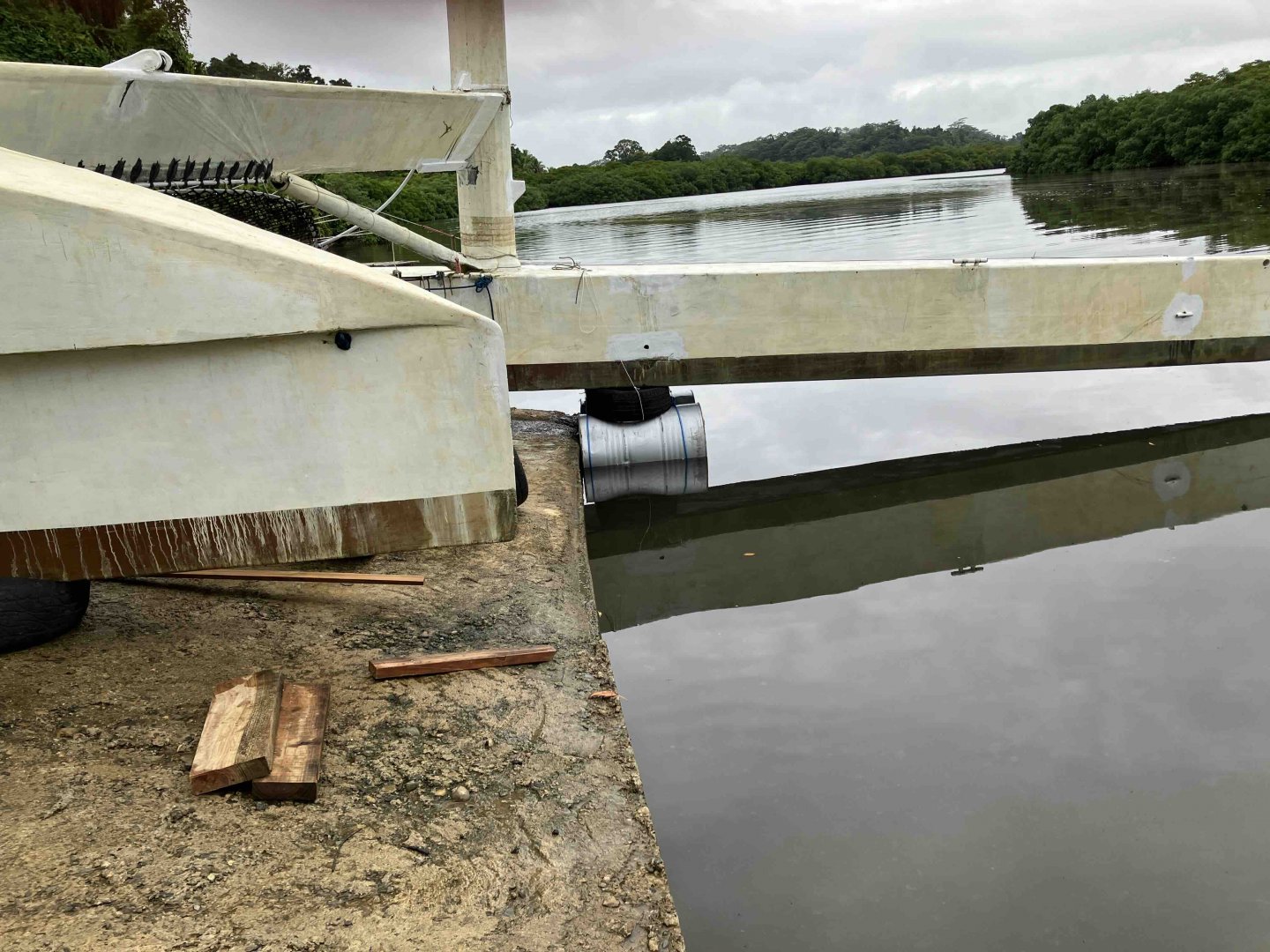

    The conversion is now done, (see next post) test results when we have them. The carcass is a 40 hp 2 stroke, I haven't checked the ratio but pretty sure it will be less than 1:1. Once it works, we will look at optimising it. The water taxi hull is less than 100 kgs, the panels and battery will add a bit, plus 10 passengers, so the motor will need to work over a wide range.
    I used a Sonic leg for the windmill boat, turning a 1m diameter 4 bladed controllable pitch fibreglass prop I made. A bit clunky, but did the job.

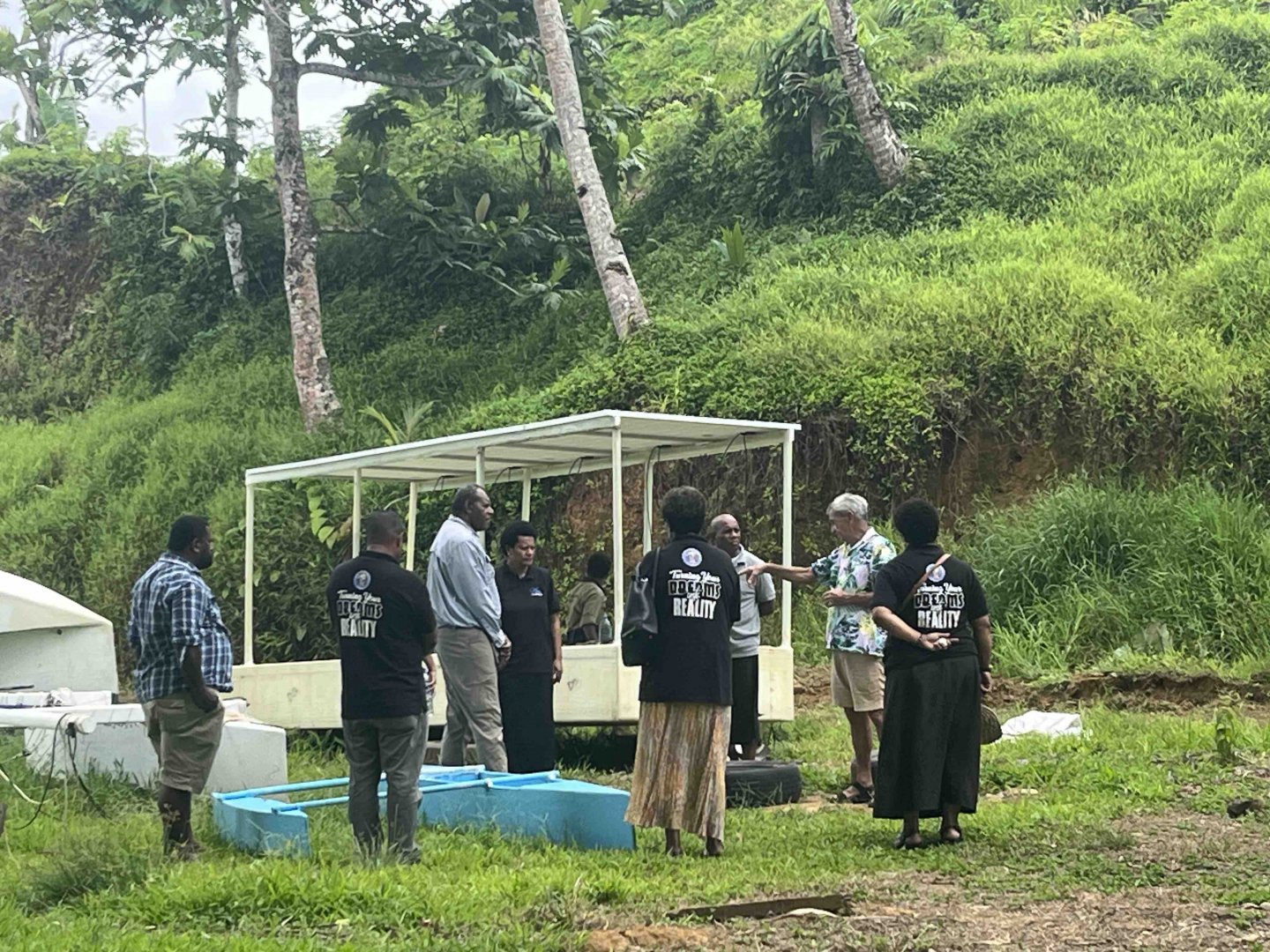

    Update 8

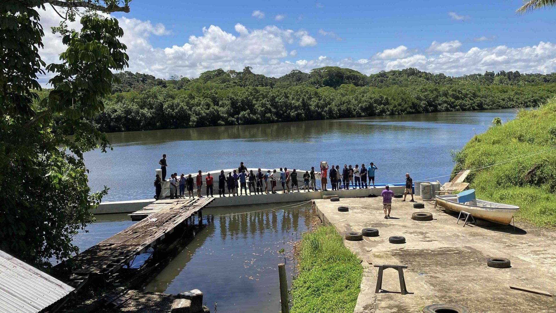

    Following on from the village women's canoe building workshop, we got requests for more workshops and chose the village of Dromuninuku, 30 kms east of the beautiful town of Savusavu, Vanua Levu. The cruising around there is fantastic, and almost free of cruising boats, despite Savusavu being a clearing port for Fiji.
    Salote and 2 of the other graduates from the April workshop (Siana (Dromuninuku) and Lo (the neighbouring village of Naweni)) ran the workshop, producing a catamaran canoe in 9 x 4-6 hour days. Not bad for a group of women who did not know what foam, epoxy or fibreglass were when they started.
    Sue (my wife) and I oversaw the workshop, but had little to contribute. We also got a small taste of village life, an experience neither of us will ever forget. Villagers don't have much in the way of possessions, but are genuinely happy, in stark contrast to many westerners I know.
    The canoe building is a big deal, as shown by the attendees at the award ceremony. Representatives from the UNDP, the Provincial Council, the Ministries of Fishing and Health and CATD handed out certificates to the women, then watched as the boat was launched. The ceremony speeches emphasised the importance of small boats for fishing (neither village has any, they fish standing in the water inside the reef at high tide), the need for lightweight, easily built (no power tools, all right angles), rot proof boats (not plywood). One person did comment that this is what traditional boats would look like if foam, fibreglass and epoxy could be obtained from coconut trees!

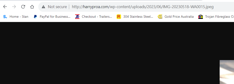

    Oh, bye the by, your main website needs to be adjusted to become "Secure" again. Cheers

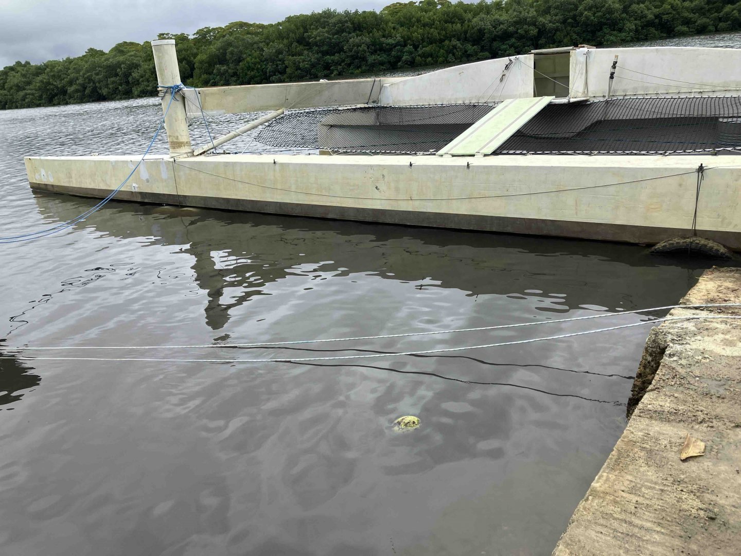

    UPDATE 9

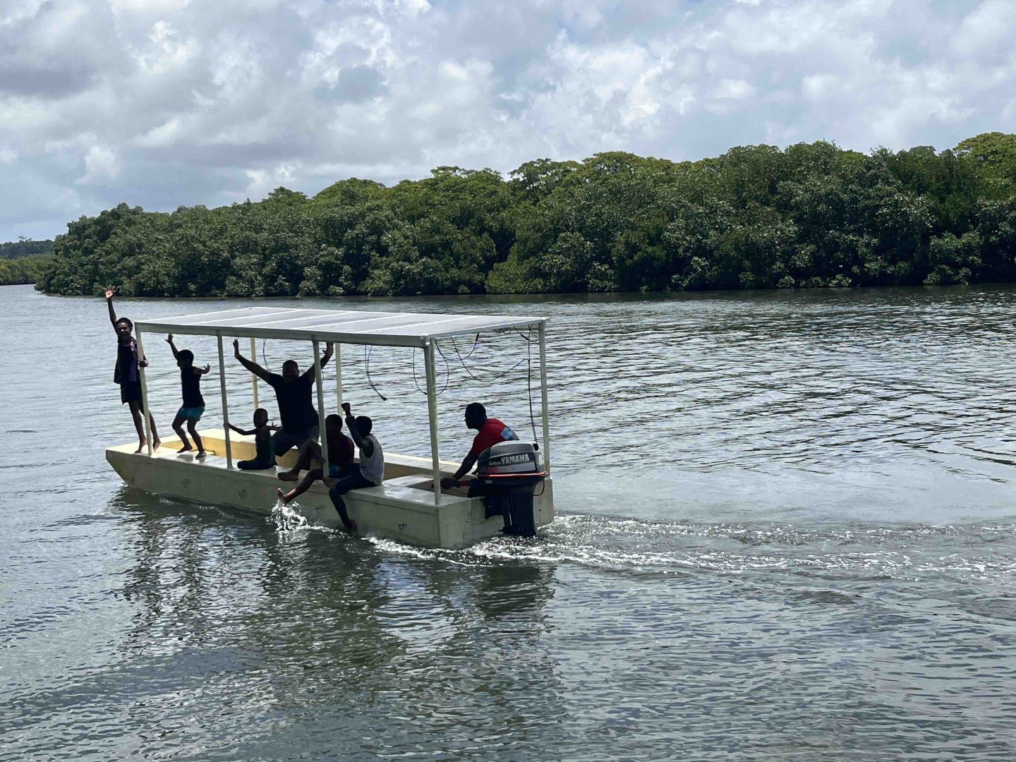

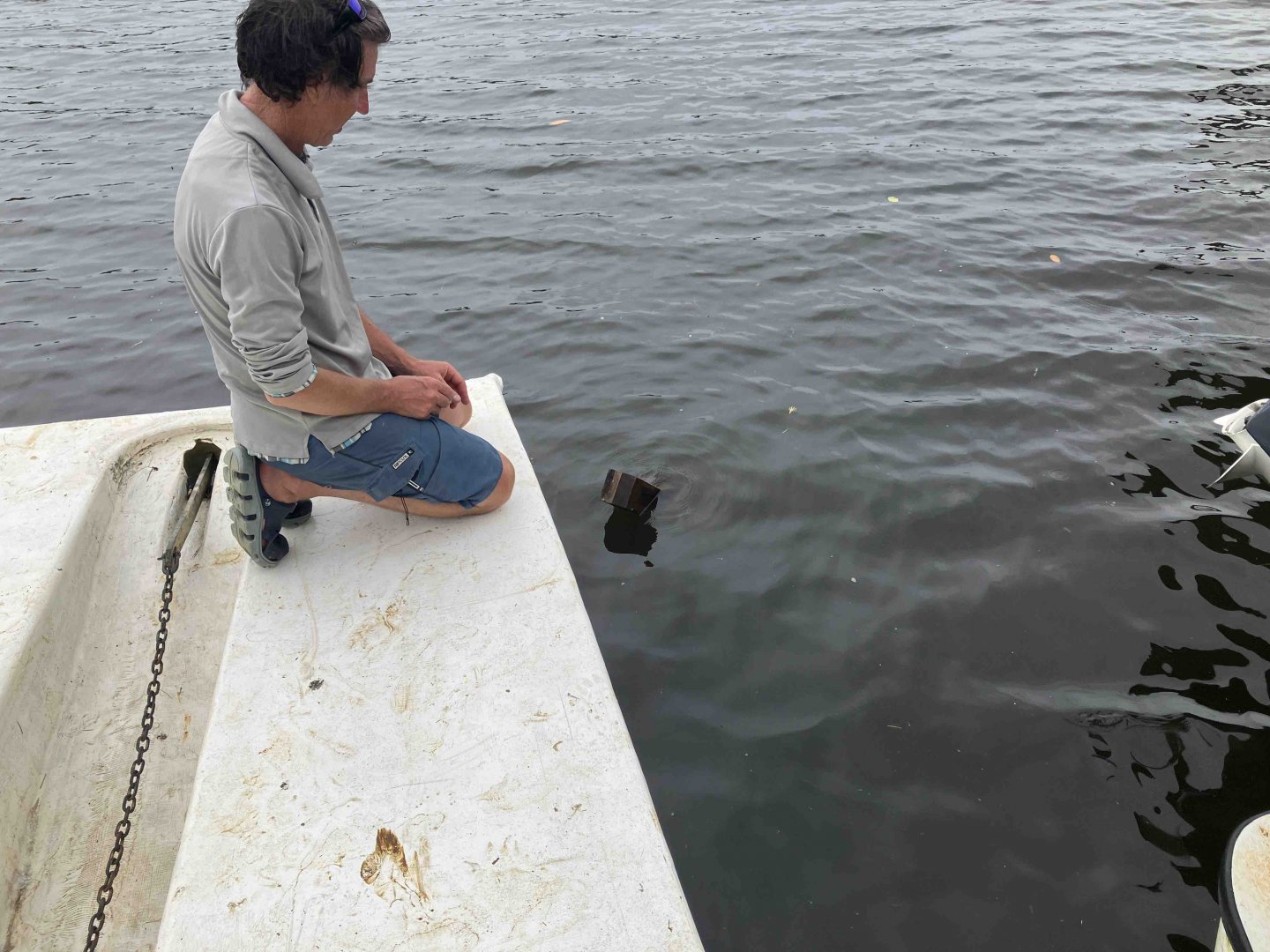

    Zero emission shipping things are starting to happen at CATD. Not least because we have usable boats in the water. One of the upshots of this is an increase in curious visitors, many of whom are doing interesting things, but need sustainable transport to make them happen.
    We fitted the 5 x 300W solar panels to the Rewa water taxi prototype built by the students and powered by the outboard converted from petrol to electric. It worked a treat. The attached photo and video show it operating under 2 of the panels (600W, less than 1 horsepower), no battery. Top speed was 4 knots, with 2 people on board on a cloudy day. We are now waiting for MSAF approval prior to fitting batteries and taking it down to Rewa, a 6 mile open water trip, followed by 9 miles of river. Once it arrives, it will be used by as many drivers and passengers as possible and the feedback will be used to design the production version. These will be built by graduates of the Sustainable Boat Building programme in the new UN Innovation Hub at CATD.

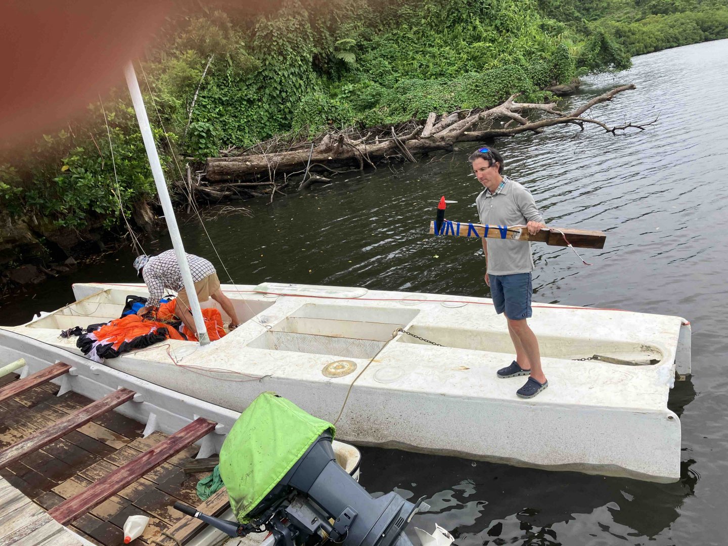

    25 years ago, I realised that kites are by far the best way to use the wind to power boats. Why? They are attached to the deck, so there is no heeling, they require minimal deck gear so they are far cheaper than conventional rigs and they can be flown high where the wind is stronger and more consistent. On the down side, (and what I and many others have spent a fair bit of that 25 years looking for solutions to), they are difficult to launch and retrieve on a small/medium boat, have the potential to unexpectedly quadruple their power output if not carefully controlled, are a nightmare if they fall in the water and have kms of small diameter string which tangles easily.
    I spent a couple of days pre Xmas with old friend Trevor Jack on KitetiK, a 15m harryproa used for testing kite ideas. We used a kite handling system devised by Trevor and a 17 sq m/183 sq' (projected area) paraglider, modified to fly like a kite board traction kite. It took a while to get it set up, (once we mark the lines it will be set and forget) but then we could leave it and steer wherever we wanted to from hard on the wind to broad reach with no one touching the kite. Launching and retrieving was simple, using the mast to hoist and retrieve the kite. Once flying, all the loads were taken by a single strong point on the deck. This is a huge contrast to a sailing rig where the sail force acts half way up the mast and the loads to shape, control and support the sails are an order of magnitude higher than the force propelling the boat. As a bonus, the kite loads are lifting the boat, whereas conventional rigs act to heel the boat and depress the bows.
    17 sq m is about 1/3rd of the designed sail area, not much more than a conventional storm rig. We managed 6 knots top speed in maybe 10 knots breeze (no white caps, despite wind against tide) shunting through 90 degrees upwind.
    This performance and ease of handling was impressive enough to justify bringing Trevor and Gavin Mulvay (kite, electronics, EV's, and a whole bunch of other things guru) over to Fiji to try it on the tender for the cargo proa. Gav also cut and sewed a different type of kite which may be easier to use.
    I had 2 weeks to finish and install a lee (actually a weather) board and a mast (one of the booms for the mini cargo proa crabclaw rig), make a paddle and set it up for steering. The mast's sole purpose is to launch and retrieve the kite. Once it is flying, the mast does nothing and is unloaded, or so we thought.
    The guys arrived and we spent a couple of days sorting things out, doing some test runs, installing the bridles on the kite Gavin made and then set off for Leleuvia, 12.5 miles/20 kms away. A broad reach, barely 10 knots of breeze, with the paraglider/kite from KiteteK. Raising and lowering it was simple using the mast. Pull it up, release a string and it gently fills. How gently is controlled by the string release speed. Reverse the procedure to drop it. Shunting is a couple of seconds of pulling lightly on one line. Faster than the time it took to get the paddle from one end to the other.
    Top speed was 9.6 knots, all went smoothly until the mast broke between the bearings. A function of the small bury (distance between the bearings) waves from the side and a spar not designed for the job. Nothing to do with the kite.
    We spent 2 pleasant nights at Leleuvia and took the boat for a shallow water reach along the beach with a hand held 2.5 sq m/27 sq' kite. Got along at about jogging pace with not much leeboard down. I'd definitely carry one of these (maybe a bit bigger) as an emergency kite. We also test flew the kite Gavin had built (see attached). It needs tuning, but has potential. We jury rigged the mast with stays for the trip back. We jury rigged the mast with stays for the trip back. Repeat of 9+ knots top speed in similar breeze but the stay angle was insufficient, so we broke it again in the cross seas, nothing to do with the kite. We had a play with a couple of hand launched kites, then the breeze died, so we called for a tow to CATD. Gavin had to go home, so Trev and I rigged an inverted Y mast using bamboo. Much stiffer, but we managed to break this too. Definitely a function of the kite this time. We learnt a lot of lessons, not least that big kite techniques on small boats are difficult and kite selection is important. On the bright side, the problems with the masts will not apply to the cargo proa, so we are proceeding with the build of 2 large kites.

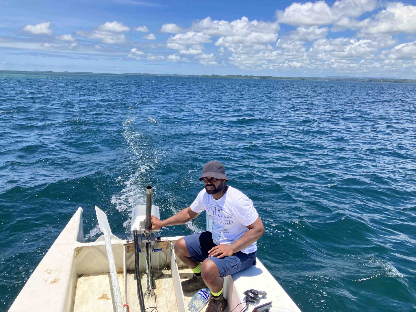

    The tender is an 8.5m/27' catamaran with 400mm/16" wide, double ended hulls, flat bottom and no rocker. It weighs about 250 kgs/550 lbs and draws about 20mm (3/4") empty. A bit more than double both of these with us three and our gear onboard. The draft enabled us to skim over coral with the leeboard up and the steering oar out of the water to avoid having to go round outcrops. Shunting (couple of seconds and almost no effort) meant we could reverse immediately if it got too shallow. A definite plus in this part of the world. Due to the hull shape it is easy to steer by weight shift with the kite attachment point amidships on the lee deck, opposite the leeboard (actually a weatherboard). Move a person a metre or so and the steering paddle is not required. The hull shape also means that drag is unaffected by shape changes when weight is added.
    We were given a 6 kw/8 hp electric outboard and battery in lieu of grant money owed. We fitted it on the tender and with 6 people on board did 5 knots using 1 kw (1.3hp) of power. Impressive enough that both Gav and Trev intend to build smaller versions of the tender. Four of us took it to Leleuvia for lunch, came back in the afternoon, had almost enough battery left to repeat the round trip. Petrol cost and emissions? Zero.
    Top speed was 11.2 knots, which implies the prop is a bit fine, we will test some others.
    The students took the tender for a blast and managed to whack the hull with the outboard, at full speed (see pic). Due to the multiple bulkheads in the hulls, it didn't sink and because it is a flat panel construction, the fix was a 20 minute job with a backing plate and a couple of layers of glass.
    The end result? We are not there yet with a solution to zero emissions small/medium boats, but we are a lot closer than we were with the conventional and wing rigs. The rig works well enough to buy a couple of kites for the cargo proa and see how it goes. There will have to be a lot of disadvantages to outweigh the advantages: no heeling loads, low cost, long life, easy handling (no winches, 2 finger control most of the time), light weight of the kite and mast, no deck gear, easily learnt basics, a simple problem solver mode and sailing with the bows lifted instead of being pushed down.

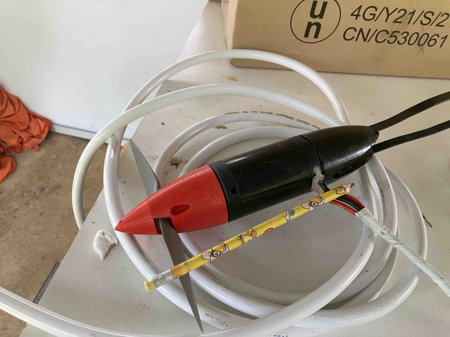

    Gavin had a small waterproof electric motor with a 3D printed housing which he uses to propel his 7m trailer sailor. We mounted it on a piece of wood and used it to push the tender, then dropped it in the water. A floating outboard! (see attached). This type of motor opens up some interesting possibilities for converting petrol outboards, powering canoes and building our own low cost outboards.

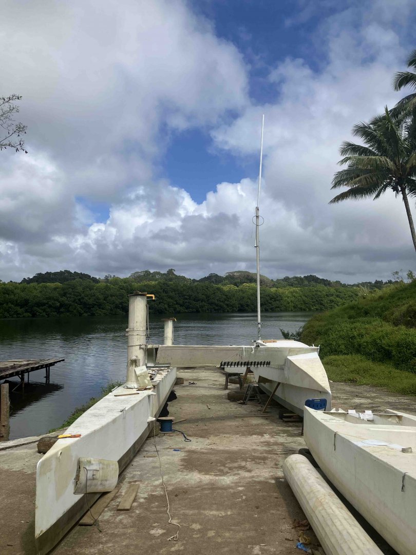

    We've had a bit of a set back, with MSAF not approving the village boats (canoes and water taxis). Not sure how it will end.
    Plastic recycling is picking up pace, but slower than I expected.
    The shed is almost ready for building and classes, with Jim, the kiwi foreman arriving at the end of the month to start building the C50, and hopefully, the village boats.
    I recently spent a week in Brisbane playing kites with Trevor, the owner of KiteteK (15m Harryproa) and Rick Willoughby's 8m trimaran. Trevor has advanced kite power on medium sized boats (too big for water launch, too small for computers) significantly. On KiteteK we got 10 knots out of a 16 sqm kite in 20-25 knots of breeze, with no heeling force. The bottom was weedy and we were towing a SUP.

    Having decided on the kite rig, I altered the boat to make use of the benefits:
    • Chopped the masts down to 2m (enough to mount a kite mast on, if required)
    • Reduced the beam to 5.5m. This did not leave room for the toybox so it was tossed and replaced with a net and walkway.
    • Simplified the rudders by mounting them on horizontal axles on the tapered part of the bow. The blade starts horizontal and clear of the water. As it is rotated (by pulling on a line, no wheelneeded), more rudder is immersed. This allows it to hit things, kick up and be pulled back down without leaving the cockpit. It also allows steering in very shallow water as it can bump along the bottom. The lee board is mounted the same way, but is lifted when there is no load on it. It should be an easy boat to beach and to sail over coral. Apart from a paddle, it is the least complicated rudder arrangement so far.
    • Installed the 6 kw/8hp Epropulsion pod motor on a tube through the small hull shelf. The tube allows for it to kick up for sailing or hitting stuff and to be rotated to push the boat in any direction.
    • Built the unstayed gunter rigged mast and mounts for the kite on the short hull. This is probably not permanent, as my biggest kite is 42 sq m. I'll probably end up with 2 of them on the long hull. The kite in the video in my previous post is 16 sqm, in 20 knots of breeze on a 15m Harryproa.
    This was completed in time for a month of testing. We lost the first week as the students were on midterm break so couldn't launch it. Lost the second week when I damaged my back. Lost some more when the students went on a field trip and then it poured with rain for a couple of days. Ended up with less than a week before the students left the premises.
    16 students lifted/slid the boat on tyres so the mast was over the end of the ramp, which is barely covered at high tide, has a one metre drop at low tide. We strapped 2 empty 200l drums under the mast. This made it much easier to move the boat until we could put a drum under the short hull. Another lift and push and another drum under the short hull, then 2 more under the long hull. 6 in total. Then it was an easy slide into the tide. An interesting learning curve. Next time, it will be far simpler, may not need any students.
    Upshot was the entire boat was clear of the water, bar a metre of the short hull, due to the motorbeing aft of centre and uneven drum spacing. Total weight about 1,200 kgs/2650 lbs. Still got 8 kwh battery (75 kgs/165 lbs), 4 x 575W solar panels (130 kgs/286 lbs), rudders and daggerboard (30 kgs/66 lbs), kite and mast (40 kgs/88 lbs) and safety gear to add, so a bit more than 1,500 kgs/3,300 lbs ready to work. Not bad for a 24m/80'ter with mostly solid glass hulls.
    We loaded the battery and installed the rudders and took off down the river. The rudders worked, but the temporary steering system was a bit too temporary, broke and we ended up in the mangroves. The water taxi with 8 hp E motor and photographer on board pulled us out, we strapped the taxi to the cargo proa stern and used it to steer us back to the ramp. The joys of testing new ideas. Top gps speed was 8 knots 2 min average with the throttle just engaged, according to the throttle man. Not sure how much 'just" is as I was organising/breaking the steering. Photos and video are all on the photographers phone with a cracked screen which he dropped in the water.
    I intended to repair the steering and have another go, but the students had exams and we ran out of time. 30 of them (approx 2.5 tons) piled on board and the top of the 200mm deep antifoul was just showing. 10 tonnes load will only be for sheltered waters, and will be shared by both hulls. Normal use will be 'small quantities often' as opposed to the 'large loads occasionally' model the ships use. The students then picked the boat up and carried/slid it up the ramp.
    I have made some adjustments to the motor mount and am pondering the steering arrangement.
    I am visiting Aus next week, will be back and ready to relaunch and resume testing when the students arrive in February. There is a bunch of other stuff (some good, some bad) going on here which hopefully will be clarified by then.
