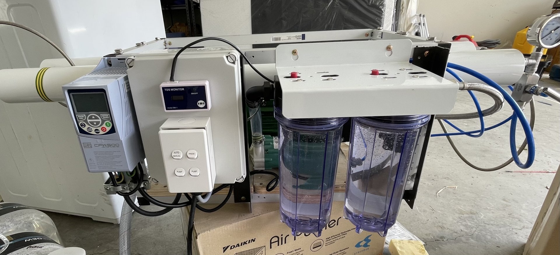

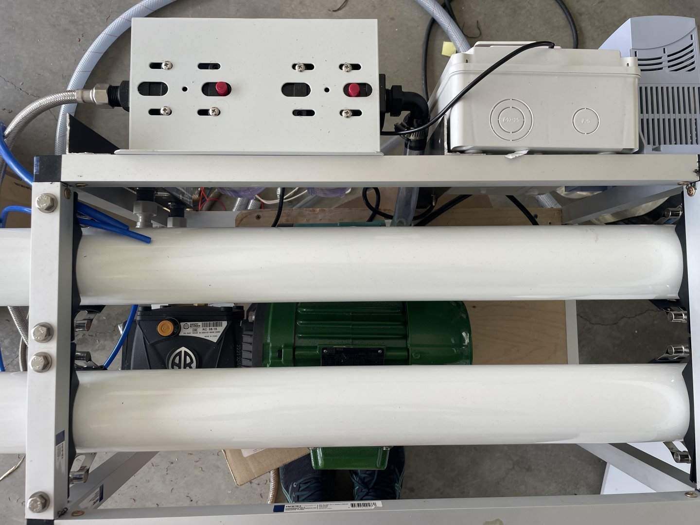

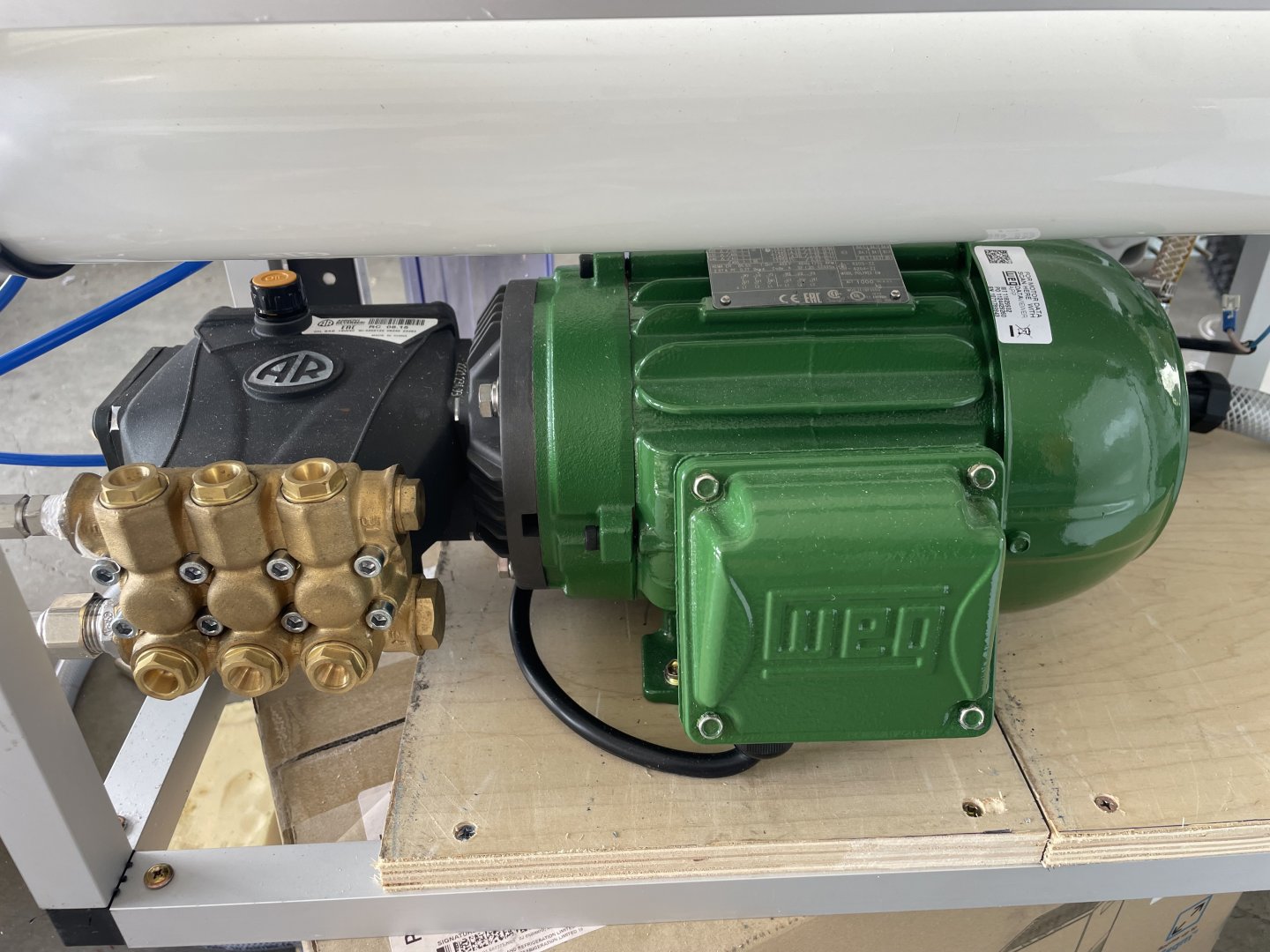

    Little bit of a side track , but I built a Watermaker for the boat aswell,..
    Runs from the house inverter, and utilitizes a variable speed drive and 3 phase AC motor for variable flow rate and variable power consumption. Also has auto flush etc and will be controlled from a remote push button panel in the saloon.

    Nice project groper, thanks for sharing. I have a question about the watermaker pump, is it a bronze or a brass body? If it's a brass body did you get the optional ceramic pistons?

    It’s a brass body with ceramic pistons . I honestly don’t know if it’s worth spending thr big $$ on stainless pumps, the first Watermaker I built 10 years ago I used a SS cat pump only to sell the boat less than 2 years later. So my investment in a top dollar pump was all for someone else’s benefit.
    Then I met an ex navy engineer in turkey where we built another for the boat I purchased over there, and he convinced me to use cheap Turkish brass pump which worked flawlessly for another year until I sold the boat once again . After that I was convinced that unless you plan to keep your pump for 10 years or more - why spend big $ for something you’ll never get thr full benefit from?
    And even then - will a rebuild of a SS pump cost more than a new brass pump ? I don’t know….
    But thr brass pumps are so much lower in cost I think you could replace the entire thing 3 times before you get to thr cost of a SS pump. Not that you’d need to, all thr parts are available worldwide for my pump anyway…. With a freshwater flush on every cycle , I really don’t see the need for expensive pumps , it’s just doesn’t make economical sense …

    Rumars Senior Member
    Thanks, that's what I thought you did. The freshwater flush is mandatory, but even so I recommend taking the head of every year and looking for signs of corrosion inside. It's good maintenance and cheap insurance.

    A brand new HP pump is only 230eur! I don’t really care if it dies :)

    It's not about the price, it is indeed cheap enough, it's about the thing not failing unexpectedly and spraying salt water all over the motor, electronics and whatever else may be in the vicinity.
