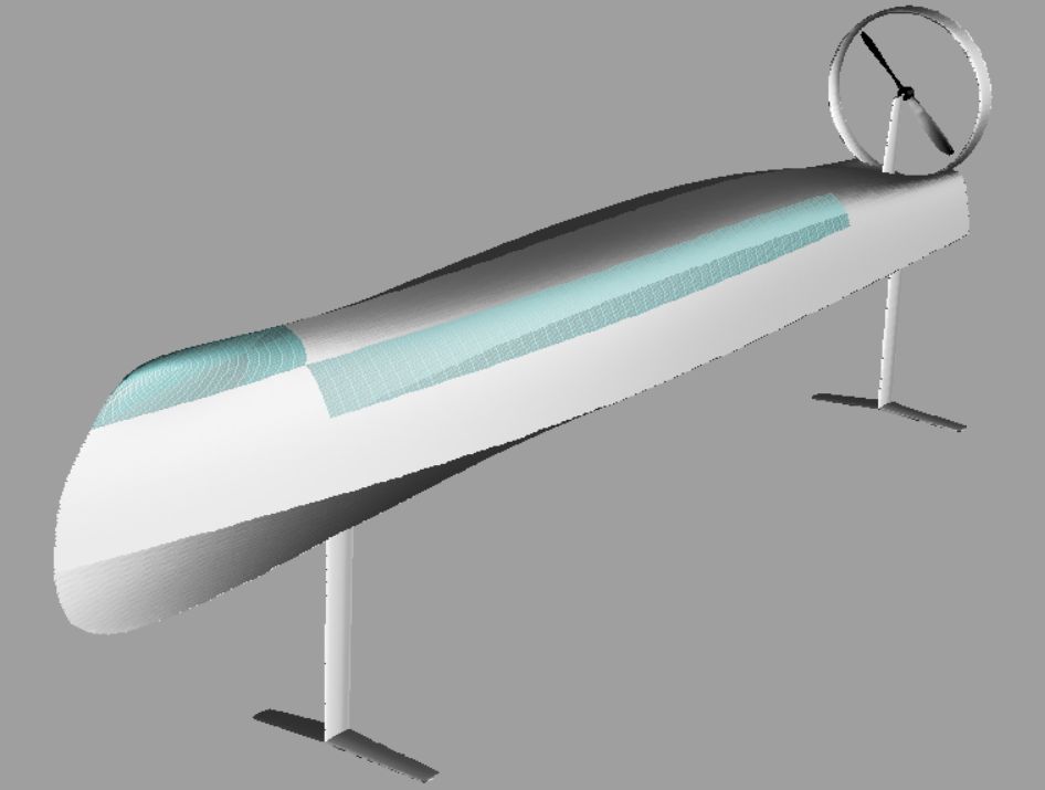

  6. myszek
    Joined: Jan 2013
    Posts: 109
    Likes: 50, Points: 28, Legacy Rep: 22
    Location: Lodz, Poland
    myszek Senior Member
    Yes, SES is another possibility to achieve 50 knots and acceptably smooth ride.
    However, we still don't have some crucial information:
    • The purpose - is it a ferry to transport passengers from one place into another, or a boat for an extreme pleasure ride?
    • The range - A short ride to and fro? A several miles ferry? A hundred miles?
    • The sea conditions - wind speed, wave height?
    • The harbor limitations - width, depth?
    Meanwhile, just for fun, I sketched a 50kn hydrofoil for 60 passengers. Something like this:
    20m long, 3m wide, 3sq.m of total foil area, 3m draught. 15t displacement. Air propeller used at speed, plus Z-drive for low speed maneuvers. Six control surfaces at the trailing edges of all foils, controlled by a computer system.
    Surprisingly, she would need only 600hp to reach 50 knots, so even the 1000l tank provides a reasonable range.
    Better not to mention the cost...
    regards
    krzys
    TSD Joshua and Noah Stone like this.

  15. BMcF
    Joined: Mar 2007
    Posts: 1,237
    Likes: 226, Points: 63, Legacy Rep: 361
    Location: Maryland
    BMcF Senior Member
    The first is simply an electric-powered version of a catamaran foil-assisted with one of Dr. Hoppe's systems. Lots of those running around diesel powered these days. The second...well...lots and lots of magic has to happen between the 3D rendering and an in-service craft.
    Designing foils to operated cavitation-free at 50 knots isn't that difficult if you are a foil designer. The tricky part is to design a cav-free foil system that will also support take-off at full load....full load needing to be something economically viable.
    TSD Joshua, gonzo and bajansailor like this.
