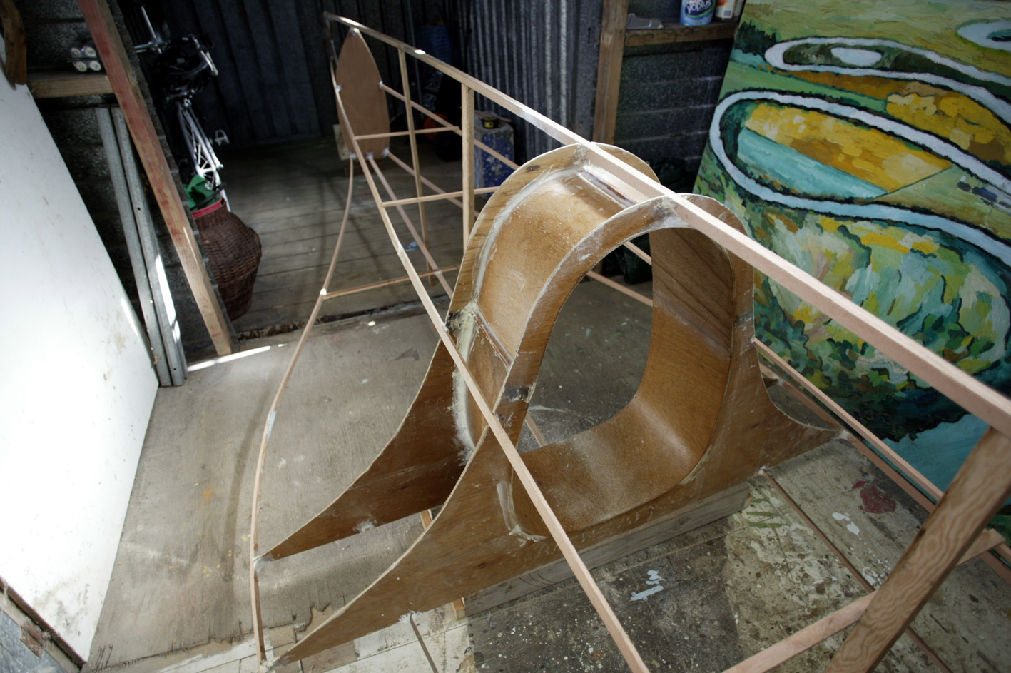

    Gary,
    Thinking aloud here, humps idea is awesome but separate points for reinforcement. With the central pivot, would that also incorporate the mast step ?

    Losing the cabin could be a deal breaker in such a small boat, I hadn't realised you had one.
    The single beam will be supported at both gunnels, but the bending moment will only be resisted by the gunnels if the central bearing allows the beam to bend in the middle, which the described constructions didn't sound like they would, hence the beam and the boat would need to be strong enough to resist the resulting reaction force.
    I would build the split beams in the same manner as a single beam - a ply box with some carbon ud on upper and lower faces, plus around pivot points, which I'd use a block of timber between faces with a suitably sized bolt hole through. You can taper the inner portions of the beams so that when unfolded they look homogeneous.
    There is some redundancy in the split beam design, so do check your weights before committing to it.

    Yes, the gunwhales would need plenty of carbon, loads would be high there, especially when Sid650 lifts off and flies on uptip foils, eh Doug?
    But same would be necessary with single beam. Sid 850 has uni directional carbon towes running from gunwhales and around the double ring frame to the halfway stringers. After 18 months; no problems there.
    The cabin is very small on S850 and S650 would be similar size if with the single beam. I'll do some more sketches. Check out photograph of Sid's cabin? placed aft of the box section of main beam.
    The mast step? That is tricky on the scissor? setup. On my original single beam the central bearing with the mast step on top of it makes one single structure. Which pivots with the main beam. And I like that simplicity.
    Whatever I do, the gunwhales have to be beefed up, either to take locking pins or Hump's bearings.

    The mast step could sit between the two beams, but then the boat would need reinforcing at this point, negating some of the benefits of the split beam. Not such an elegant solution, I agree.

    I still prefer the "kiss" method. I like the split beam idea a lot! I think on a bigger boat that was semi cruiser and would be taking on extra weight and nick knacks anyway, it'd be worth it. But to engineer yourself into a hole for something that just has to swing out the way for storage might not be prudent. In single mast and bearing setup it need zero strength when swung, it just needs to be strong when out. That should be do-able when it's all happening in a single location.

    Barry, I'm leaning towards the original single beam because although I really like the brilliance of Hump's split beam design, I see problems too.
    On Sid 8.5 there are two diagonal water stays (hollow, airfoil shaped, carbon reinforced) running from below the shroud connection points (approximately 4 metre total spread on main beam) to the double ring frame inside main hull. More carbon at all the junctions.
    Because Sid 650 has a proportionately wider hull and greater flare than the 8.5, was hoping that the wider base might allow me to NOT have water strut/stays ... but also know that you breath easier when the gusts come through with the struts because the rig loads are carried around the triangular stayed setup, keeping the platform from flexing and in one piece. Your suggestion of outer wing folding/turning? - I see too much engineering required. Je suis une garcon rural.
    If no water stays, there will have to be heavy carbon laminations to stiffen/strengthen platform. Prefer the KISS principle of the stiff water stays.
    So the two Sids will have the Jan Gougeon approach as seen in this photograph of his conventional two beam 25 foot design - but only one strut per side. Notice how fine the two beam thickness is on his design; this allowed because of the water strut stays
