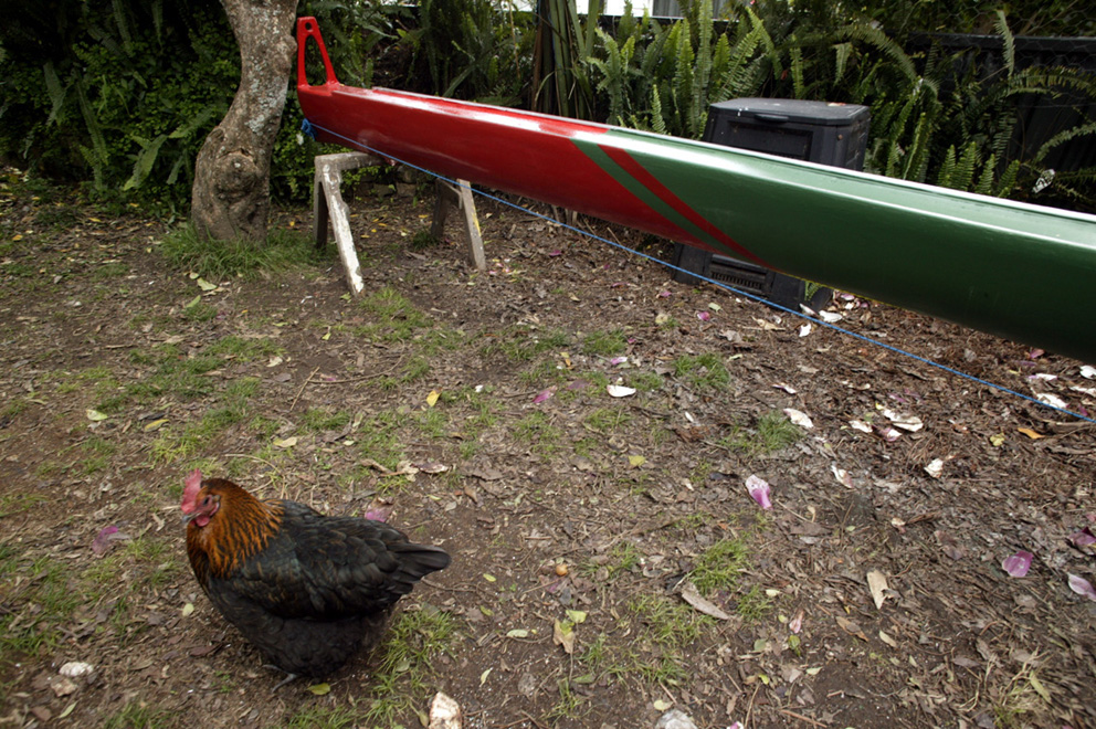

    D mast finished, weighs 26kgs with all rigging. Chook is size reference to prove that this is full size and not a pond toy?

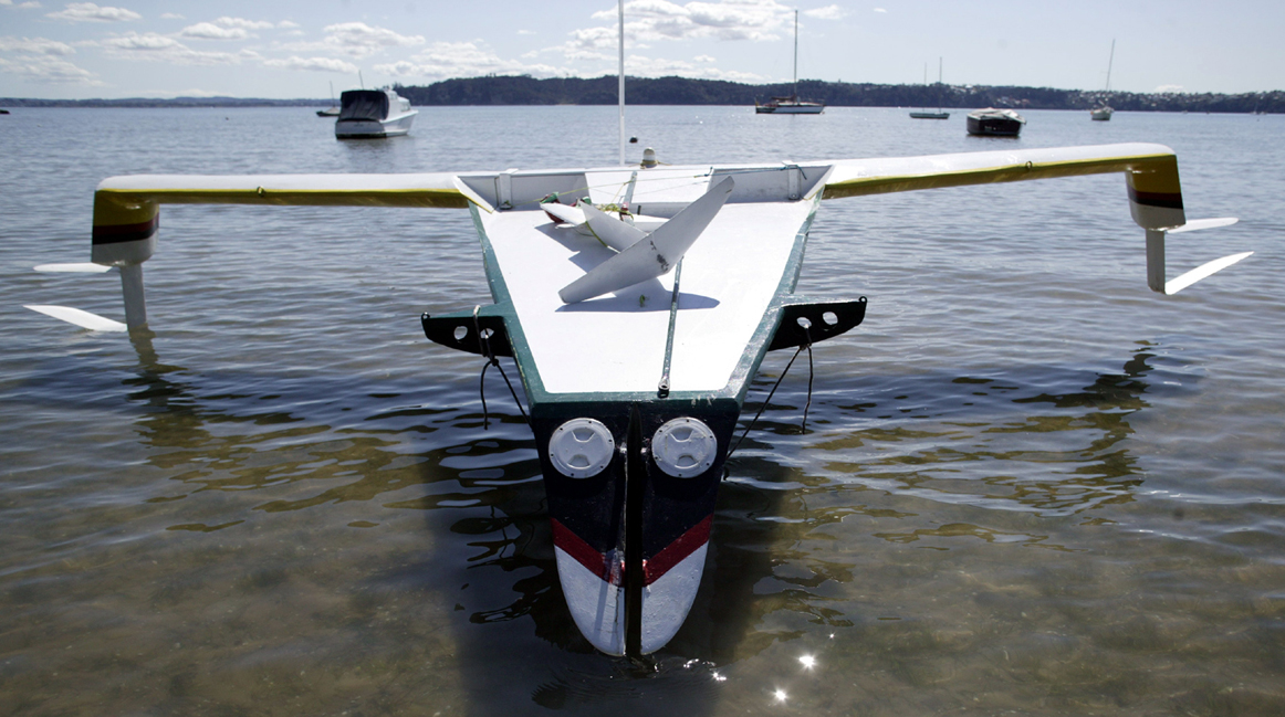

    Gary Baigent Senior Member
    I've built two airfoil shaped thin ply and carbon stays but haven't fitted them - and with the Frog floating I'm a little surprised about the deck and beam main hull width and support and ... the boat has shrunk once in water so I'm thinking that maybe, I don't need those supports. Anyway the first few times sailing will be in light winds and I'll be able to see/feel if the structure is robust enough to carry the various rig loads. The stay connecting positions are halfway out on the beam so that is not a large cantilever distance, see already posted photograph.

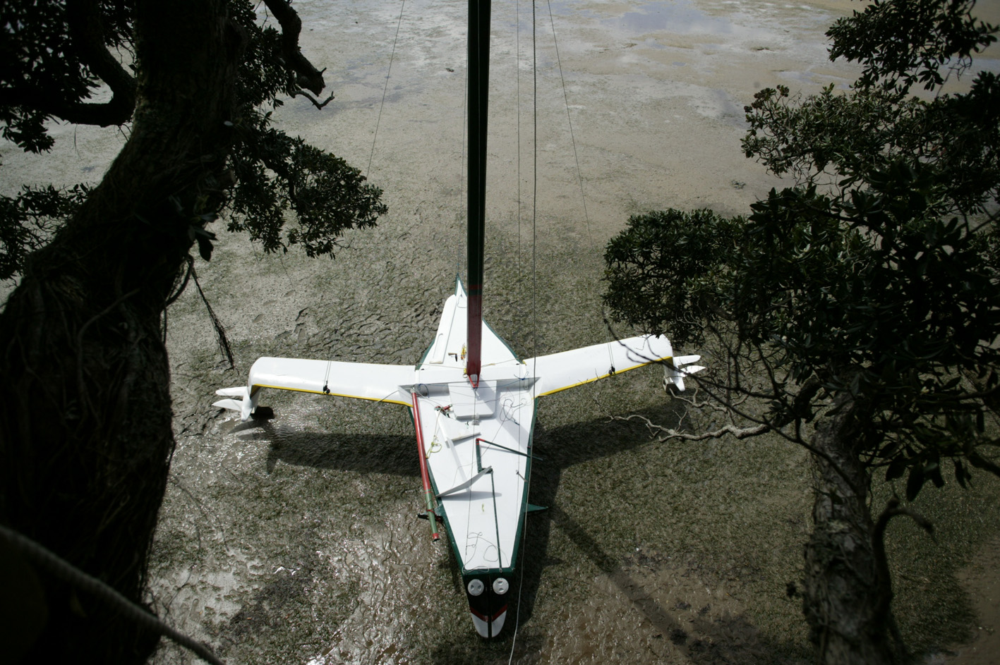

    Finally got the Frog's D mast up.
    Had an interesting visit from the owner of a Newick 40 trimaran with half moon floats; he may come over to Cox's and use my very high tech pohutukawa tree to drop his mast and make a few changes.

  6. cavalier mk2
    Joined: Mar 2010
    Posts: 2,123
    cavalier mk2 Senior Member
    Hoy Gary, that looks like a Limmershin. Do tell. I like that design and want to know if the new moons are worth the effort.

    jamez Senior Member
    According to the owner the design is a RACA 40.
    (There is a Limmershin for sale up north)
    http://www.trademe.co.nz/motors/boats-marine/yachts/multihull/auction-1086159906.htm
    I asked DN about the half moon amas when he spoke at a club night a few years back. He reckoned they worked well but were more complicated to build and didn't fit the fashion for bigger floats. Most of the examples I have seen here with these floats also have lifting foils as well.
