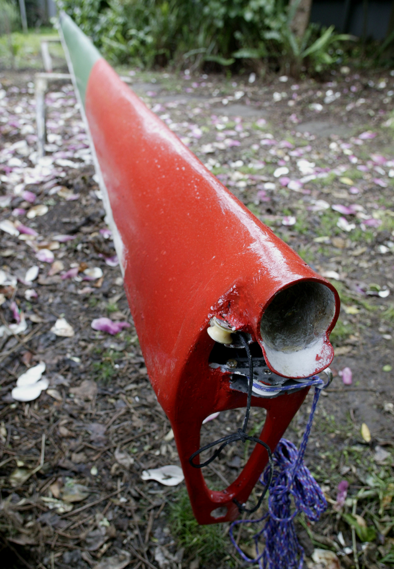

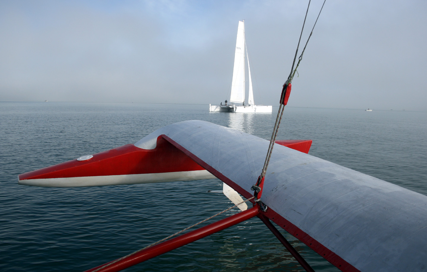

    You can go back to late 19th and early 20th Century aircraft/glider wings, same principle, airfoil shaped leading edge followed by doped canvas over frames and stringers. Only difference to a D shaped leading edge double sail rig is that the following assembly has to be flexible. But not as flexible as a conventional mast/wing mast/single sail rig because the double rig and D shaped leading edge does not have to rotate as much ... because the windward sail fairs the wind flow better without the stagnant bubble immediately aft of the mast. See photograph of Groucho's mast setup for light air windward sailing. That is quite a lot of rotation - and the more rotation (for reaching/running) the larger the draggy to windward bubble.
    Frog's rig bearing is set at the very front, not a third or so of the way aft as on my other masts. Meaning it doesn't have to rotate beyond, say, 40 degrees - and probably less. Will find out soon enough.
    Laying/gluing D frames and stringers out in my shed right now.

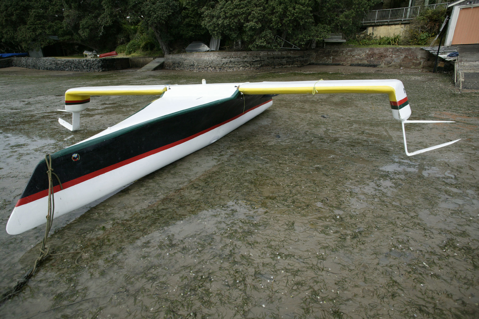

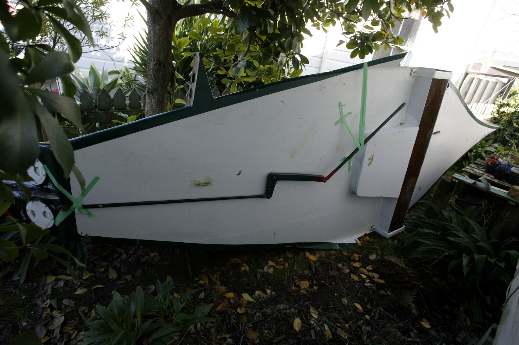

    Have been ordered to shift THAT boat out of the backyard. So cruel, so selfish - meaning her, not me. I mean the only time "she who must be obeyed" goes down the back section is to pick a few herbs from MY garden. Life is hell.
    Anyway the platform has been finished and it is time to move. The D shaped leading edge mast is ready for skinning and the design of which is undergoing sophisticated thought and mental fine tuning - how can we, Bill Barry and I, fail - and the weather has improved dramatically here too. The shining cuckoos have arrived very early from the central Pacific. Maybe that is telling us something?
    So here is the Frog parked on its side in the narrow confines between house and fence (some radical tree pruning and considerable time was required to achieve this success); the beam is out front ready to be loaded and both are to be trailered to the sparkling Waitemata, bolted together and placed on a mooring while the radical mast is finished.

    Yes, just chopped off at the central I beam position and the two tracks attached each side. I've tapered the above hounds mast areas. athwartships and fore and aft ... so I'll have to use two halyards for the main (because of the narrowing of the tracks there). Bill is going for a single halyard on his design with, I presume, a strut across to the sail peaks and therefore no taper to the mast.

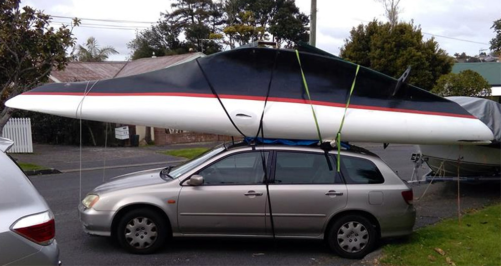

    Shifted Frog with help from Eric Eason. Frog appears to overload the poor car but actually the amphibian's main hull weighs only 56kgs; so the two of us just lifted it onto the racks. 4th photograph of 8.8 metre D mast.

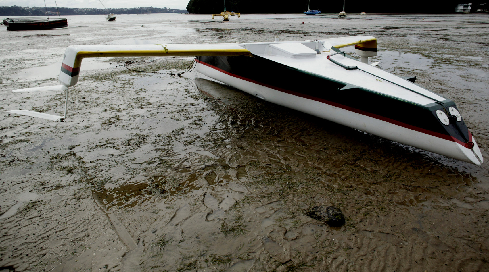

    Frog afloat in shallow water; hope to have the D mast finished this week.
