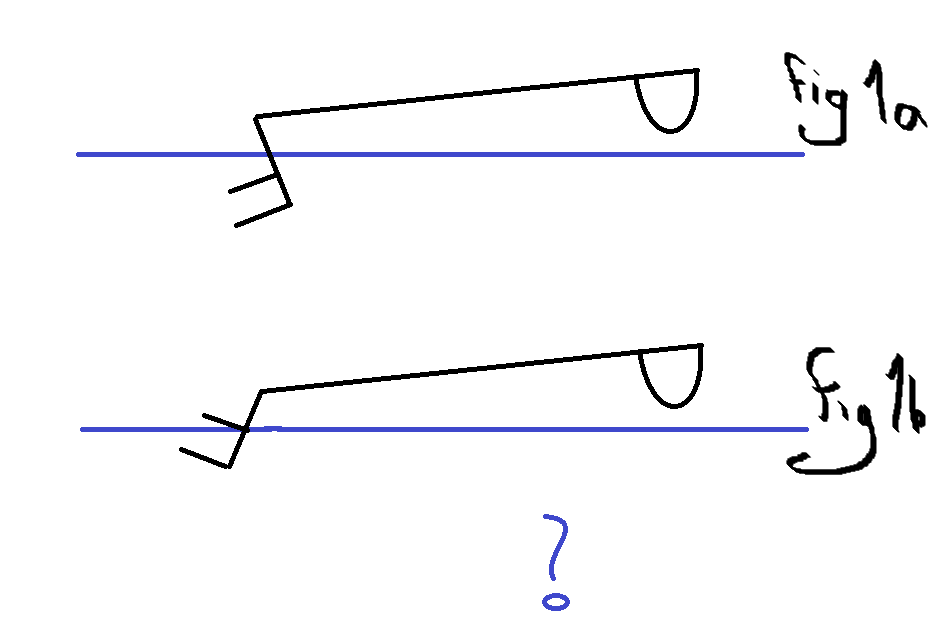

    I think your angles are more like the uppermost drawing (fig. 1a), is that right?
    So then the 'rungs' will lose lift when the the leeway increases due to reduced strut span when flying higher.
    And then, flying even higher, the top rung will breach, hopefully letting the bottom one stay at a decent depth.
    Ladders have been used in several different ways, some motor craft had superventilated bottom rungs and subcavitating upper rungs. The upper ones would be in the air at speed.
    I could see the opposite being used as well, a superventilated surface runner top rung limiting the depth of the subcavitating bottom rung.

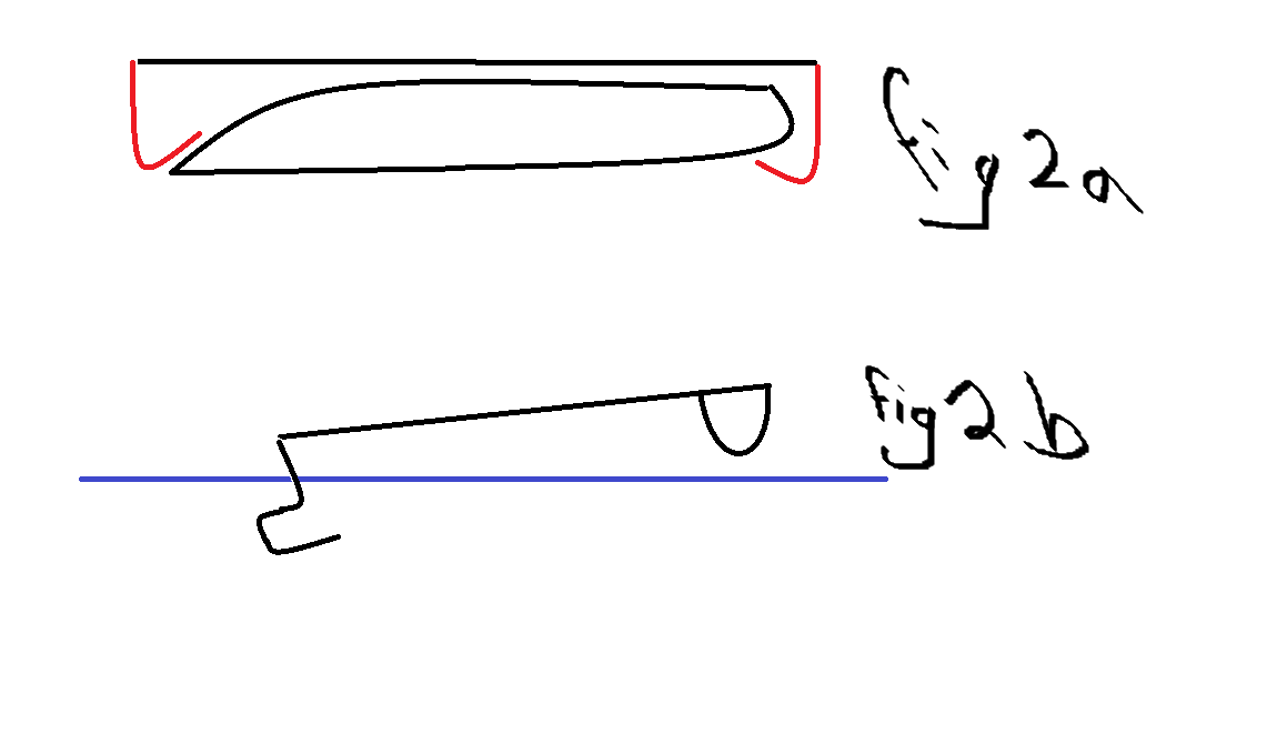

    Could inward pointing J also work on Frogs? (fig 2a)
    The ? foil in fig 2b is just a more hightech version of the F's: weaker, but no junctions with their drags and pressure peaks. Also the bottom corner has continuous lift over it, unlike the F where the pressures are reversed over the corner.

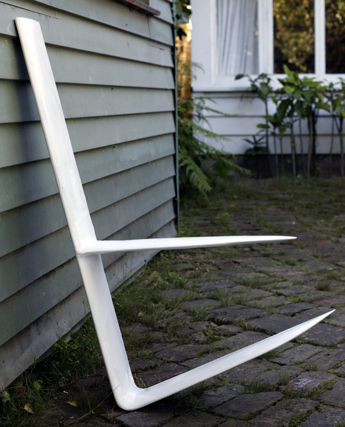

    This is the port foil position while under sail power. The shed wall, so to speak, is the minimalist float positon; it slopes outward a few degrees on the Frog so that under power and heeling, the float approaches the vertical.
    At rest the upper foil position will be sloping downwards a few degrees. I didn't want uptip here because I want it to clear water surface in one movement, lift and then when clear, no drag - whereas the lower immersed and main foil will have uptip (for practical reason of boat drying out on the hard - no damage to foil tips). I've learned this the hard way. Also Frog has a main hull dagger: I'm not relying on the near vertical sections of the lifting foils to counter leeway. This is same setup on Sid. Which works okay.
    Frog's out-facing foils are to maintain the widest beam measurement when foiling whereas in-facing create less overall platform beam and therefore less stability.
    Also for trailering, the 6.5 metre beam Frog, with the beam rotated fore and aft, the out facing foils and floats will not foul the main hull bow and stern. To have in-facing foils would require a 7 or more metre beam - which I thought kind of impractical ... being a sensible and practical person?
    You have to remember the Frog project is not AC stuff with cranes, full wings and million dollar deep and adjustable carbon foils etc - but a somewhat crazy little boat that can be trailered and also sit on a beach.

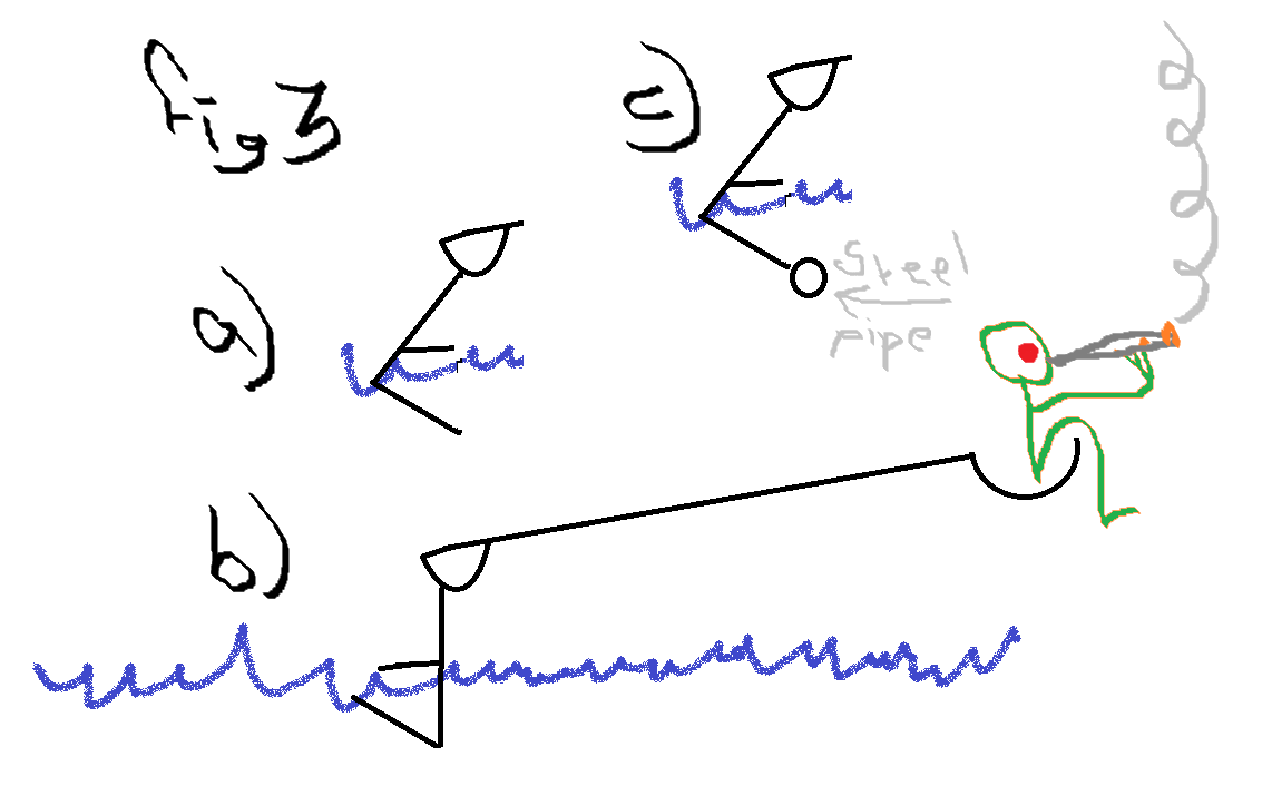

  4. sigurd
    Joined: Jun 2004
    Posts: 827
    Likes: 8, Points: 18, Legacy Rep: 65
    Location: norway
    sigurd Pompuous Pangolin
    Thanks for the pic and explanation, I understand better now.
    You do get to rest the boat on the knuckle of the foil. What every other half V foil (ref. your pics post #301) gets to do is to taper the board so that the chord reduces as the span leaves the water, reducing profile drag. But yours has an increasing or constant average chord as it lifts.
    Illustration shows that with the same horizontal foils, if you move the strut to the outside, the beam is the same and the aka is the same length and the RM is the same, but you get the strut out of the water and main foil can taper like I mentioned. So I don't get what you mean in the quote. But sure enough, fig 3a can't rest on the knuckle. Sonic tube?

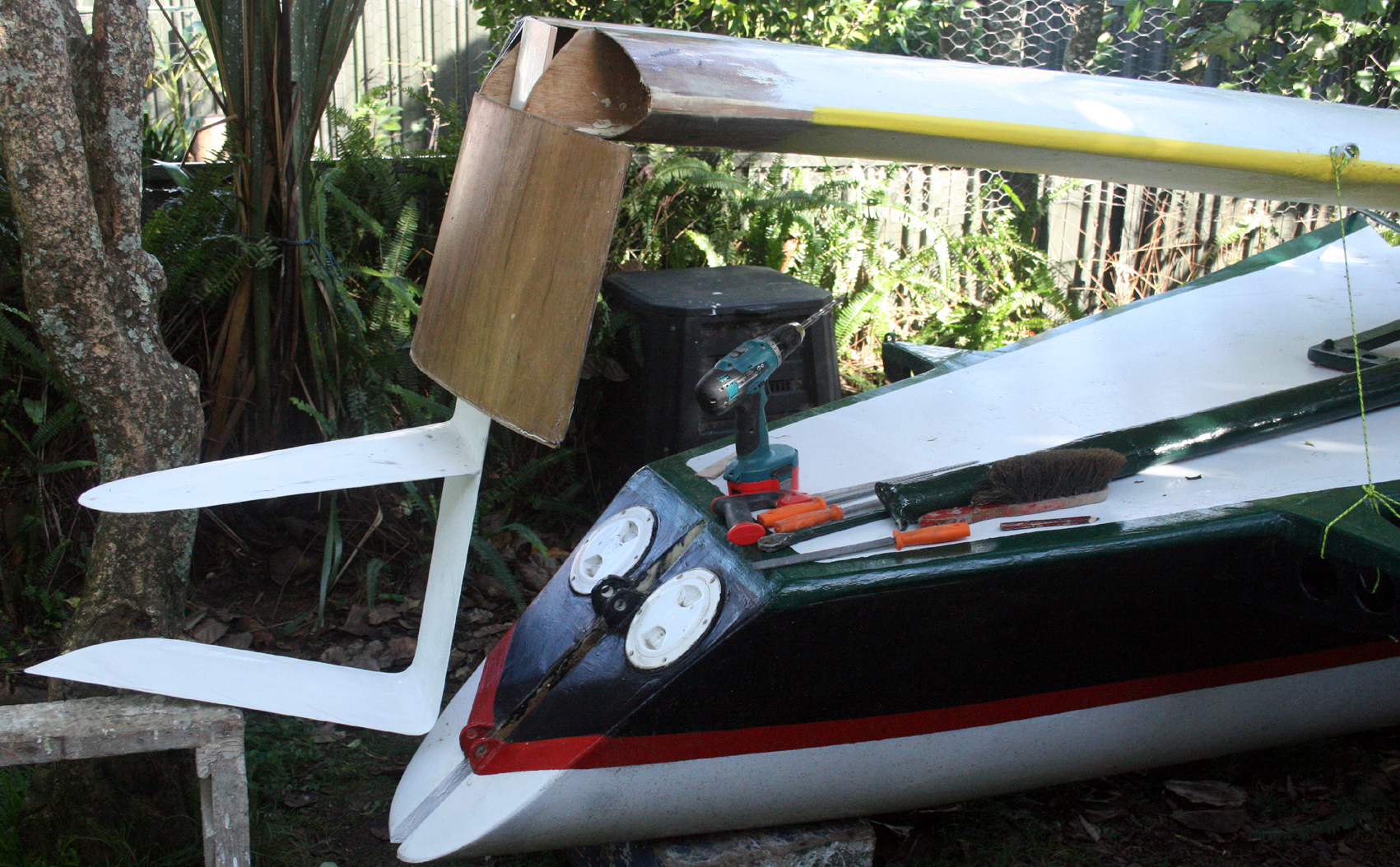

    Crude mockup of Frog's float? and foil. The float will have built up foam/glass at base, shallow half moon shape tapering to fit around the foil. I'll also use foam/glass to shape curves to the end of beam/float junction; float will be spread wider at this point to fair into lower beam section.
