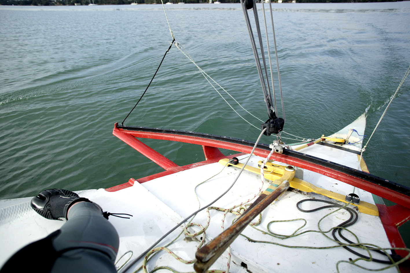

    Ha. Unfortunately they've flown back to 'straya. But you're right about the filming expertise; their father has his own movie business but it's in animation (Tui Studios, Kiwi in Os stuff, eh! Sorry, explanation: Tui is Maori name for a beautiful NZ songbird) - but you're right about the arty farty ability being in the family. However my stuff is heavy reality and not fantasy, like my boat designs. Just joking.

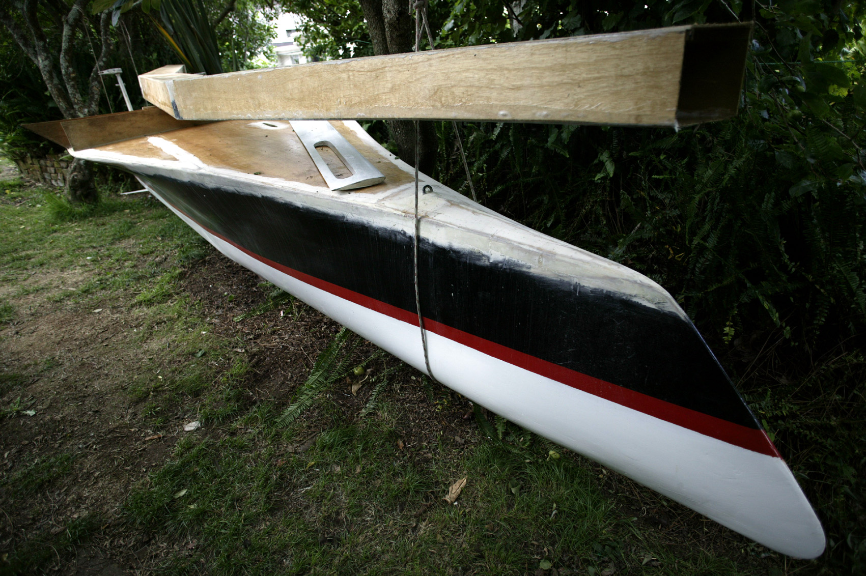

    Another shot; set up the beam box and hatchway.

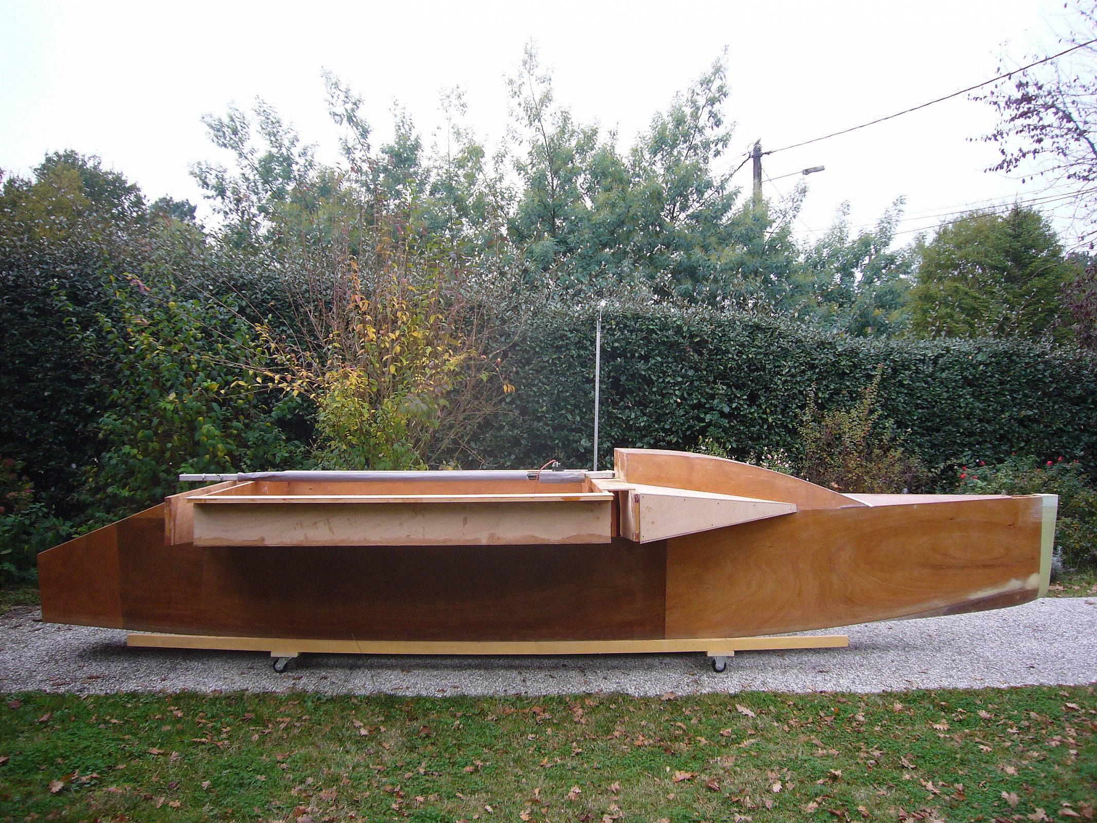

    Rough checking the 650's box beam; think I'll crank it forward immediately it leaves main hull deck; if I continue it out further, as shown, before raking forward, may look too strange, like a broken leg? And this strange foiler is going to be strange enough.

    Really not sure if the lot would fit in, not necessarily I guess, this picture was taken during coffee time:roll eyes:
    Still having difficulty to see how the end result is going to be and who am I to question but you have a specific reason to make the box beam so narrow on the hull?
    Wouldn't it make the structure more weak at a point where lots of forces come together?

    Actually thought I was being conservative; the box beam is rather big compared to Sid's: the 650 is 200 x 250mm height/beam - and then the aerodynamic sections go on fore and aft- so it ends up a pretty large beam. Sid's is 250mm height, bit narrower in box beam, see image. Also Sid's overall beam is 8m whereas the 650's is going to be around 6.5m.

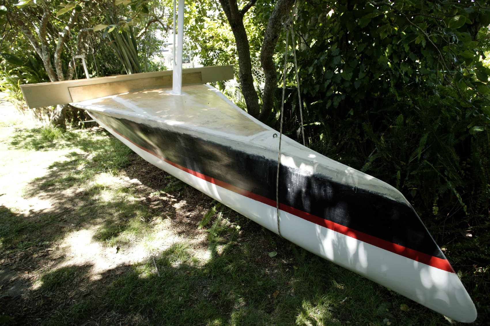

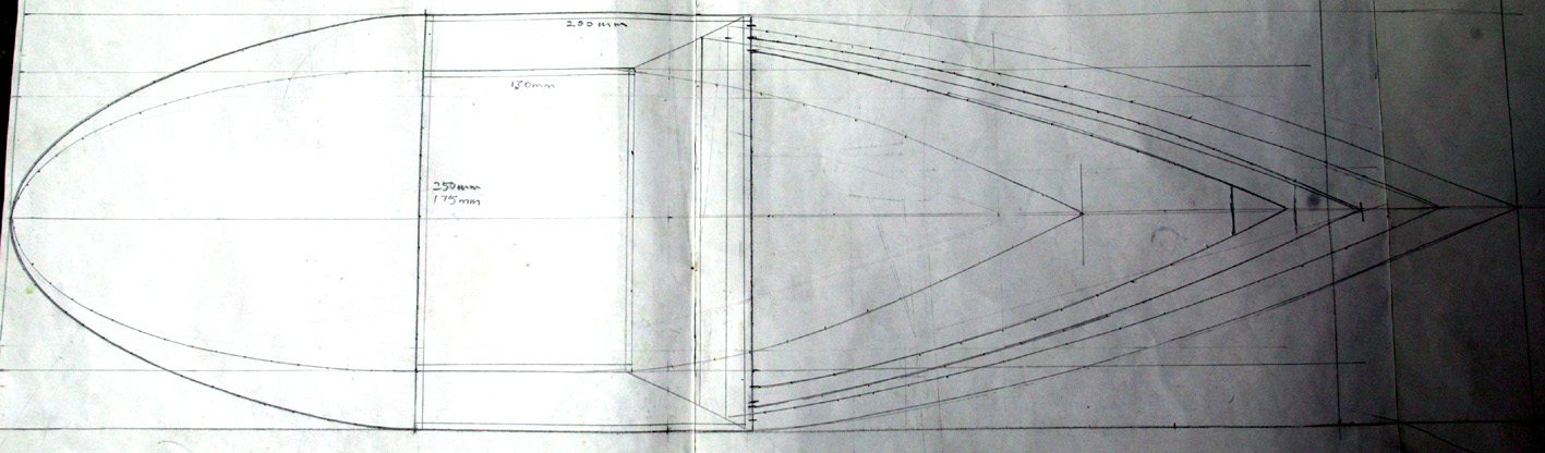

    Building box section of the 650's 6.5 metre beam. The final airfoil shape will be pretty much like Sid's beam in cross section shown here. Oh yes, there is slight dihedral each side of the central box ... for aesthetics? The central box remains a box (so to fit the open case on main hull deck) - while the angled forward beam outer sections will be airfoiled.

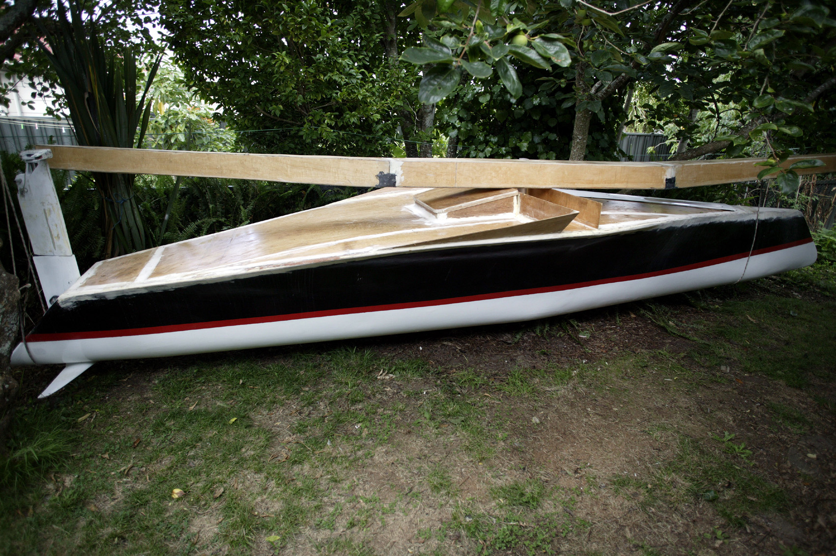

    Hi Gary,
    Looks like you cut the aft part of the mainhull or is it a pictural artefact ?
    Did you weighted the mainhull ?
    Patrick

    Patrick, I think you are mixing up Sid with the 650; Sid has the long and pointed transom whereas the 6.5 has a higher, less angled shape. to gain some miniscule accommodation area.
    I attempted to weigh the new hull but my scales have broken, probably from trying to find the central balance point under the hull; I guess it is around 75 kgs with rudder and daggerboard.

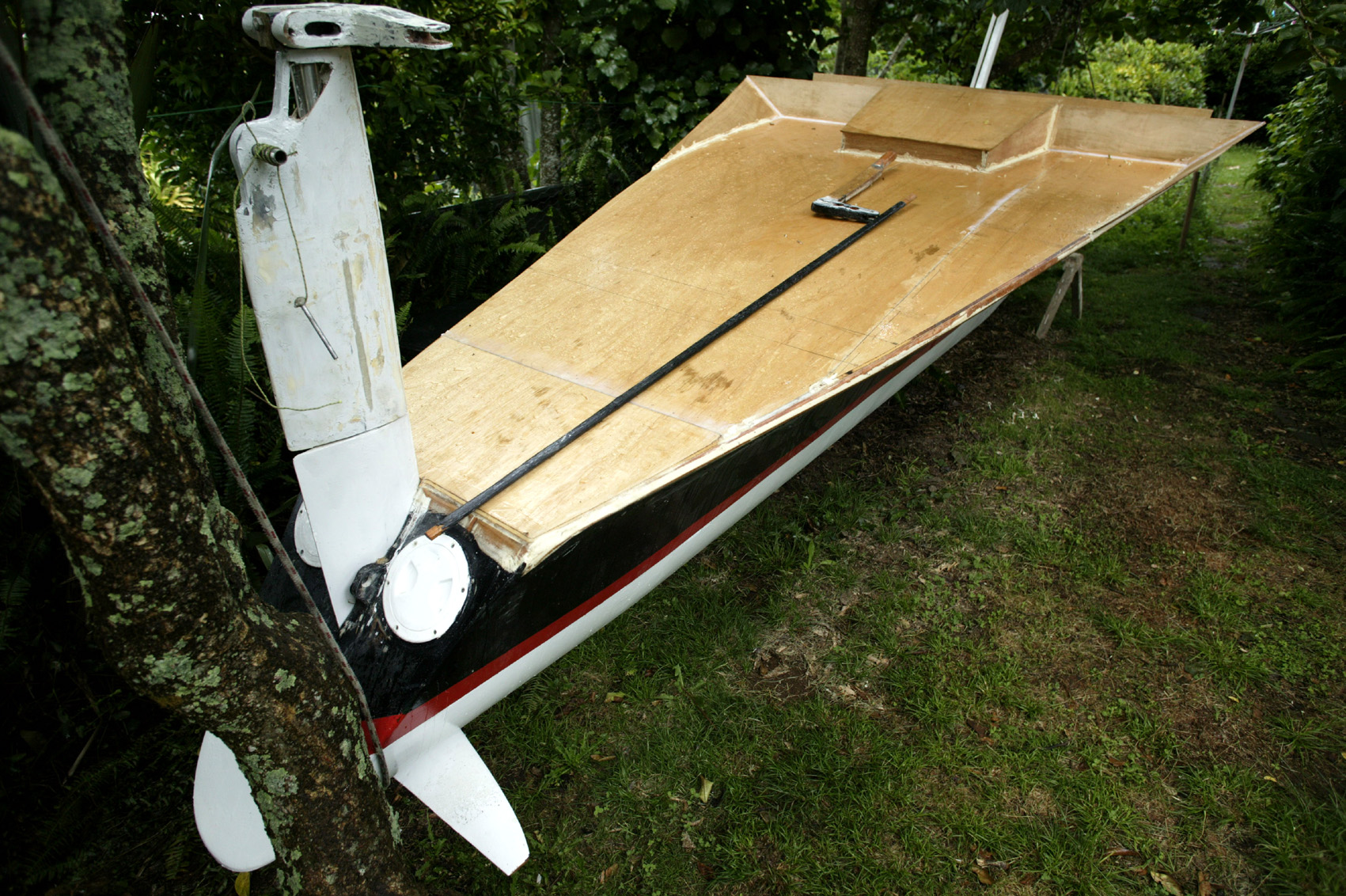

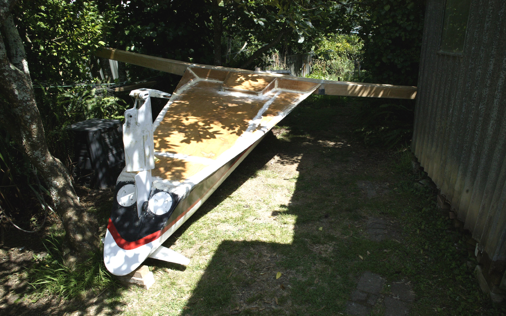

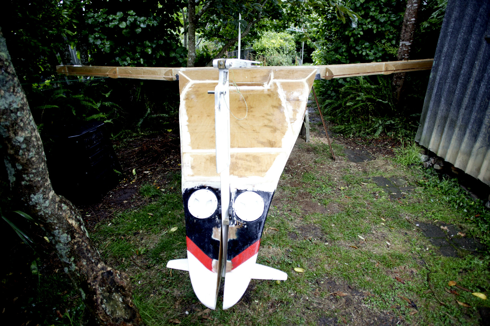

    Here's the swivelling beam roughly in fore and aft position for trailering. The next two are of beam in place with bearing epoxied in place. Have started cutting out the airfoil section frsme attachments.

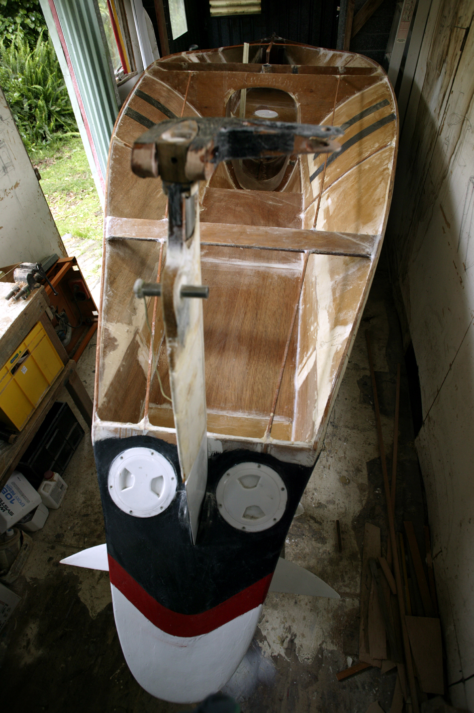

    Had to alter the rudder setup because with the beam swung, the lifted T rudder assembly was too high and with float and foil, would foul the beam. You can't remove complete rudder because of the horizontal lifting foil, that is, unless you go for a swim or hoist the main hull up high. So I bit bullet and sawed an open slot in transom and cut away the back end of case, then sealed each side. Now working on the pin system of the thin rectangular box to fix the rudder solid when in place. You can see where I've ground paint away for the pin fixing points. Also fitted the airfoil frames to the beam.
