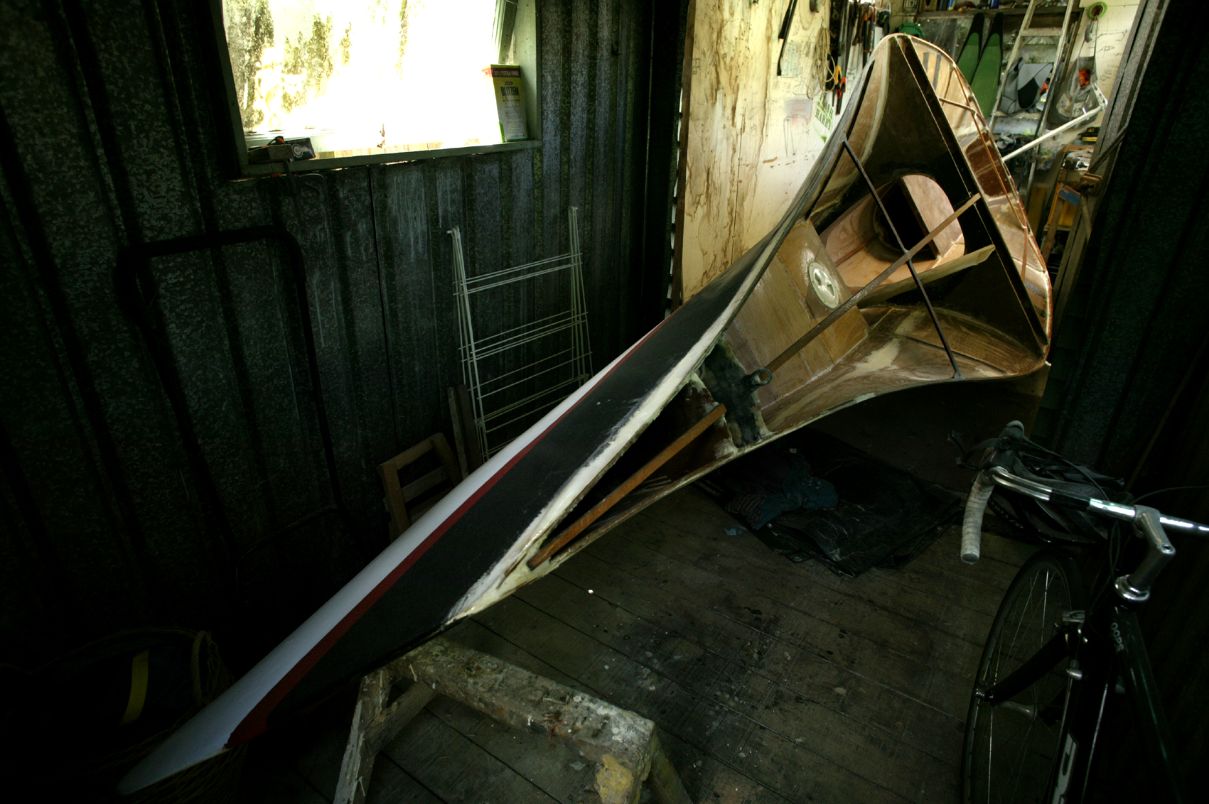

    8 x 8 metre Sid when launched three years ago. The changes since then: shortened the curved float foils and fixed them down, added daggerboard to main hull (wasn't satisfied with earlier windward performance), added 500mm to stern finishing in a point (because formerly it left an annoying wake in light airs) - and that's about all.
    Sid 650 (second photograph) will be much the same configuration except the main hull is a little wider, especially on deck, more depth and has a little more rocker - and will carry two crew whereas the 8.5 is a selfish single hander. Thought two would fit aboard but was wrong, too small, too mean.

    Still think Sid's a natural beauty, can we expect, maybe perhaps possibly, a lengthy vid about her wonders any soon?
    What extra sails does or can Sid carry if I may ask?
    Sid 650 just doesn't sound right or do justice imho and deserves it's own name, but who am I?
    Don't take chooky for a turkey
    Noice boike btw.
