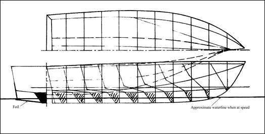

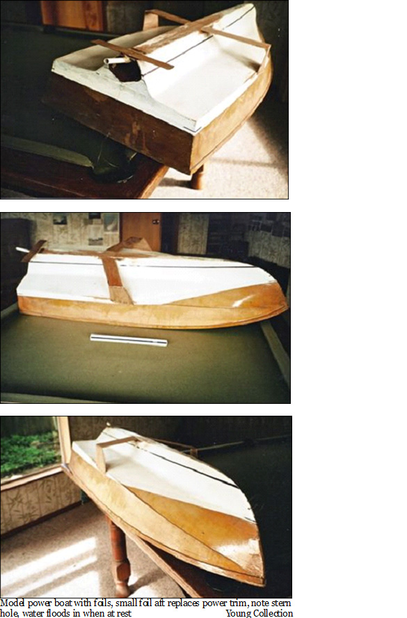

    Hydroman, you might be interested in this model that Jim Young made; it is similar in some ways to your boat in that it too has clever stability - but it also has foils for high speed.
    The mono-foiler
    THE SOLE OBJECT of hydrofoils is to reduce drag and provide a smoother ride. Recently I designed a five-metre monohull with foil assistance and made a quarter model to prove a theory in search of that smooth, economical ride. I tested it in the Milford creek.
    It is just a normal monohull, with an extremely fine, narrow 70-degree steeply veed pod approximately 30 centimetres deep added to the bottom. The after end of the pod is open so it can immediately flood with water the moment it is launched allowing it to settle to normal stable static flotation.
    When it reaches a speed of approximately eight knots, the pod quickly drains out. The added buoyancy then lifts the hull clear of the surface so it is running on the extremely narrow pod. This is where the foils come into play. They lift the pod 300mm further and in doing so automatically provide the stability equal to what the hull provided when at rest. Slow the boat down and it settles down to its static flotation. The model has foils with a three degree angle of attack. The outboard leg also has a foil attached so that power trim can be used to control angle of attack for another two degrees to the nose-up attitude, for a total of approximately five degrees, depending upon speed.
    My quarter scale model was loaded with five kilos of ballast to bring it down to its static waterline and tested on the creek using a battery-powered drill turning a plywood drum of the correct circumference to simulate a speed of 22 knots – more or less. Of course there was no accurate data, but the visible result was all I needed; the detail could wait. The model had a small foil mounted at the stern to represent the trim provided by the adjustable power trim. The model behaved exactly as expected and represents a vast improvement in the efficiency and ride of a monohull at speed. In a proper purpose-designed boat the foil could be retractable so as to protect it on a trailer. All that's needed now is the full-sized model.
    The same concept would be ideal for double-ended catamaran ferries running to areas where there are no wharves. The foils could be retractable and have trim control, depending on loading.

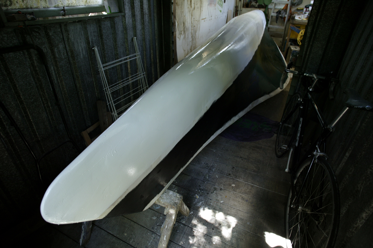

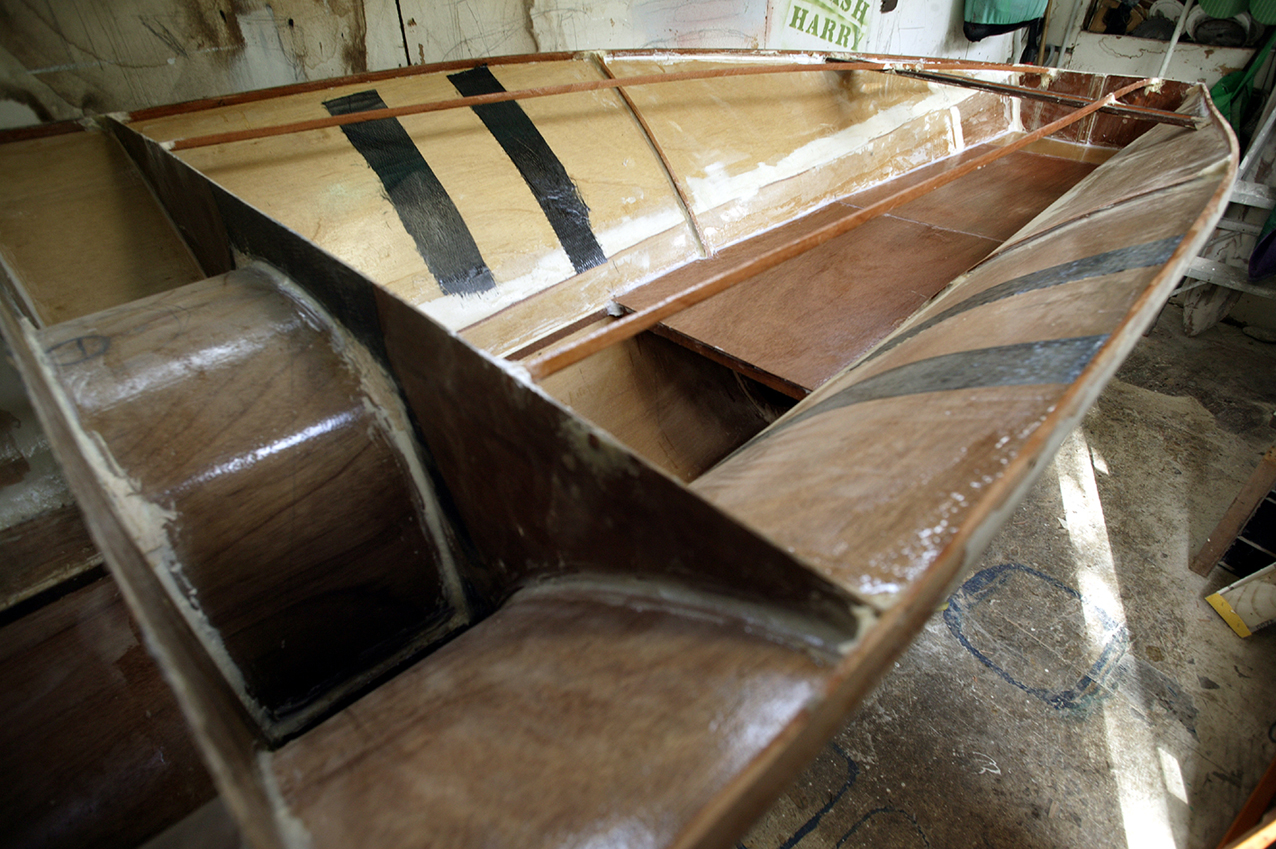

  4. Gary Baigent
    Joined: Jul 2005
    Posts: 3,019
    Location: auckland nz
    Gary Baigent Senior Member

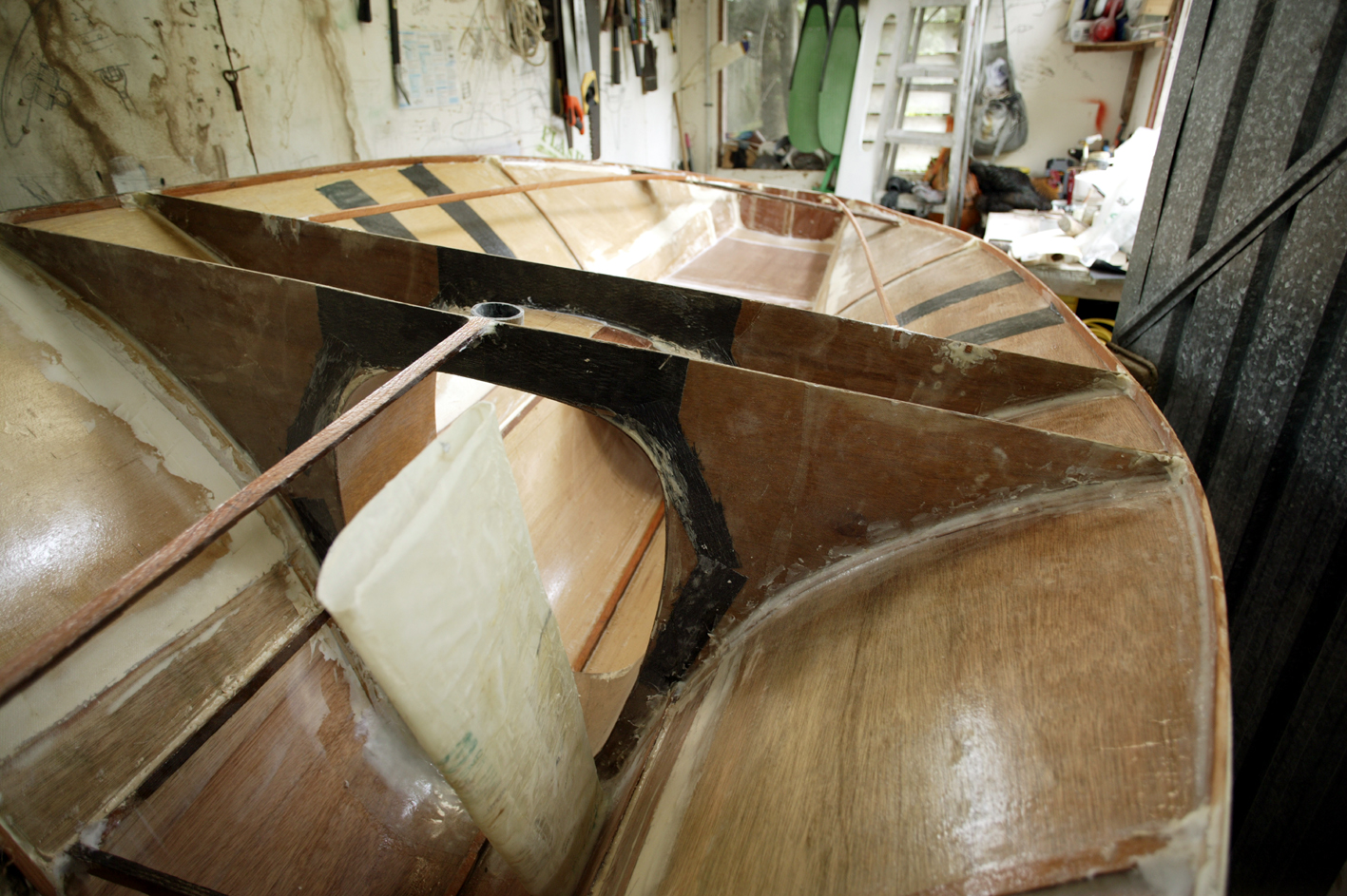

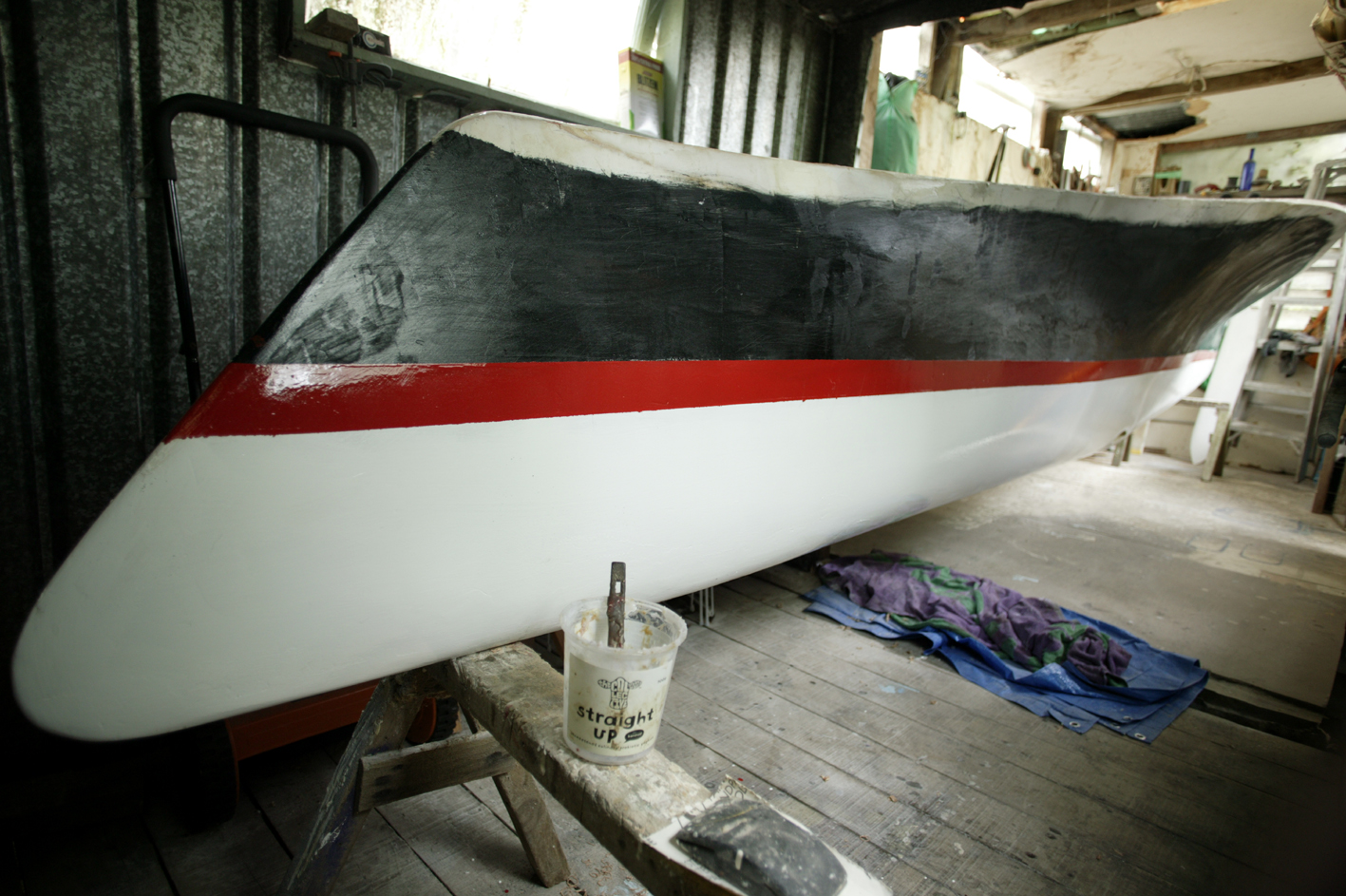

    Getting the bunks in, using up the scraps - also painted bottom 3 coats of 2 pot white.

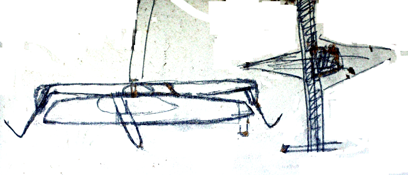

  5. Gary Baigent
    Joined: Jul 2005
    Posts: 3,019
    Latest thinking, as can be seen from this highly accurate shed wall graffiti, is to shorten the main beam to around 6 metres, not the 7 of my original idea, and angle the small floats outwards slightly to have the (dare I mention) uptip foils also angle outwards - as can be seen in the fore and aft swung beam for transporting artwork. Advantage is less beam material required and it will pivot fore and aft to fit neatly with the reverse bow and retrousse transom - and maybe the foils could be left in, lifted that is, on the trailer.
    I played around a decade or so ago with outfacing foils on Groucho so I know what they can do; it is really, with the 6.5m, the same as the recent outfacing foils on the IMOCA 60s (which obviously work too well and break the boats), well 4 of them anyway; the one that survived won. They will get this extra righting moment power sorted but on a multihull it is easier, because it is same principle we've always had, meaning with trimarans and floats.

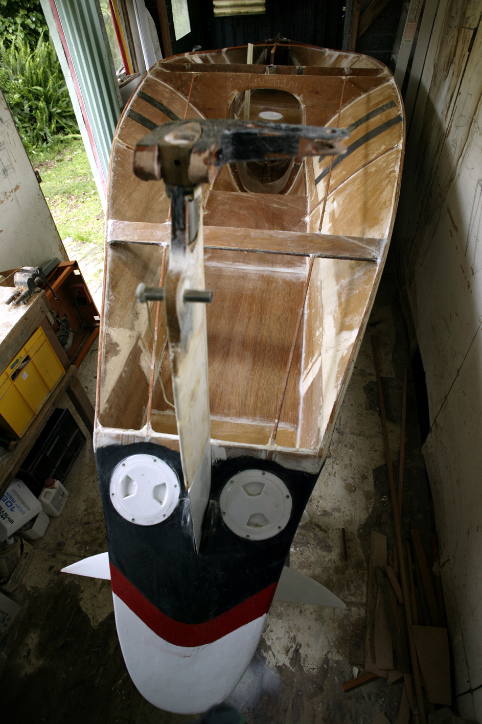

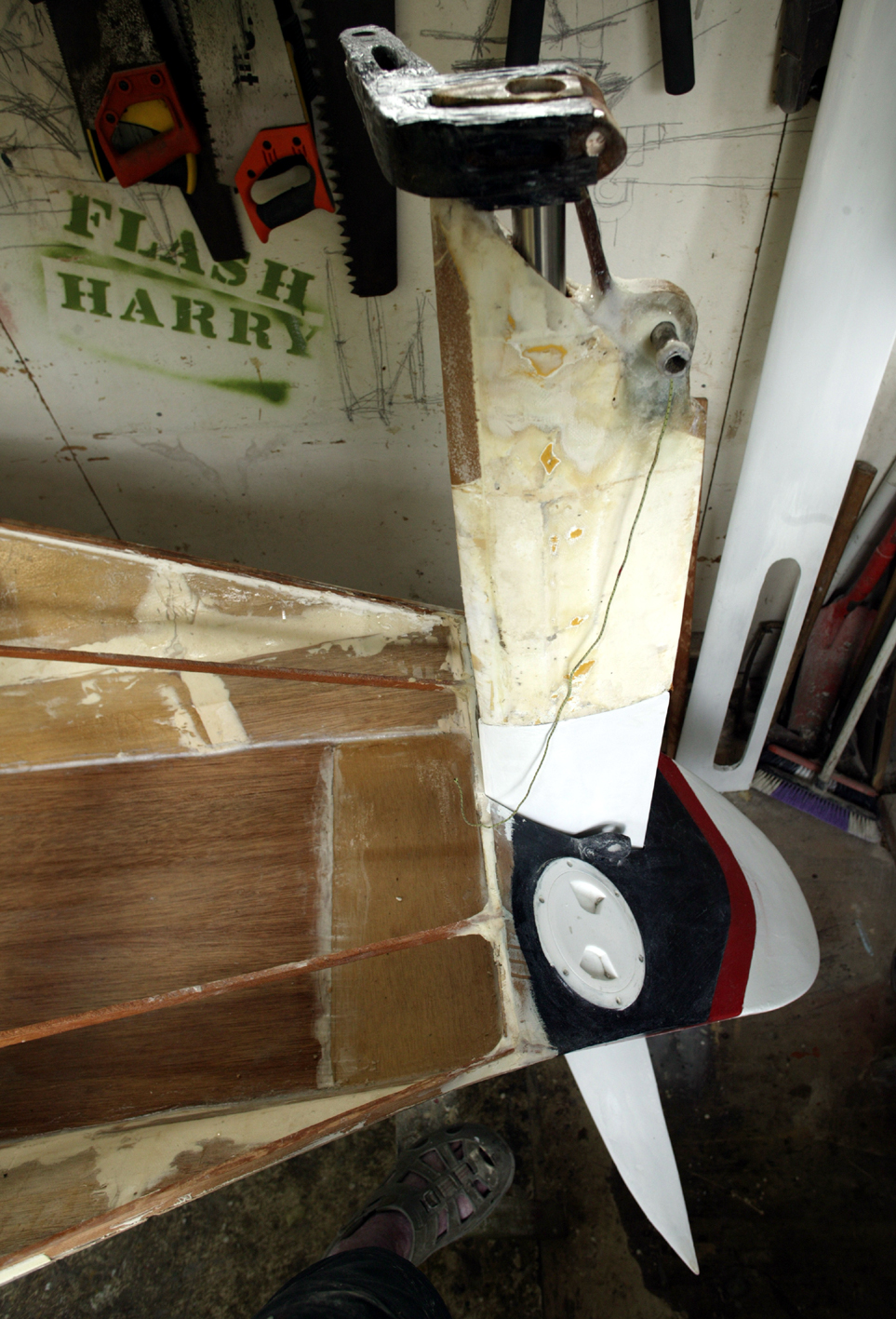

  9. Gary Baigent
    Joined: Jul 2005
    Posts: 3,019

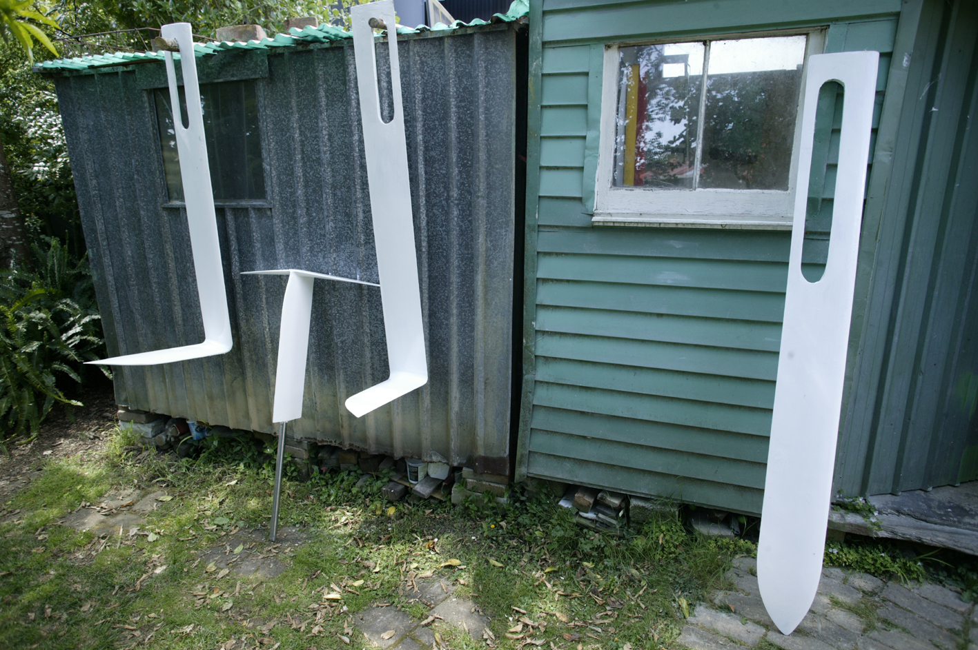

    Some rudder assembly. Also lifted the forward central area deckline - to allow gracious living and comfort below?
