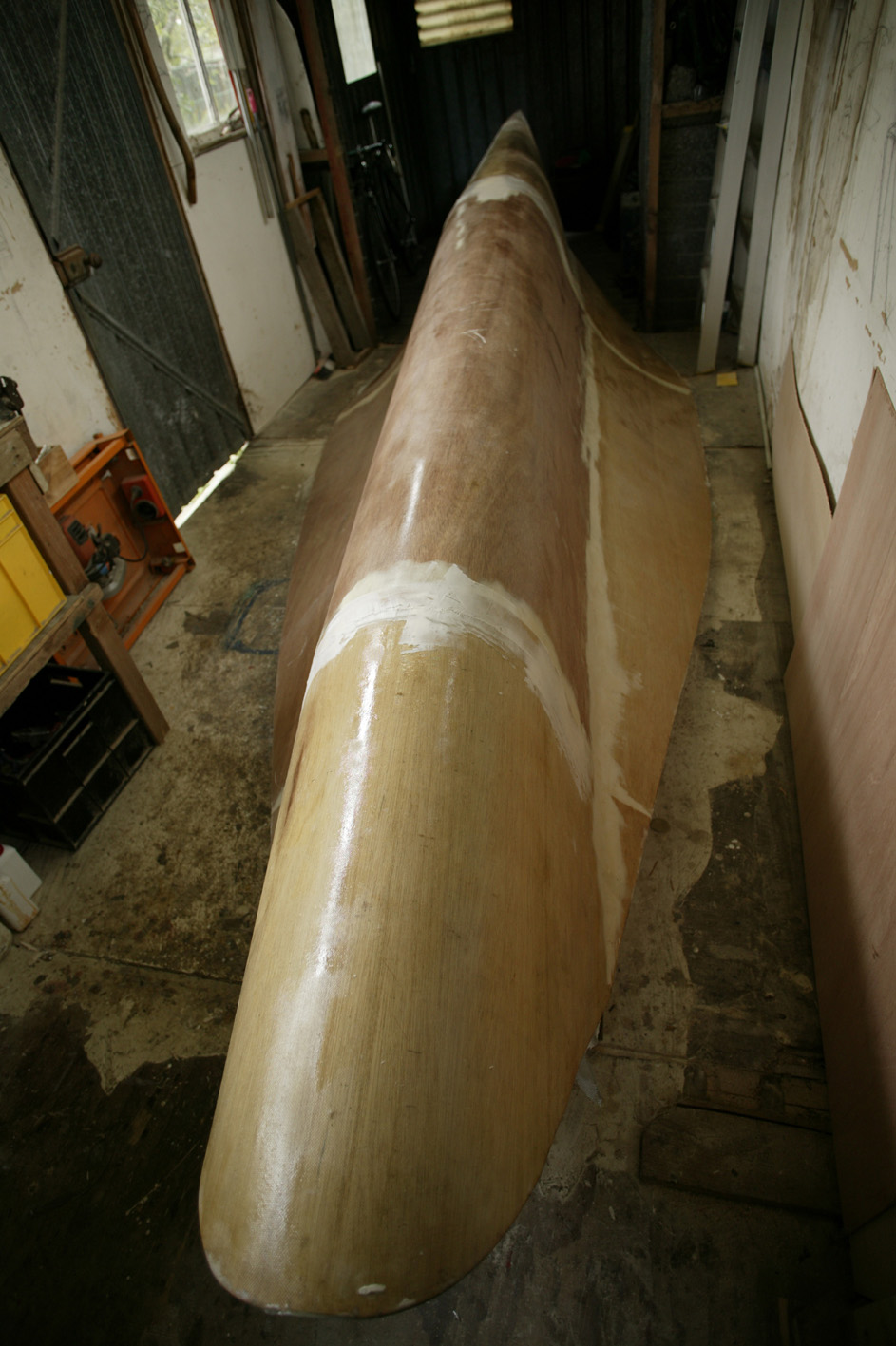

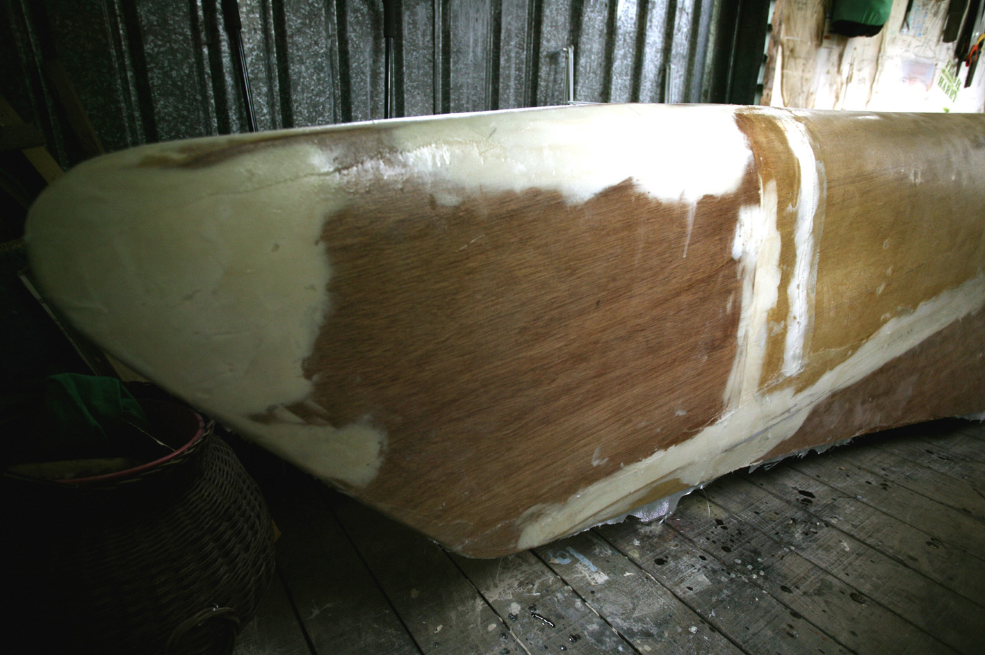

  4. Gary Baigent
    Joined: Jul 2005
    Posts: 3,019
    Location: auckland nz
    Gary Baigent Senior Member
    Turned the 650 over and glassed it. That's the bow in second shot.
  5. Marmoset
    Joined: Aug 2014
    Posts: 380
    Location: SF Bay Area
    Marmoset Senior Member
    looking like a boat! so thats what, 5 sheets so far?
    Barry

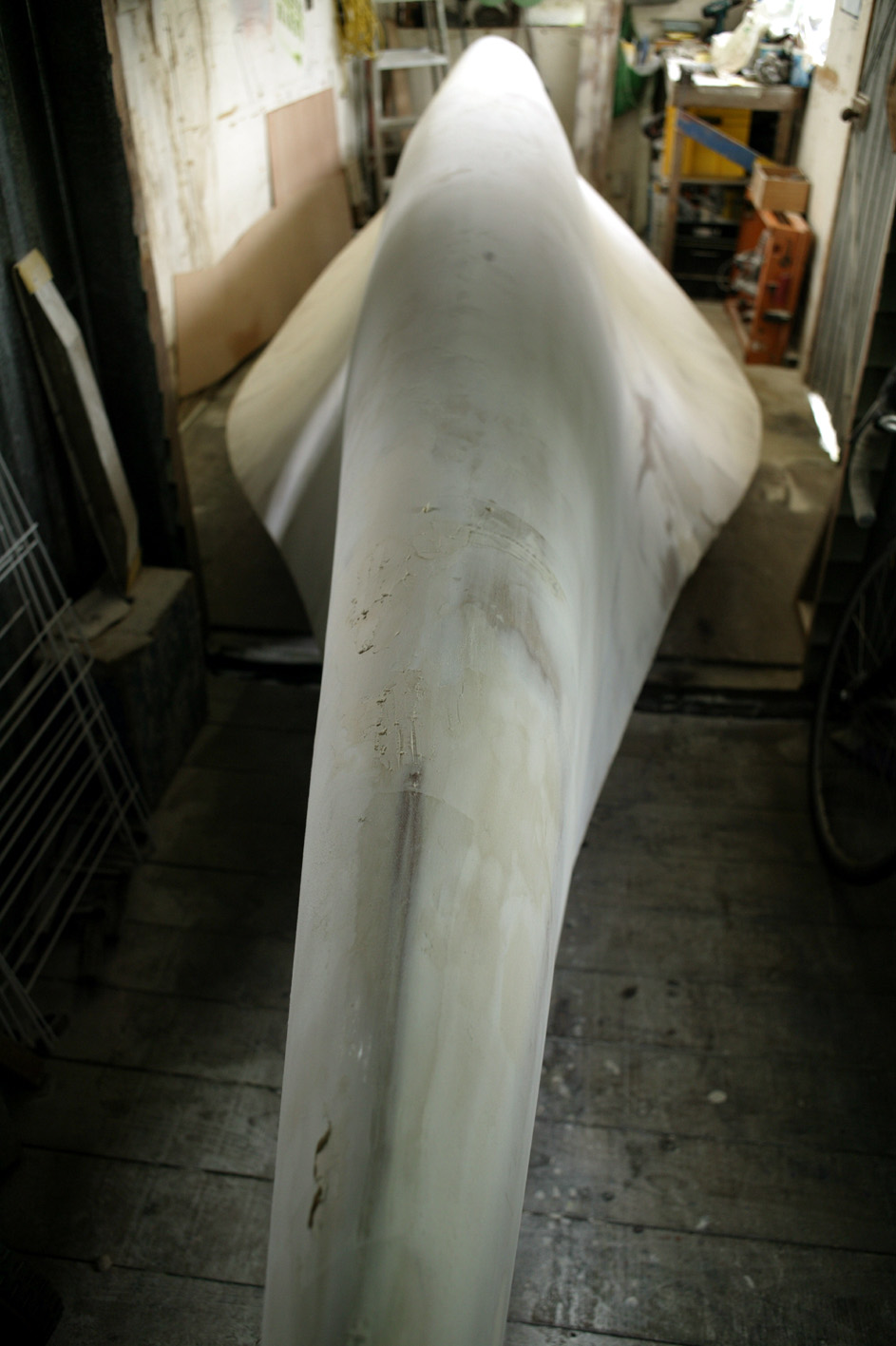

  6. Gary Baigent
    Joined: Jul 2005
    Posts: 3,019
    Filling and fairing, quite boring but there you are.
    Yes, 5 sheets - a few offcuts left over.
  7. warwick
    Joined: Jan 2012
    Posts: 423
    Likes: 7, Points: 18, Legacy Rep: 63
    Location: papakura south auckland new zealand
    warwick Senior Member
    The ray is coming together now Gary

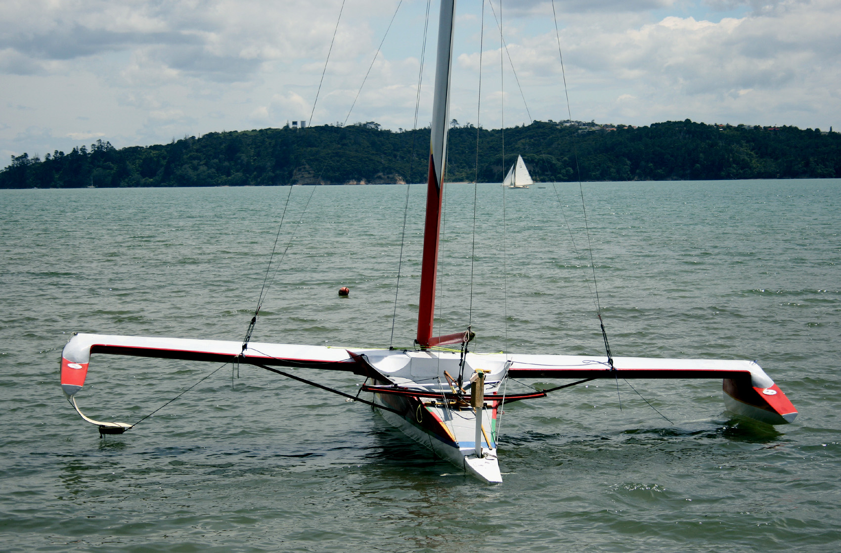

  10. Tom.151
    Joined: Jul 2009
    Posts: 195
    Location: New England, USA
    Tom.151 Best boat so far? Crowther Twiggy (32')
    About taking up the shroud loads... I'm looking at this as if the crossbeam structure extends continuously from ama to ama. Somewhat as a ladder-like for thinking about it.
    Rig loads are mostly generated from the leeward ama - across the boat - to the windward ama - to the chainplate - and up the w/w shroud to the mast hounds.
    In your case "across the boat" is (can be) continuous withing the crossbeam itself. no transverse rig loading at the aka/vaka join at all (Yes, rig loads from the headstay need to be handled at the Hull/aka join but those are longitudinal - so a different prospect all together, maybe done with some type of fore and aft truss, maybe even with synthetic line instead of fixed).
    No need to even fasten the shrouds to the ama, just draw out your shroud angle (mine was prox 23 degs of sweepback for the 44' Gougeon B-section on the Twiggy) on the crossbeam and mount the attachment point more inboard.
    Size the rear (athwartships) bulkhead of the aka, making it deep enough toward the middle to take the loads to eliminate waterstay hassles. Replacing the waterstay load path with a fixed path at the bottom edge of the aka might be done with as little depth as 18 inches (50mm) considering that you can bump the strength in tension with c/f
    The boat already looks great - a speeding bullet we'd call it over here - congrats on your amazing and apparently completely ad hoc building approach.
    Cheers,
    TomH

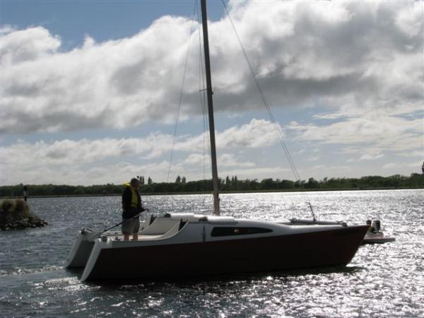

    Looks a nice boat. Although I don't like the daggers offset to the outside of the hulls - safer on the inside if you have to try and operate one by hand. The price kind of counts against us ever seeing any down in this neck of the woods. Including a few options like a trailer freight and GST could easily go over 60k $NZ. As OS7 (Hi Paddy) points out an I 23 would function similarly, and be somewhat more affordable.
    Shame we never had a (commercially successful) Strider or International 23 equivalent in NZ. 7 x 4-ish metre cats are a useful size for daysailing and camp cruising.

  13. Gary Baigent
    Joined: Jul 2005
    Posts: 3,019
    Thanks Tom, good suggestions coming from your experience with the Twiggy.
    Because Sid 8.5 and whatever the 6.5 is named, has/have long beams I don't need to take the shrouds right out to the beam/float junction but take them to the halfway mark - and that still gives me a wide staying base, reduced compression loads and good staying angles - and less slackness in the leeward stay when the boat is under sail loads. I have the same setup on 11x11m Groucho, which like Sid 8.5, has hollow water stays/struts.
    But unlike your clever Crowther tri with two beams, I have a single airfoil shaped cross section beam ... so the stays have to be attached to the trailing edge (to get a decent and safe angle). If I took the stays to the I beam mid section of said beam, then the angle of the mast stays would be close to in-line, not quite, but close (because of mast rake) and therefore a little concerning if the boat flexed enough going over waves ... and the whole lot embarrassingly falls over sideways. Another reason why I have runners too. See Sid 8.5 photograph.
    Agreed, if I could get away from not having water stays on the smaller boat, then that would be a neater solution. The 6.5 has proportionately wider flare than Sid.
    If I take the stays to the widest point of the stingray, then instead of water stays, could just triangulate the hull interior with uni-carbon - or even timber laminates going to main bulkhead. With the smaller wing mast of 9 metres or so, maybe I could get away with this?

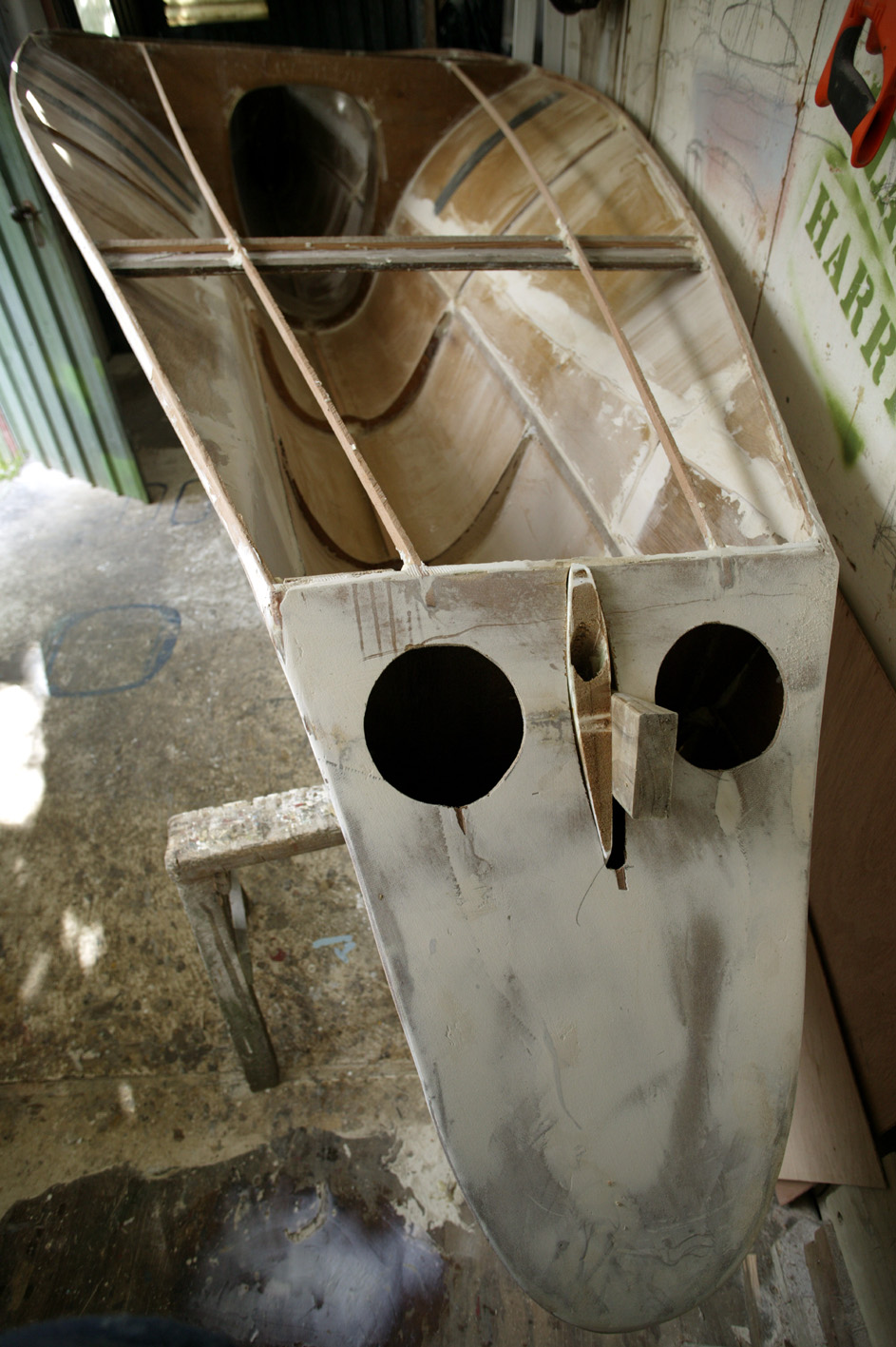

  14. Gary Baigent
    Joined: Jul 2005
    Posts: 3,019
    Finished fairing, now cutting, fitting rudder.

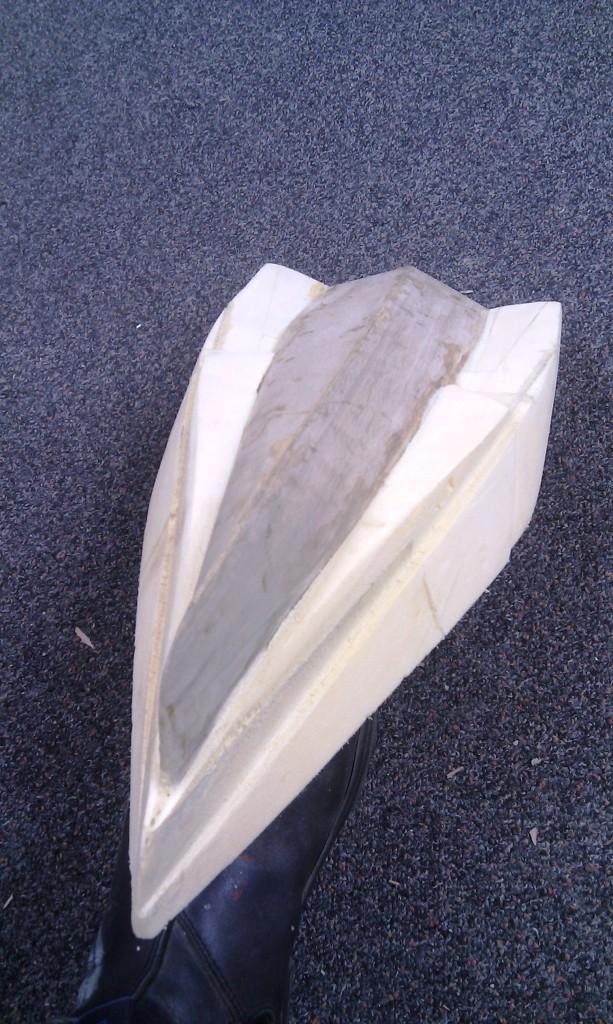

    Hi Gary,
    Firstly wish I had your abilities.
    Love your build approach, we call it bubblegum and stickytape in my shed.
    Jumping back a bit in one post you said you generate the hull form based on the wood / resistance.
    I have done a very similar thing but only on a small model at this time using paulownia sheets.
    Started off with a couple of sheets of wood and some left over closed cell foam from other models and put together a similar shaped hull as yours but with the idea of a mono hull family day sailor / power boat in mind.
    Form fairly much dictated it's own shape based on the constraints I had set in my mind, I just kept adding and removing foam and reshaping until I was happy with the look and the way it sat and performed in the water.
    Ended up with excellent stability and resistance to heel without giving having too much waterline.
    Did some very rough pool testing (rod, reel and strain gauge) and was very happy with the outcome.
    Had very little resistance, on par with other models of tri's and cat's I have built. Also has very good stability for an unleaded mono, toying with the idea of water ballast if I make a full size version.
    Seems to jump up onto a plane very quickly and has very little wake or bow wave.
    Did a bit of a heel test with makeshift mast and weights and again was impressed with the stability.
    Couple of images of the model to help visualise as attached.
