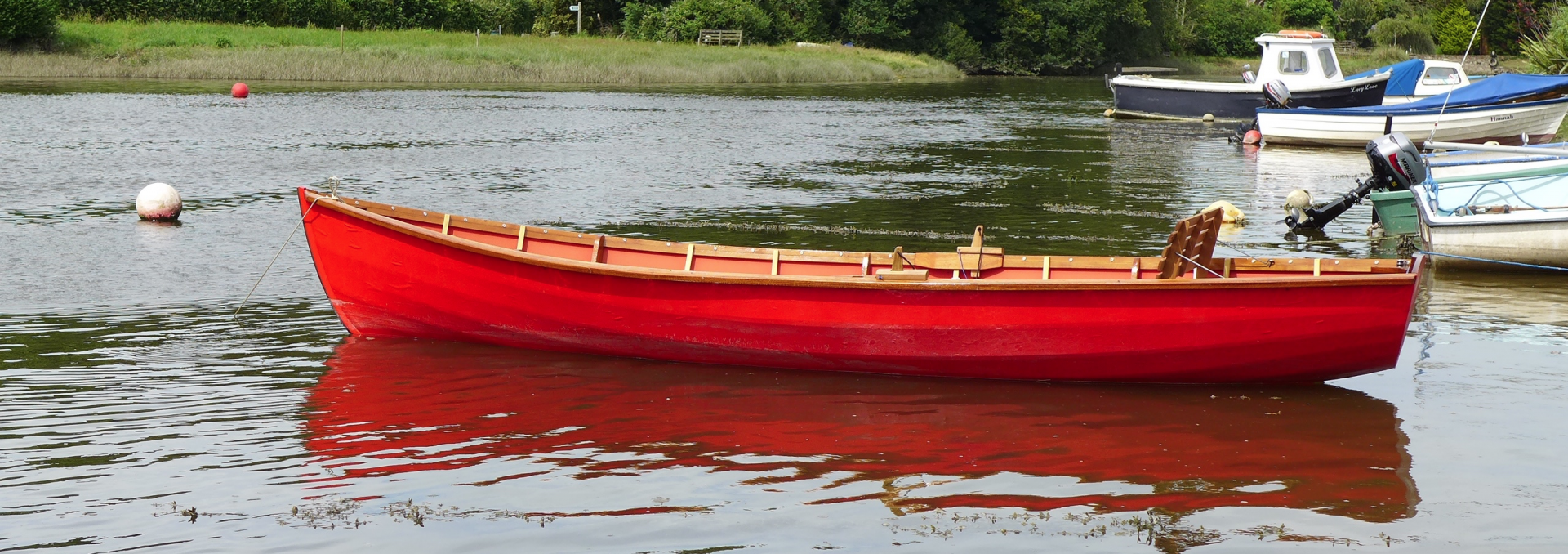

  6. alan craig
    Joined: Jul 2012
    Posts: 281
    Likes: 58, Points: 38, Legacy Rep: 14
    Location: s.e. england
    alan craig Senior Member
    Portacruise, thanks for explaining. Although I suggested a model plane prop (uses 1/2 to 2/3 the power for the same speed compared to trolling prop) I can confirm that they are weed magnets. Xellz did mention brushless motors which are PWM anyway, plus the chopping and changing of phases.
    Go ahead Xellz and build a small boat; it's a great feeling to finish it and launch for the first time and say "I made that!" I've recently finished my first but I'll admit that the launching was better than the building.
    Sorry, don't know how to reduce picture size.

  8. alan craig
    Joined: Jul 2012
    Posts: 281
    Thanks PC, there is a thread in electric propulsion sub-forum which shows my brushless/Evinrude conversion. Turnigy brushless and standard prop. Yes, you could have piezo propulsion, or pump, but if I understood the article, it would have only one speed.
    The boat in the picture is floating with the 54kg of batteries on board.
