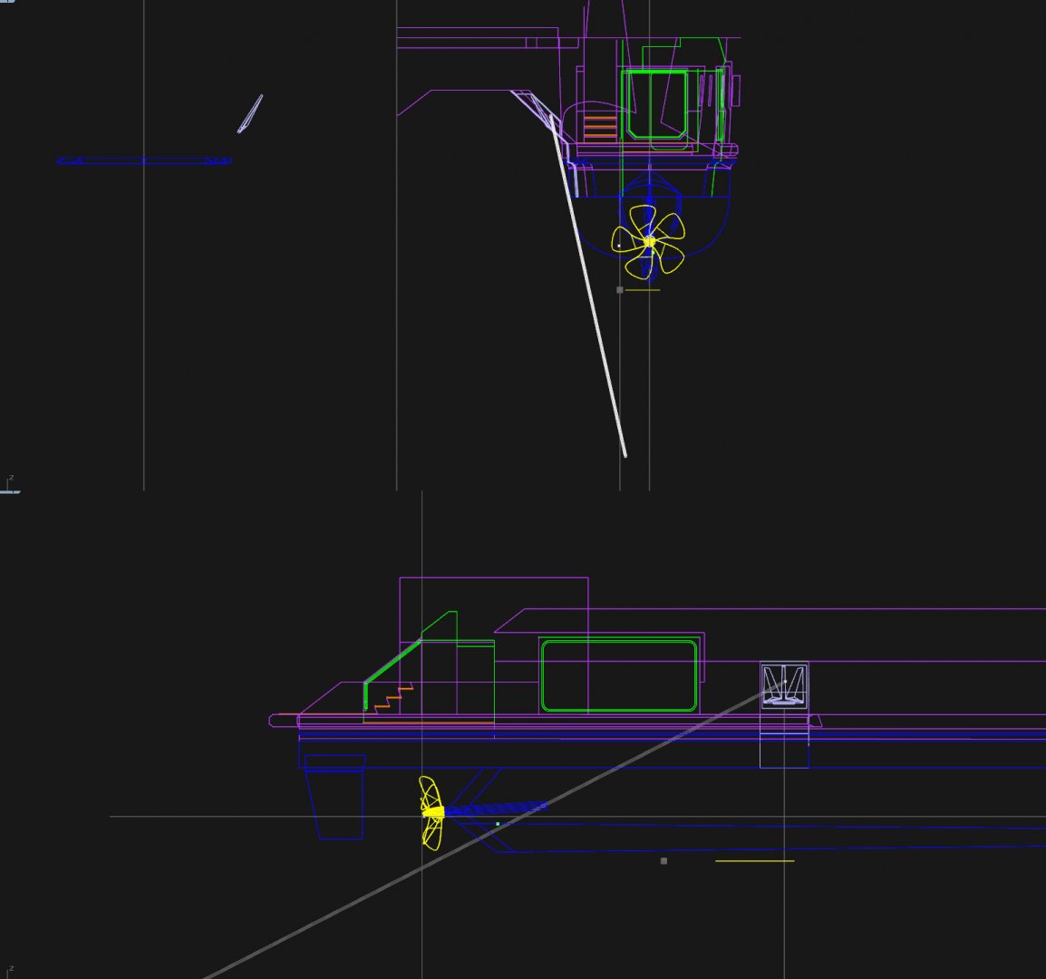

    I belive a 55M catamaran are always bigger than your small 50 cats..Do you have any experience in 50M+ catamaran design ? Have you ever dreamed designing a catamaran in this size one day ? I also expect that you have ability and chance to do so ,I think It makes sense to us whether art or design or concept or order project ...
    About the anchor ,Can I move them from bow to aft ? This is the first time you have see this idea of anchor arrangement ?bad idea or good innovative design ? Thanks for your comments..

    I think You should try doing small cats first, say 18' would be good to start - design, build and test it. Jumping into superyacht league with zero experience gives very little chance for Your projects.
    Anchor location - if You ever anchored on a catamaran, You will understand why Your idea will not work. There are many practical reasons why one should not do this.
    Any boat designer should have seagoing experience, otherwise this is just 'work of art'.

    I know Anchor location of small cats are at the bow, Maybe you've never seen a cat with aft anchor ? But some big cats not at the bow , really at the aft !
    Can you explain why it will not work ?

    I saw/designed/operated many boats with different anchors. I also own power cats for many years thus have have expertise how to anchor them, also on strong current.
    Aft anchor is not bow anchor. When You position the boat head to wind/waves (which is what everyone want), You use bow anchor.
    On Your sketches, anchor is not at stern, it is deep in tunnel between the hulls. It will hold the boat exactly side to wind/waves, and one would not be able to control boat's position - no access for bridle, etc. Add current, and the anchor line will go under the hull, and probably catch the propeller and rudder.
    Another problem, anchor should be accessible and visible - it might catch some objects, lines, etc. so the crew should be able to clear the anchor out. In Your design, there is no access and the anchor is not physically visible.
    In Your design, anchor pipe is close to waterline, is it a downflooding point? If not, where does it go, to watertight deck?
    One should understand such basics prior to attempt designin 50m boats! This is the issue of nautical culture that does not exist on such artwork.
    PS You could have put anchor on top of mast. Very innovative and nobody did that before. With the same level of usability ;)

    your comment is right . But in fact the hull tunnel is 2.1M Above water so the anchor pipe is not so close to the waterline as your view. so I do not think there is downflooding point. The anchor is far way from the propeller about 8.5M and propeller is 1/2 width of the hull beam . so I think the anchor line is hard to catch to the propeller and rudder.
    I should admit the anchor not at the good location, but for reduce the load to the bow and leave the space for dinghy storage. So have to move to the new location .

    When the boat is anchored on current and wind at different angles, the chain will go at oblique angle one can easily catch the propeller. Imagine the wind of 15kts and current 1-2kts, 90 deg to each other - how will the boat position? On a cat, if the anchor chain attachment point is a bit deep in the tunnel, the chain will go under one hull and damage it. With Your layout, it will be much worse...
    What I suggest: look at working together with proper naval architecture office. Don't design boats on Your own, You will never sell such designs.
