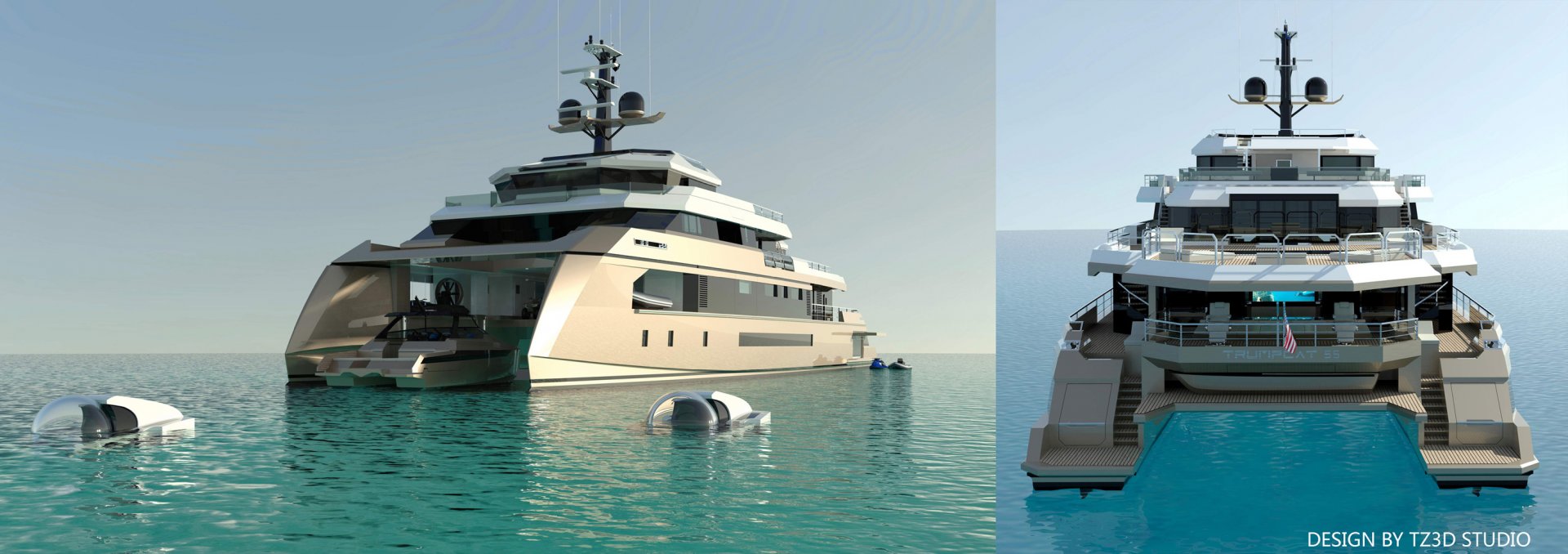

    T-CAT 55 Presentation:
    T-CAT 55 is a super carrier yacht design for explore .He can carry a dozen big toys include custom 11M cat ,helicopter ,U-BOAT sub ,ATV,Halley,and other water toys.
    So he is a four habitat yacht in the world that we never to design.
    The core design of T-CAT 55 is a lift platform on foredeck which can down to water 2 M deep for U-BOAT sub and a 11M power cat to launch as well as for car and
    motorbike to go ashore 。T-CAT 55 without big crane on upper toys deck but has large outdoor deck space for life. So it's quite different to any other supply yacht
    but with power capacity of supply and entertainment.

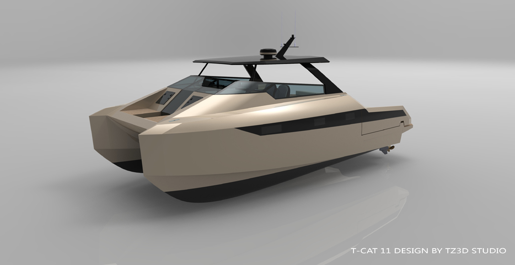

    Thanks to the catamarn feature , a whole beam president suite and five cabins on upper deck to be fitted to accommodate up to 12 guests and 12 children. 8 cabins for
    as many as 22 crews will be housed. Plus the carried tender (T-CAT 11) with 2 cabins available for extra 6 guests or crews. T-CAT 55 also offers many functional area
    for the entertainment , Include the 21 seats dining and cinema area,CAF,solon,bar,GYM ,steam ,massage,haircut,net bar on main deck . Many sun pads, salon,bars and
    waterfull pool on bridge deck . It can hold 60 guests for a day party to enjoy many kinds of entertainment.
    T-CAT 55 is a true innovative design. Whether from the layout to the furniture design , everything are unique. It's got more advancing functions than any other
    vessels. Very cool looking and versatility are his feature.

    (1x) Custom 10.6m*5.2m powercat (T-CAT 11)

  6. tz3dcom
    Joined: Jul 2006
    Posts: 113
    Likes: 8, Points: 28, Legacy Rep: 22
    Location: China
    tz3dcom 3D
    more pics
  7. Alik
    Joined: Jul 2003
    Posts: 2,974
    Likes: 279, Points: 93, Legacy Rep: 1306
    Location: Thailand
    Alik Senior Member
    Bow part of catamaran cross deck takes a lot of slamming loads. Such a garage there with low vertical clearance is hardly feasible.
  8. tz3dcom
    Joined: Jul 2006
    Posts: 113
    Location: China
    tz3dcom 3D
    No...the aluminum catamaran is strong .The idea come from L-cat , you can see the whole deck is liftable , Only the bow beam and aft beam is fixed for connect the two hulls.
  9. Alik
    Joined: Jul 2003
    Posts: 2,974
    Location: Thailand
    Alik Senior Member
    The picture You posted is for is for coastal craft, not for seagoing yacht.
    How many catamarans have You personally designed which are built? Have You ever been on catamaran at sea, in severe conditions? The answers are 'zero' and 'no', I am sure :)
    TANSL likes this.

  11. Alik
    Joined: Jul 2003
    Posts: 2,974
    Location: Thailand
    Alik Senior Member
    OK, so You treat it as 'work of art', not as design? :)
    Looking at mirror, we developed over 50 catamaran designs, which are in service. Some of them are 'Significant small ships' of the year, selected by RINA.
    3D model is nothing, but knowledge and experience behind it are important. If the 'designer' places the large opening ramp in heavy slamming zone, but completely ignores any arrangement for anchor equipment, I would seriously doubt about his experience and usability of the design. Such design errors are impossible to correct, even when the concept is taken over by professional boat designers/naval architects.
    'I can draw in 3D' is not necessarily equal to 'I can design boats'.
    Pammie and TANSL like this.
  12. Ad Hoc
    Joined: Oct 2008
    Posts: 6,910
    Likes: 855, Points: 113, Legacy Rep: 2488
    Location: Japan
    Ad Hoc Naval Architect
    Yes.
    Historically from our records of doing these type of 3D renderings, it is circa 1% of the time it takes to Design the boat for real.
    Not just a pretty 3d image.
    Exactly - it is just art.
    As Alik notes, it is not design! The two disciplines are poles apart.
    Alik likes this.
