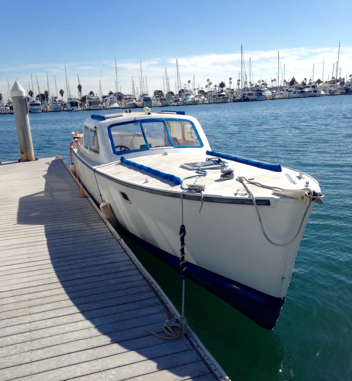

    After reading and following this forum for a long while (thank you for such a great resource) I became enthralled by progressive powerboat design. The purpose of posting this thread is to post the fuel economy results of the boat I bought and how its design has either advantages or drawbacks.
    The things that inspired me were the ability to go long distances in a boat while living simply and being frugal with fuel consumption. (enabling the user to get out on the water more without denting the pocketbook so much)
    I had always loved the 'go anywhere design' Tad Roberts' Passagemaker Lite but knew that a 'newly' built one would likely be out of my price range forever. As I scoured the used boat market, I had always looked for single diesel straight shaft boats that could sleep a few people and could be single handed and hopefully trailered to cut down on transport costs. The design I had always linked to extreme fuel efficiency was narrow beam, lengthy LWL, and high ratio of beam to LWL. In this case 7.5'(at its widest) by 42' = 5.6. (with the low wake, as I understand it, being a tell-tale sign of good fuel efficiency)

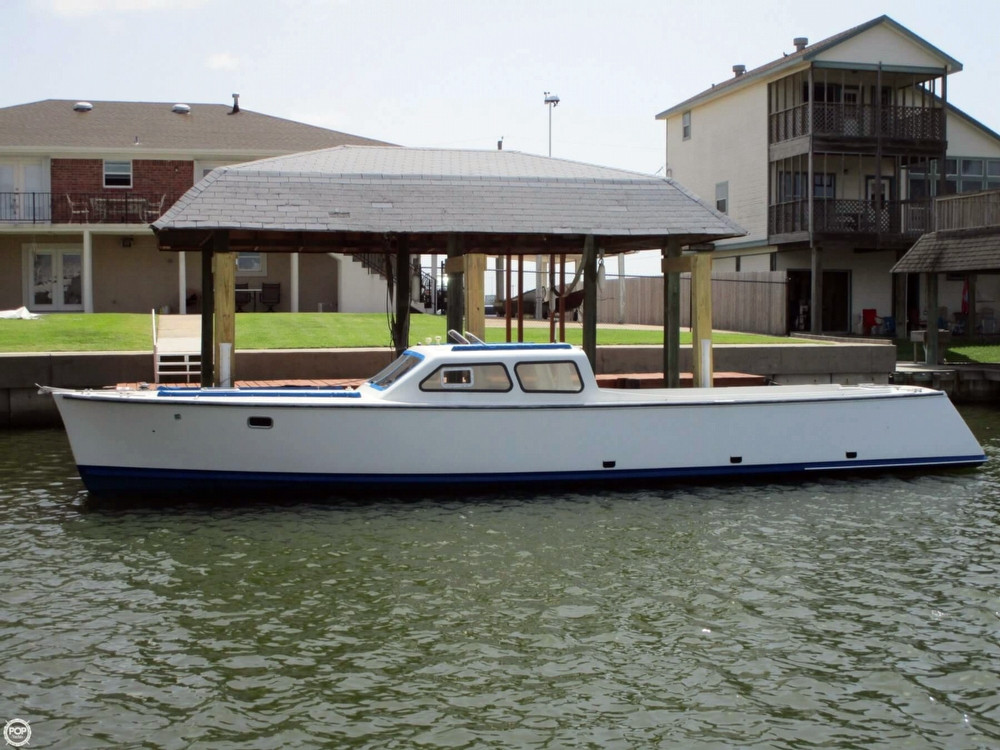

    At nights I had been blissfully perusing boats, all the wile understanding completely that passagemaking under power is often a wealthy persons past-time due to significant costs. Then one boat in particular caught my eye. It was long, light, efficiently powered, and wasn't $1MM. I had watched this boat sit for a while looking for its perfect owner (as custom boats often require) and after a lots of deliberation and the all-critical-approval from the wife, I decided to give the owner a call. I flew out, rode in it, and ended up buying it. (I am well aware it is not nearly as blue-water capable as the boats it emulates such as Tad's PML and Dashew's FPB.)
    boatselect-images.com/boats/933/TX/15365/newick-42-picnic-1.jpg
    The specs of the boat are as follows:
    42' Carbon Fiber, fiberglass, and linear foam construction - Total weight ~ 5,000 lbs - Designed by Dick Newick
    4 fuel tanks - 50 gal/each (200 total)

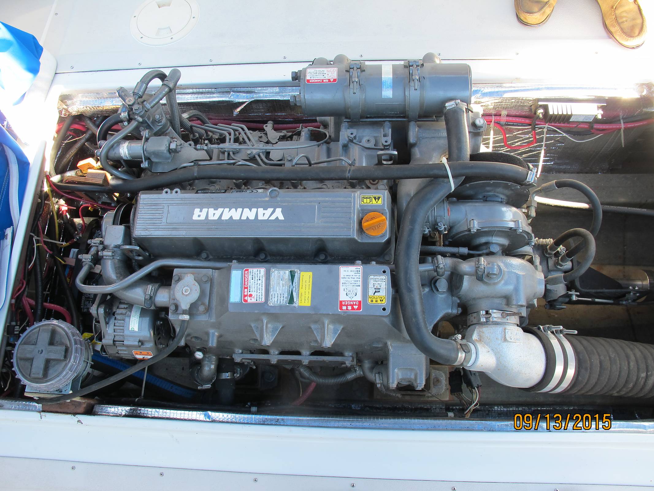

    Yanmar 4LHA-DTP turbo diesel - 158 continuous rated HP
    I have been really happy with the performance of the boat and am continually getting more in-depth understading of the various on-board systems.
    I cant wait to push its boundaries farther and farther along the pacific coast and beyond!

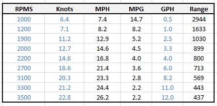

    Here are some pics and the fuel economies I have been testing against the below performance curves and fuel consumption chart:
    http://www.yanmarmarine.eu/theme/yanmarportal/UploadedFiles/Marine/productDownloads/Pleasure - datasheet/English/Yanmar-4LHA-DTP.pdf

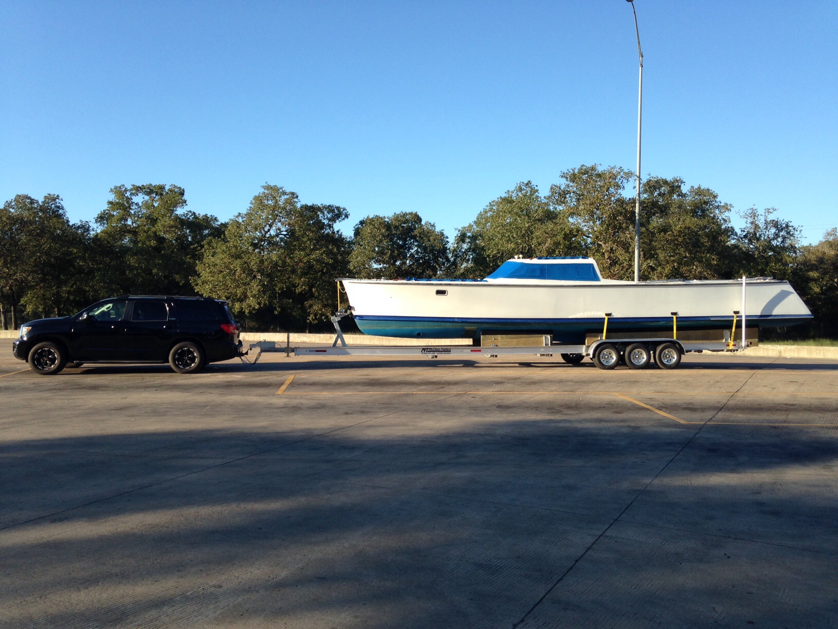

    Attached is a pic of the boat out of the water sitting on the trailer.
    I am relaying the weight from the Seller who had the boat made. A seasoned boat builder (paying to have custom boats made for him) I believe that weight to be without fuel. Also, when towing the boat across the country the 'weight' felt correct, but I have not independently verified.
    The beam is 7.5 feet at its widest point. There is a lengthy keel that protects the running gear.
    The transmission is a zf hurth 1.5. By all means ask as many questions as you wish, I am happy to participate on this forum.
    On seakeeping, I am still getting comfortable taking it out into bluewater. In head on seas it handles them like a champion. Been in a short interval 8-10' before heading back in. Abeam seas are where I am still stretching her legs.

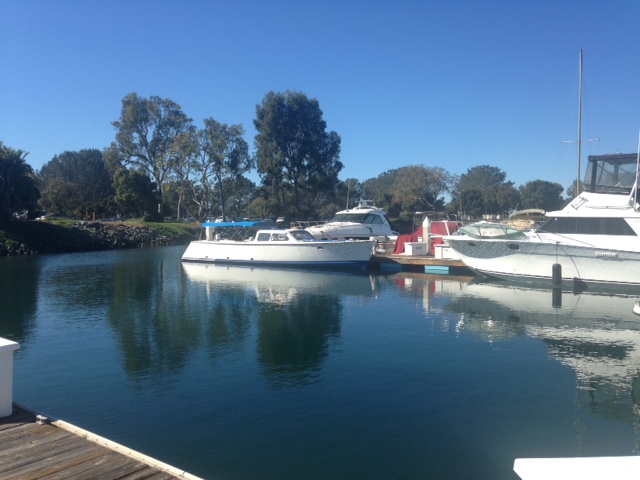

    Here is a pic showing the profile.

    Nice looking boat! Like the idea behind it.....

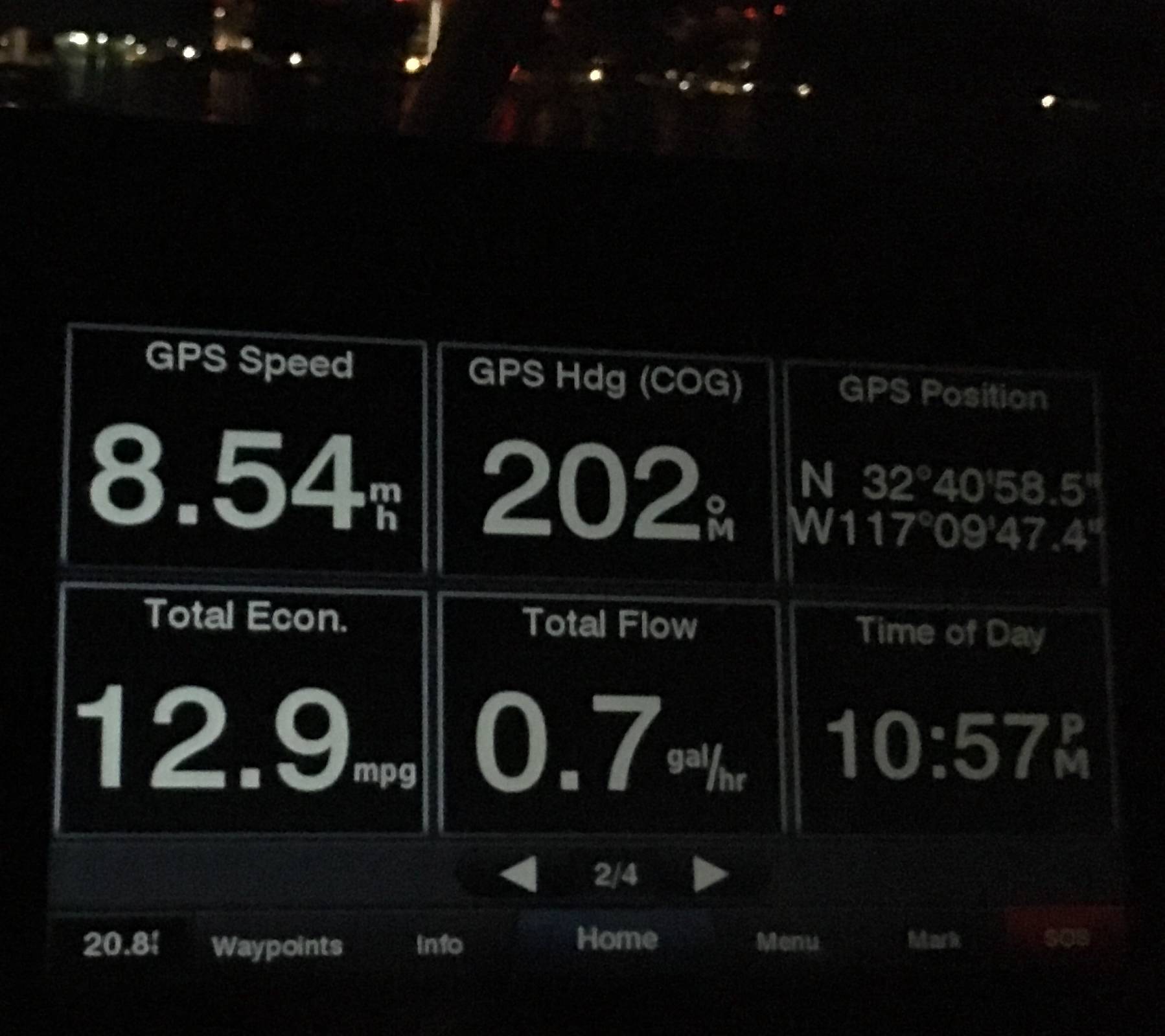

    Have the fuel management system working (Maretron FFM100). Here are a couple pics of the fuel economy. I was pleasantly surprised.

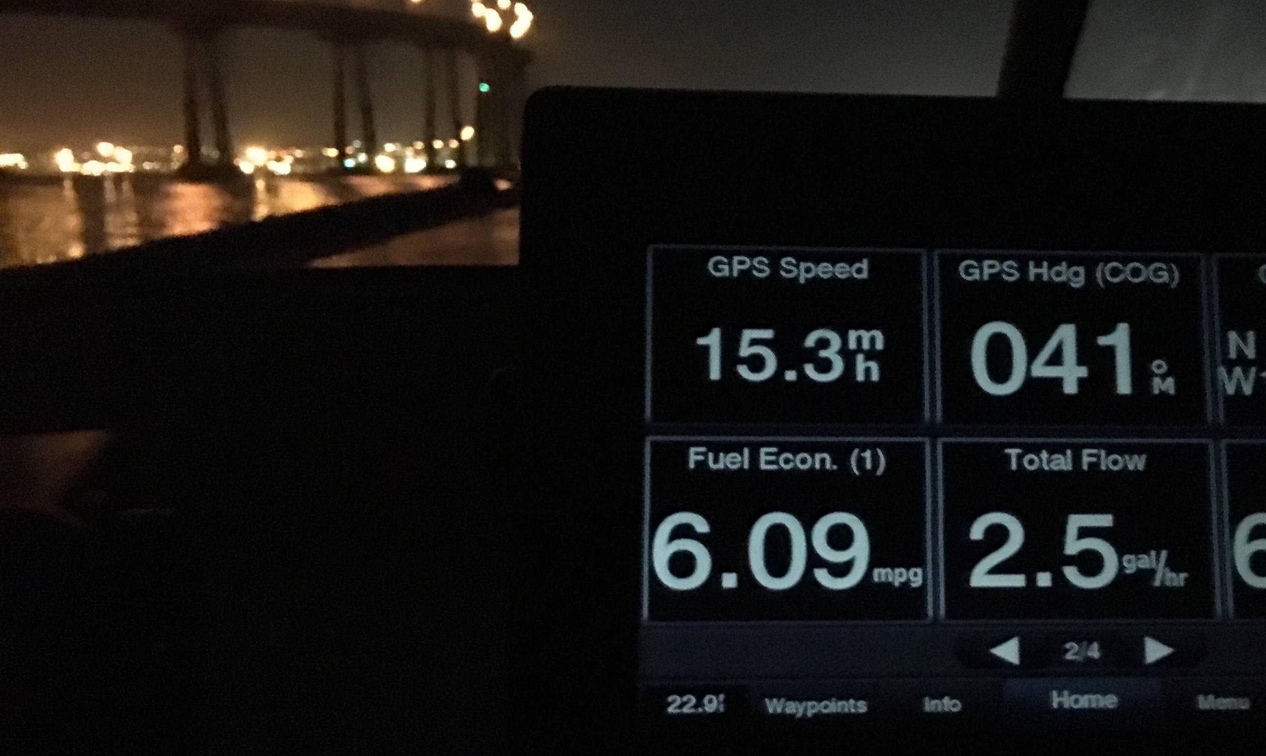

    Picture 2

    I like, its probably cheaper to run than a sailboat.

    Interesting fuel burn numbers. What is the maximum speed--is that the 2nd picture?
