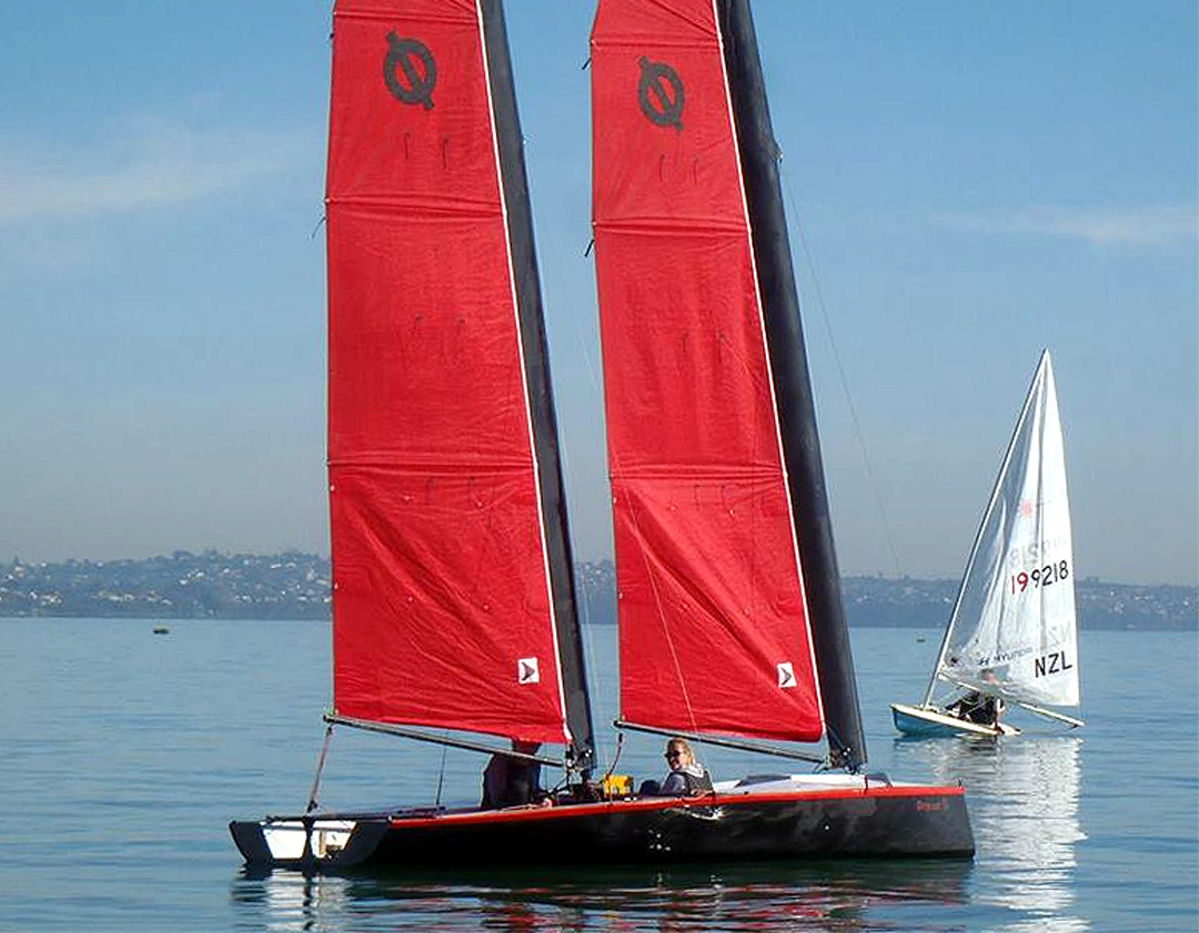

    Hey Rob, that rig belonga me.
  4. rob denney
    Joined: Feb 2005
    Posts: 781
    rob denney Senior Member

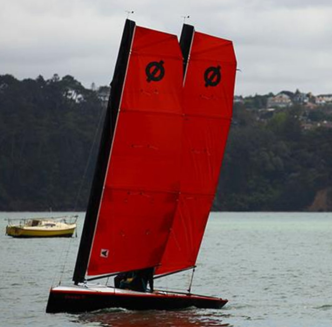

    This was taken in 2004. '-) Worked really well, but was a handful (and 2 feetful) when I was sailing solo in a breeze with 2 sheets and 2 rudders, so I went from schooner to una and put one of them in the middle. All the cruising harrys now have them. With a wishbone boom, they are safe and simple and extremely easy to sail, primarily as there are no leech loads on the mainsasil. Instead of busting your balls winching the main in to get leech tension, all the mainsheet does is alter the angle of the sail. A winch is barely required, even with a 2:1 mainsheet.

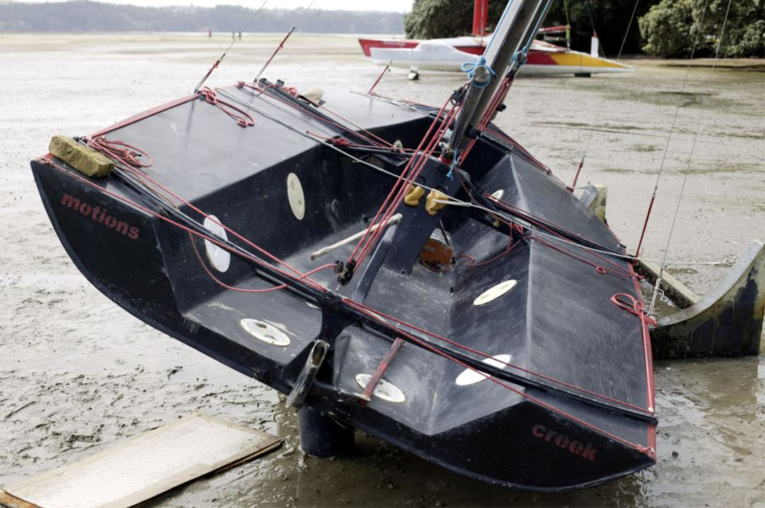

    EDIT: I put up a pic of the hull bottom, very inspirational I know. Hope to put more up sooner rather than later.

    The boom is 1.8m/6' above the deck and ~horizontal. It is slightly longer than the sail length from mast to clew. There is a single line from the sail clew, through the end of the boom and down to the bottom of the mast. When this is tightened, the leech stands up, the mast bends and the bottom ~quarter of the sail is flattened. To control the flattening effect at the bottom, a line runs from the mast at boom height to the clew. Tighten this to increase the draft.
    With a bit of fine tuning of boom length/angle, adjustment of this line may only be required in light air. It may even be redundant, which will be a saving as otherwise it has to be tacked.
    Most wishbones require the boom to ~bisect the angle between the leech and the foot which means the lee side of the sail has a large impediment to the air flow and the attachment point is way up the mast, requiring extra mast stiffness. Hopefully, we can avoid some of this.
    The sail is tied to the mast with a lacing similar to a sleeve, but less friction. The lacing tension is adjustable for the tapered mast and reefing and it has a halyard lock at each reef point which doesn't require a string to release or lock and can be released if the halyard breaks. The attachment of the end of the square top diagonal batten to the mast is a possible problem, which may need a fitting to make it work.
    From your other thread: If the boom is attached to the mast with a snotter and the sheet and leech controls are attached to the other end, any bending is because the boom is too small in section or doesn't have enough material. Booms vanged (or gnav'ed) from the middle and curved booms (wishbones) need a lot more material/size than straight booms.
    I built a wishbone boom for Bucket List, weighs 15 kgs. The replacement straight one will be <5. This shunts to windward of the mast, all going well. Neither has been tested yet.
