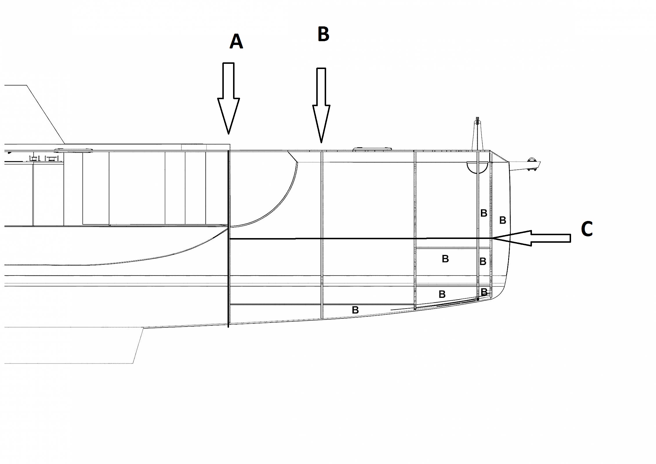

    Flotation forward (B)

    You need much more
    I think you are falling into the same thinking as many other cat builders with the amount of divided flotation your boat will have. The amount of volume behind these bulkheads is very low. This has three effects.
    One - the chance of the bulkheads containing all of the damage is lowered. As the volume is small it is likely that a big hit with a container, log or rock will damage more than the area sealed off and water will still enter the rest of the hull.
    Two - a likely event is that the bulkheads will be needed to reduce the flooded volume of the rest of the hull if the centre of the hull is damaged. This part of what the bulkheads do is vital.
    Three - the inverted volume is negligible. If you want to have a habitable catamaran when inverted you must include an area (the bows are easier) in which to include substantial inverted volume. Your boat will be very low in the water if inverted.
    As a cat builder and sailor I still can't understand why people want to get to the front of their boats from inside. Do you really want a toilet next to the bed? I like the toilet a long way away from my wife so my ablutions don't spoil the image she has of me (at not least straightaway). What are you going to put up there? A single berth. Why? No one will every use it and you would be much better off using the bridgdeck cabin for extra berths.
    In the end the pointy end gets used fore sails, fenders, swim fins, wetsuits, sailboard gear, spinnakers, reachers - pretty light stuff. All stuff that can be wet. So in a normal cat this wet stuff gets thrown into the interior - when wet. Why? I don't get it. We never get water into our interior on Kankama but used to all the time in our previous boat with a forehatch that was not sealed off.
    On Kankama I could give you an underwater drill and you could go and put a hole anywhere under the waterline you like. It has a 40% chance of being in a sealed void. If you don't put it in a void then I can still sail home on the flotation the voids provide. It is a such a good feeling to have and easy to design in. I really don't get why designers don't put more voids in.
    I have drawn what I would do. Kankama has a bulkhead a A. In front of that is storage. You could have a full bulkhead at B if you wanted to move the bulkhead forward. Also I have a floor at C. This means when I throw in the fenders, reacher, kite I can reach them from on deck. I love my flotation system - it makes the boat drier, safer and easier to use. And I have peace of mind knowing that if we are inverted we have somewhere (On the bottom of the floor- hence the axe) to stay for a couple of days until the EPIRB lets someone know we could do with a lift from a passing ship.
    cheers
    Phil

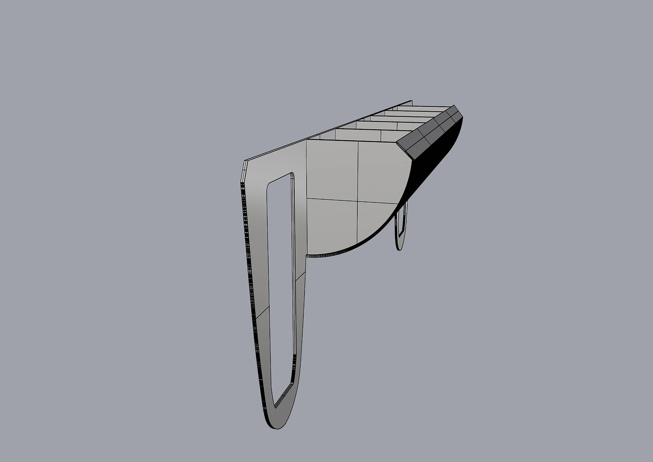

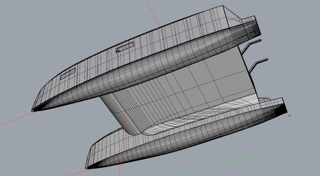

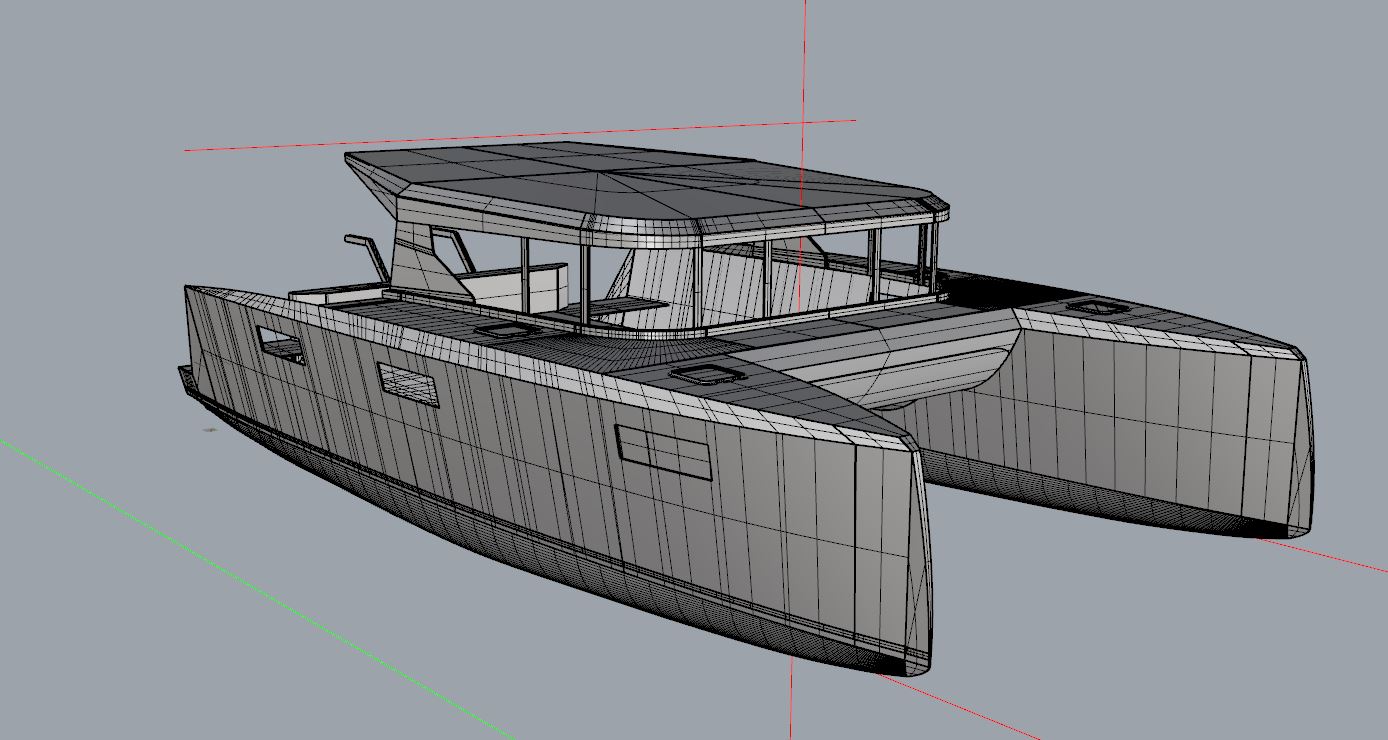

    After some corrections.
    I have made some corrections aft and forward.
