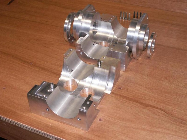

    Yes, I can't rule out that simple reed valves can do the job.
    The picture shows the crank-case of a flat 2 prototype. You can see the holes where we have mounted reed valves. 2 allowing the air into the crank-case, 2 connected with an air-box.
    Although the position and form of these valves were not ideal and piston/crank/connecting rod came from a stock engine, we had 1.8 bar air-box pressure.
    In a new prototype, new high speed reed valves are used and these are mounted, no longer in the center of he crank but just under the piston.
    The power needed to compress the air was 0.5 HP for a 600cc engine.

    Double power .. or half displacement .. or half the speed .. or a combination of a bit from all. (compared with a normal aspirated engine)
    Yes, a 'one' revolution pressure version ( as the drawing in the OP ) is theoretical able to deliver 1.8 bar if the engine is designed for it. We expect this to be 1.4 bar in the real world.
    If one-way valves are used, we can 'stock' the air from the 'lost' revolution in an air-box and in that case, the theoretical max. pressure is 2.2 bar – ( 1.8 bar expected in reality - volumetric efficiency up to 190%)
    We ran a 600 cc flat two prototype with an electric motor of 0.5 HP and we monitored a 1.8bar constant pressure in the air-box. This figure was used as ambient pressure indication in the Lotus Engine Engineering software and the gain in power was more than 20 HP.
    Must say that the engine did only 30% of his max. speed.
    I thing the engine need 10% max. of the extra power the crank deliver.
