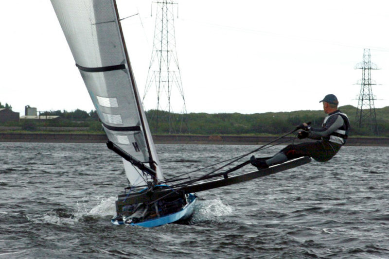

    Hiking board, sliding board designs; here is a famous one for you, Doug, thought you would have known all about them, you being fixated with wide leverage designs; this is International Canoe, originally designed in first half of last Century.
    There is also Jack Holt's Hornet from the 1950s, and going back way earlier, the 19th Century Chesapeake log Canoe - also there are the Bermudian open boats that have a number of crew perched out to windward on a long sliding board, still racing today. Plus ca change, eh?

    Corley epoxy coated
    The original (Cunningham designed?) Quick Cat had a hiking plank. I can recall one of my fathers friends had a beautifully built ply example which I admired greatly. To be honest the plank system looked pretty unwieldy compared to a trap harness.

    I've not been able to find any pictures but it was pretty low tech basically a plank that protruded from the edge of the boat that you lay on. I cant recall how it was attached now even though I can picture the boat clearly in my mind.
    Carbon fibre would be a natural fit to the building a hiking plank these days as it would be deflection driven part and you could save some weight there. The boat was lovely varnished ply with mahoghany trim and well executed joinery throughout.
