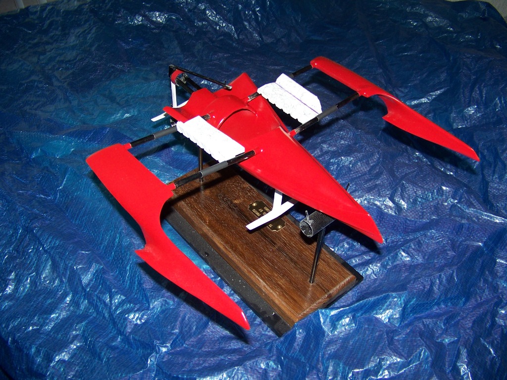

  7. Doug Lord
    Posts: 16,679
    Location: Cocoa, Florida
    Doug Lord Flight Ready
    The concept is a long way toward being proven already ,Gary. Way oversquare, three foils in the water,mainfoil unloads just before developing downforce which adds RM, planing amas, planing main hull, two different altitude control systems-both automatic, flys in a 5mph breeze, a bit more testing and shes ready to go fullsize:

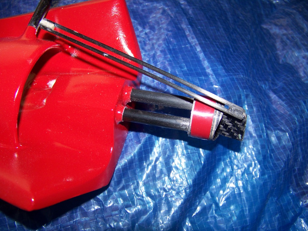

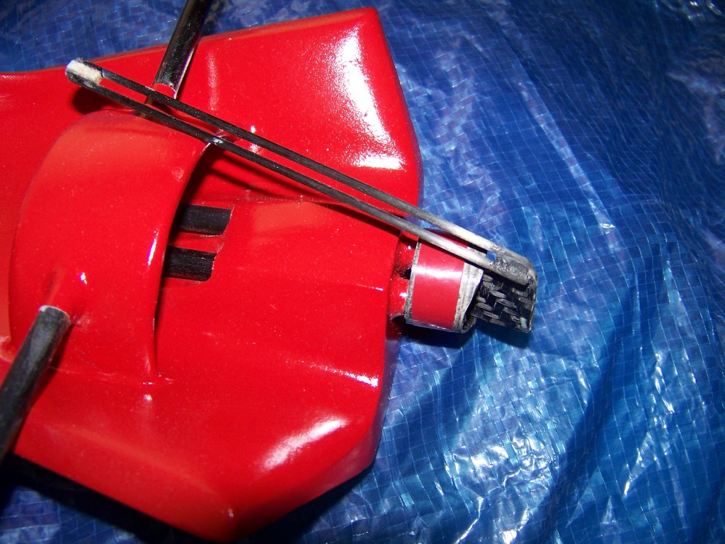

  11. Doug Lord
    Posts: 16,679
    Gonzo, in my examples above the tri(17' wide) was 140lb and the mono 90lb. I didn't know what you were referring to when you said "hiking boards"* so I used a 5' beam on a 12' dinghy with two guys standing on the gunnel on trapezes. Both examples were the same length with the same crew weight.
    * the only boat with two crew that I know of with anything like a "hiking board" is the Skate(LOA 14')-is that what you meant? For my example both boats were the same length with the same crew weight.

  13. Doug Lord
    Posts: 16,679
    Trimaran RM
    In diagram below:NOTE: the tremendous advantages of an oversquare platform plus the Fire Arrow foil system(with mainfoil downforce) can be configured to be way more than double the RM of this configuration!No way any monohull could even come close to the maximum possible Righting Moment!)
    A) Boat CG to center of lift of lee ama foil=8'. Boat weight(140lb) times 8'=
    1120ft.lb.
    B) Crew CG to center of lift of lee ama foil = 10'. Crew weight(350lb) times 10' =3500ft.lb.
    TOTAL TRIMARAN RM= 4620ft.lb
    Concept Test Model(Fire Arrow)--illustrates foil layout:
