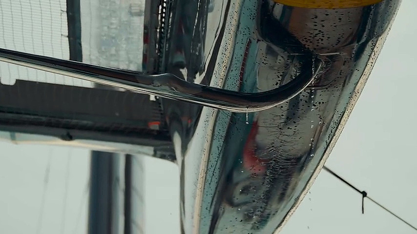

    That Oracle video was an abysmal and beyond embarrassing sort of 1950's Soviet newsreel propaganda.
    However the leading edge foil bump is sort of interesting amongst all the cringeworthy defecation.
    Seeing there was zero humour, just smiley faces and vacuous BS, maybe the bump is the real deal, and not a joke plant (although it appears a last minute addition) to play on the minds of the uninitiated?

    Thanks! I've seen some of his work and/or copies-for instance on one of the new IMOCA boats rudders.(see PRB rudder below below) But I have never seen just a single tubercle used on a foil until that Oracle video?
    click for better view:

    A single tubercle ist only to be used on very fast boats to limit a cavitation bubble in speeds over 35kn.

    Thanks, Manfred-do you have a link that discusses a single tubercle for that application?

    German "YACHT" Nr. 6: [​IMG]
    The tubercle has to avoid the sudden and total loss of lift at the foil.

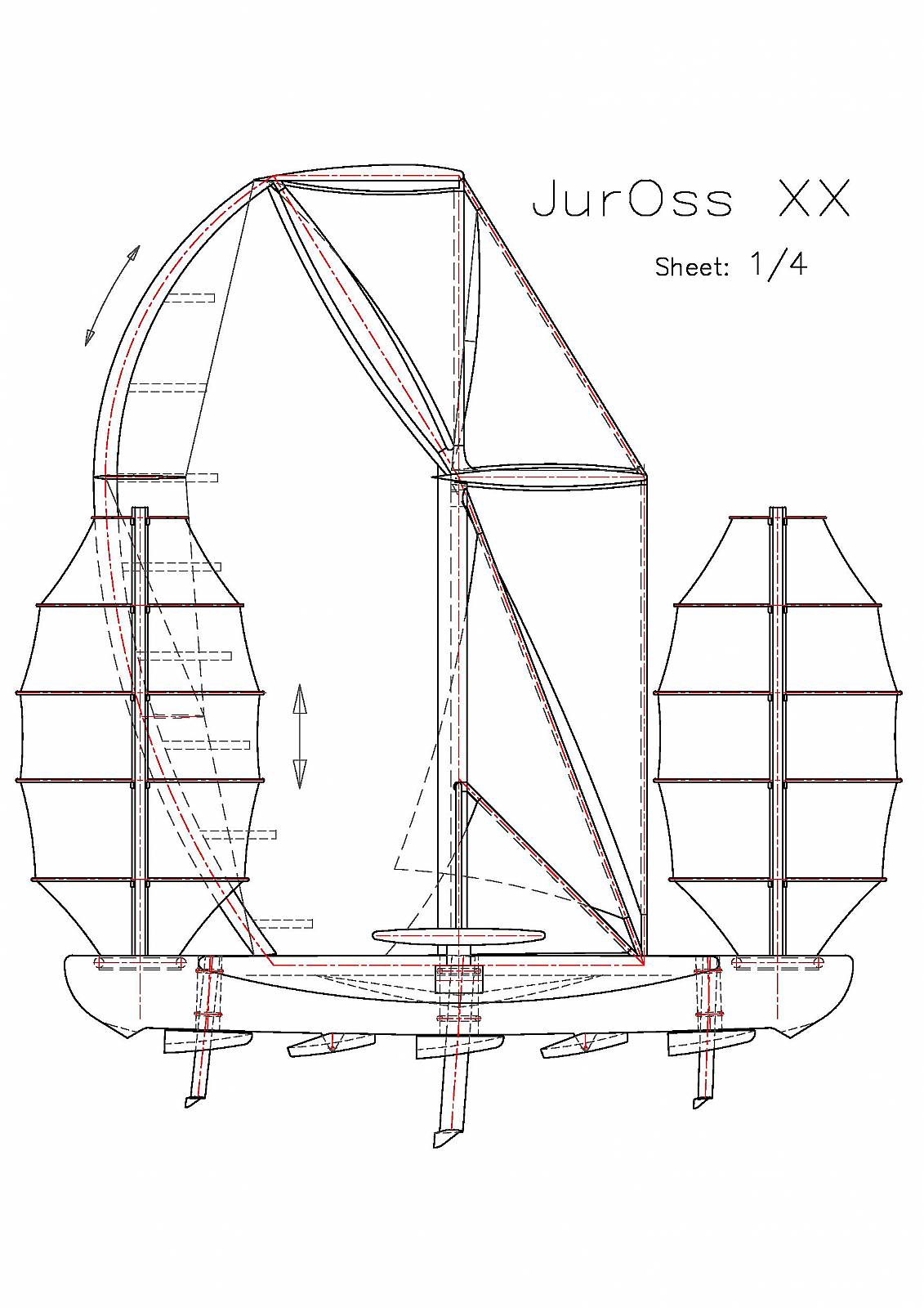

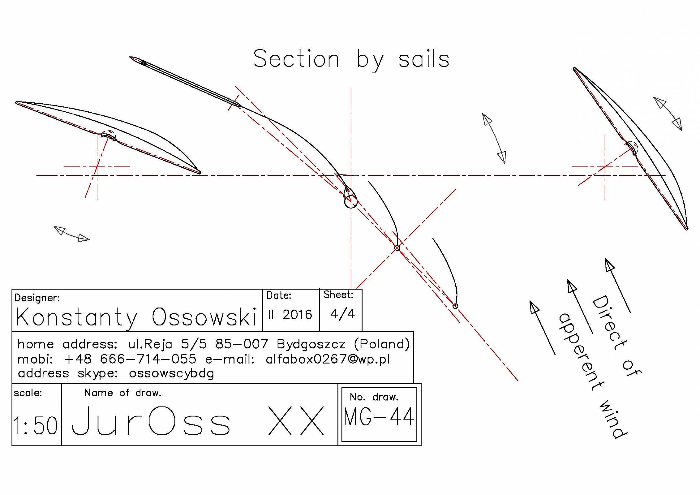

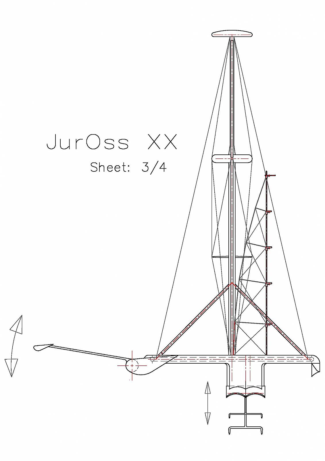

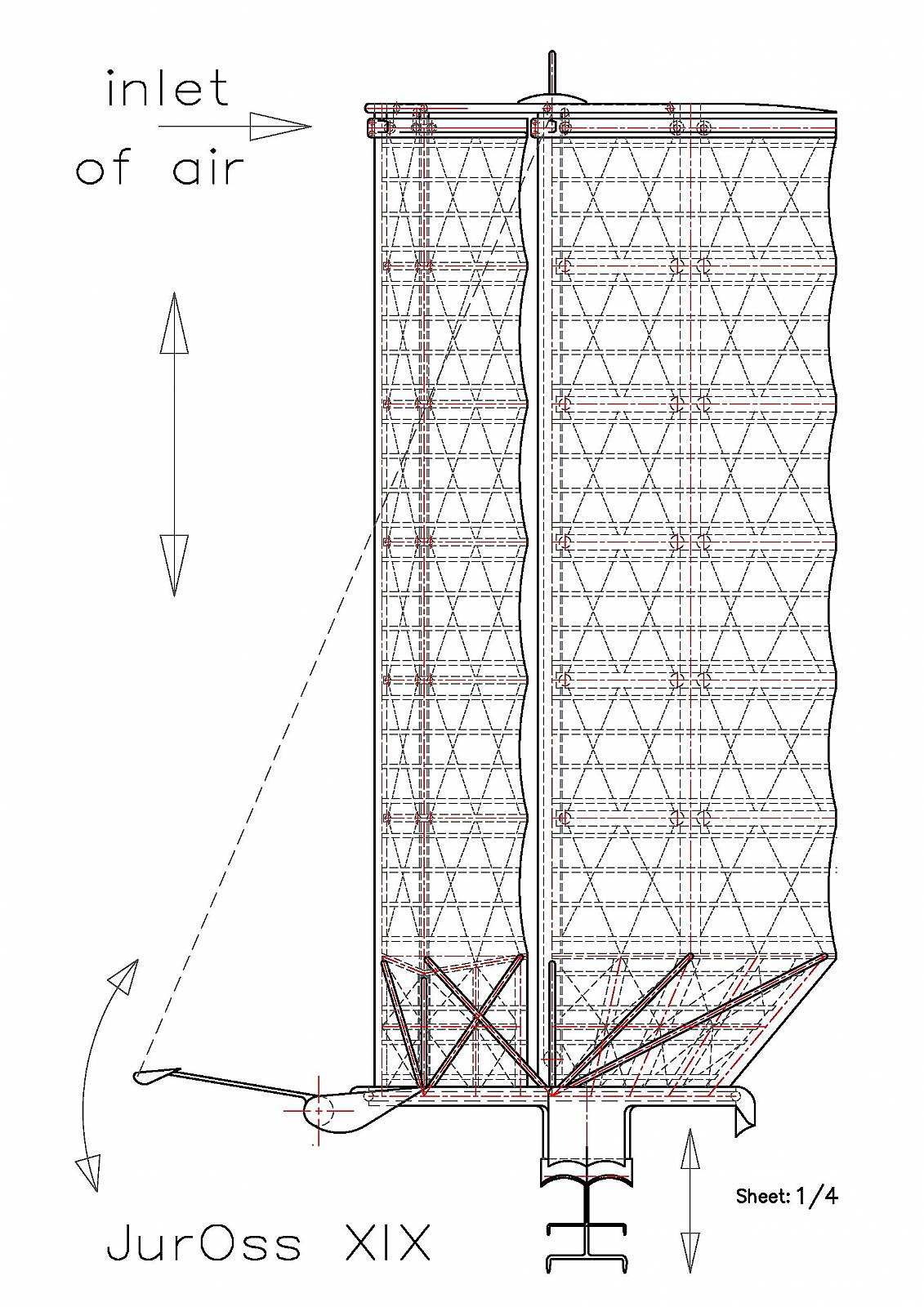

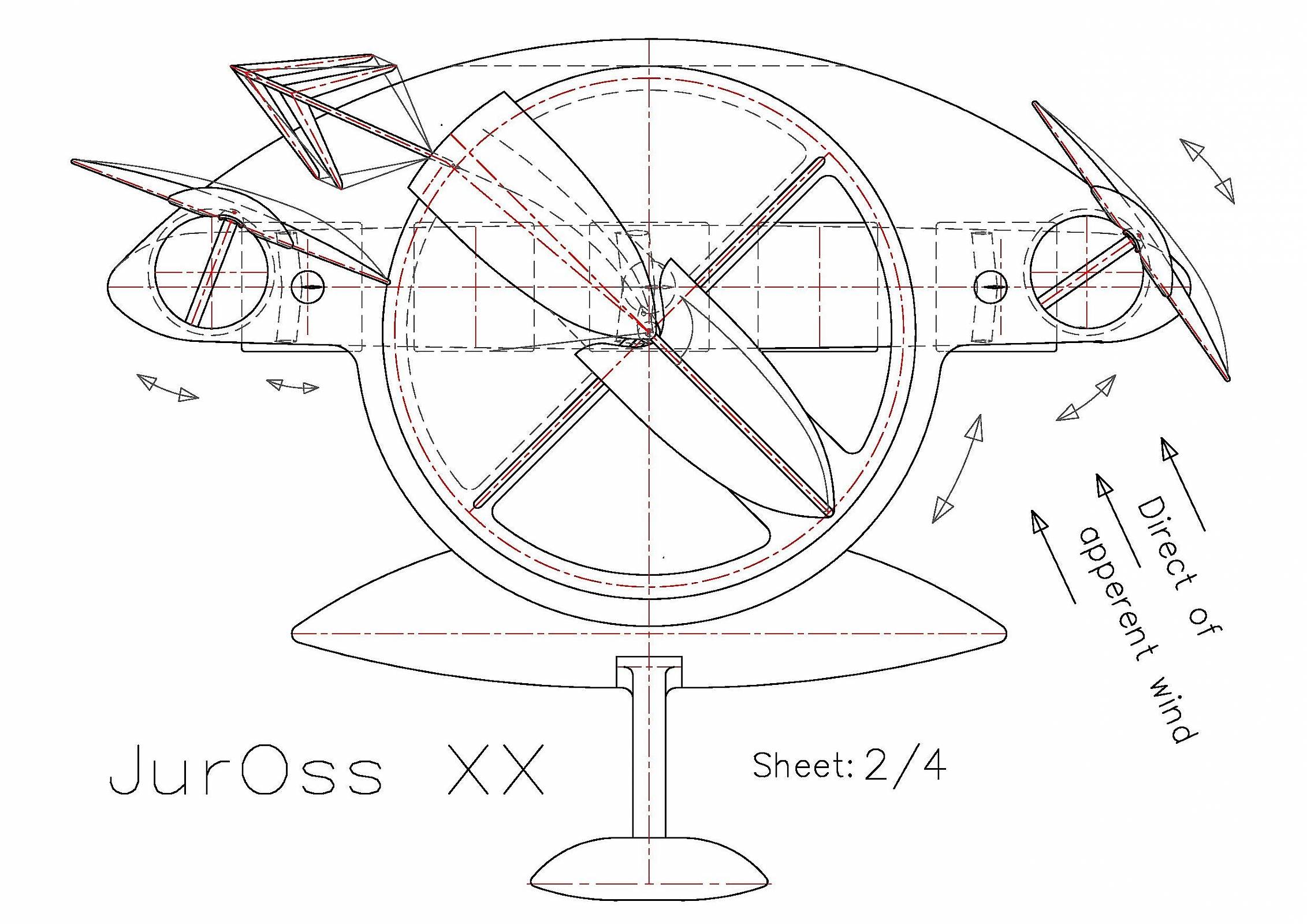

  12. Konstanty
    Joined: Mar 2016
    Posts: 95
    Likes: 4, Points: 8, Legacy Rep: 10
    Location: Bydgoszcz Poland
    Konstanty Junior Member

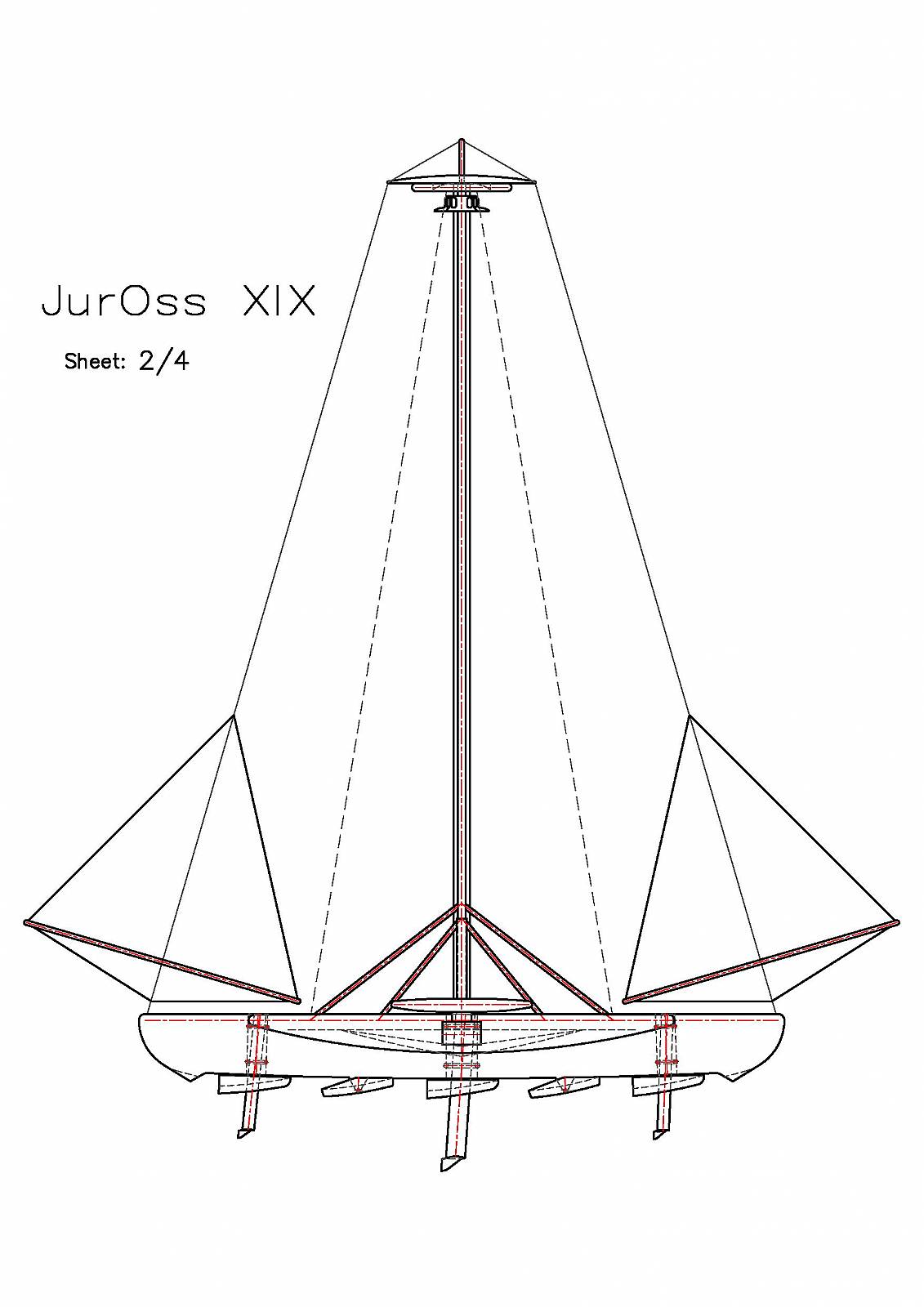

    For the show better would be if the boats could sailing in all power of the wind. It should be possible reefing sails. I have some drawings for planing and foiling proa with canting (flying) keel and reefing soft wingsail:
