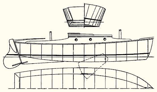

    I thought I would add this picture of a Akin sharpie. John Atkin knew the type very well, and here he has designed a cruising one . You could debate that it is more of a large skiff , but a sharpie is just that.
    http://www.boat-links.com/Atkinco/Sail/Matty.html

    Chapelle has a double-ended 30' cruising sharpie in his Boatbuilding book. Unlike Monroe's Egret or the working sharpies, both ends are roughly on the waterline at the chines.
    It has practical, if somewhat spartan, accommodations for a cruiser. I'll be referring to it while I design mine. But I guarantee one thing: the head will not be a bucket at the forward end of the cabin between berths, open to the cabin.....I'll do a portable toilet that can be carried ashore and dumped, and provide a private cubicle to one side of the companionway.
    Chapelle's cruiser sharpie also incorporates what he called a "Dutch galley." A kerosene stove and a sink are built into a portable box, with a couple of drawers under the sink. The part with the stove is metal lined and insulated, of course. When the galley is in use the lid folds up, and wings fold out to create counter space. The sink drain has a flexible hose that clips to the side of the box; you drop the end into a bucket and drain the sink after you're done with it. When not in use, the box gets stashed on a shelf.
    It is tempting to think I might be able to come up with something similar that sets on a chart table when in use, and stashes out of the way the rest of the time....of course, mine would probably have a stainless-steel bar sink and a small propane stove.
    If I have time at work tonight, I'll scan Chapelle's drawings and post them. They're the only detailed representations I've seen of a cruising sharpie from 'back in the day.'

    I have seen plans for for the Chapelles double ended sharpie , Brewers Mystic
    is very similar . I like the look of Chapelles better . Not having the flair of egret , it will be faster and handle better, IMO . Very cool boat .
    If I were going to do it I think I would add a shallow box keel to hold the ballast and move the center board out to the side a little .

    I had temporarily forgotten about the Mystic Sharpie; I'll have to compare Woodenboat's study plan for it to Chapelle's double-ender tonight. But now that you've mentioned it, the one was probably the inspiration for the other.

    I owned a 34' version that Chapelle did. They are very fast off the wind, even planing. Upwind they are fair. I was very pleased with that boat.
