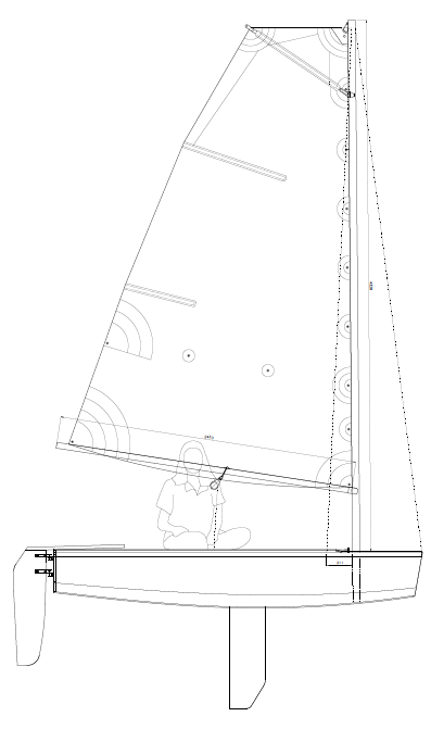

    Boat is more than interesting. Looks good too. Have some of the smaller bits and pieces been 3D printed?
    The boat is merely good looking and very well done, the backgrounds in the pictures are spectacular.
  2. Sebastian De La Maza
    Joined: Feb 2024
    Posts: 16
    Likes: 23, Points: 3
    Location: Chile
    Sebastian De La Maza Junior Member
    No 3d printed parts, all machined from different thickness pieces of plastic and then welded together.
    I am looking forward to acquire a semi industrial 3d printer to make some interesting parts but so far it´s all machined in a very basic cnc router and a little bit of laser cut for stainless steel parts.

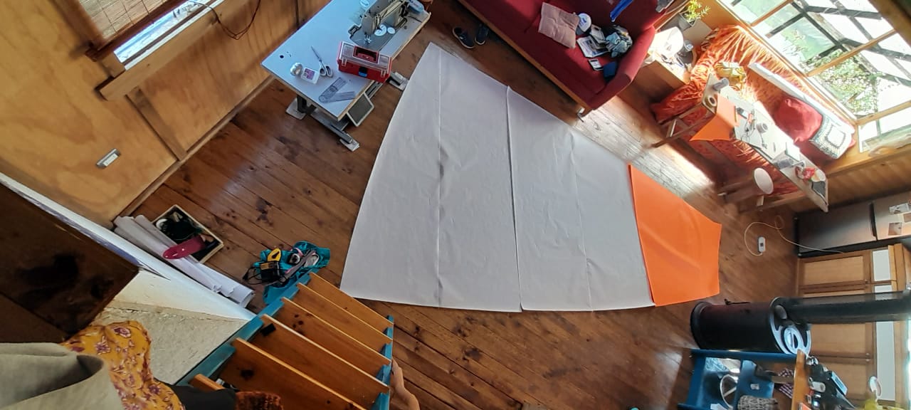

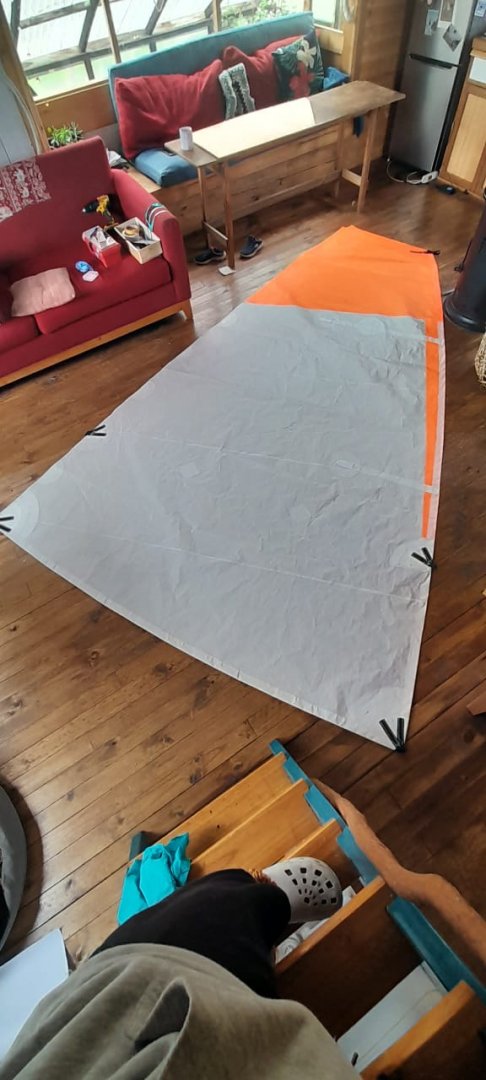

  5. Sebastian De La Maza
    Joined: Feb 2024
    Posts: 16
    Location: Chile
    Some update on the sail
