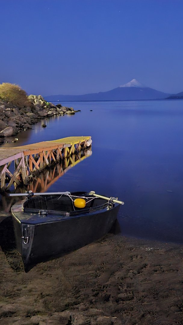

    boat is almost done 20250410_185350.jpg 20250410_204708.jpg 20250410_204722.jpg

    Lake trials are done, the boat handles very well for a newbie like myself, there´s some minor tweaks to be done but i am really happy with the result.
    The boat fits in my pickup truck and i can load and unload without any help, only some rope and a good old squat.
    Now i have to finish all the sailing related parts, mast, boom, sail and rudder.
    I have been watching a lot of Roger Barnes videos on youtube and picturing it as a cruising dinghy, fully equipped for adventures so there´s definitely a lot of gear to fabricate to come.
    Pictures taken at Llanquihue lake, Chile.

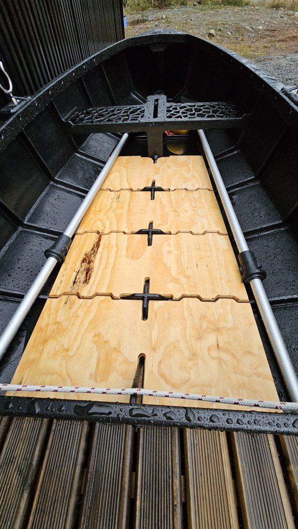

    I'm a bit curious about whether the thwart wound up that shape due to topological optimisation or was it just an artistic whim?
  12. Sebastian De La Maza
    Joined: Feb 2024
    Posts: 16
    Likes: 23, Points: 3
    Location: Chile
    Sebastian De La Maza Junior Member
    it´s called Voronoi pattern, i did it to reduce a little bit of weight and of course to make it look interesting.

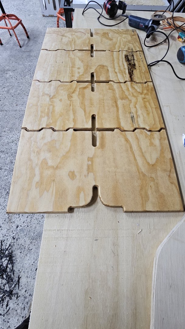

    Working on a design for the floor.
    18mm plywood
